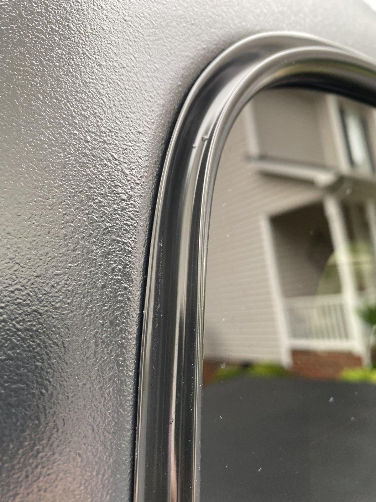

The part where you said they replaced the top and that one leaked, too, is a bit worrisome to me. I've wondered for awhile if the problem is not just the glass but the seam on the hardtop where the vertical part of the top meets the horizontal part. I recently bought five feet of 5/8" drip rail molding that I installed to cover the gap between the hardtop and the window along the entire horizontal portion and partially down the sides. Pic:
Jeep Gladiator Roof leak in back IMG_3416
Theoretically this should have at least slowed down the leak. Even if it was only 50% sealed the water would have come in much slower. But the first time it rained I went into the back seat and, sure enough, the water was coming in just as fast as it was without the molding. I won't know for sure if the top is a problem until my glass gets replaced (latest ETA is 9/17), but I will update the first time it rains after the new glass is installed. Best of luck to everyone dealing with this issue!
