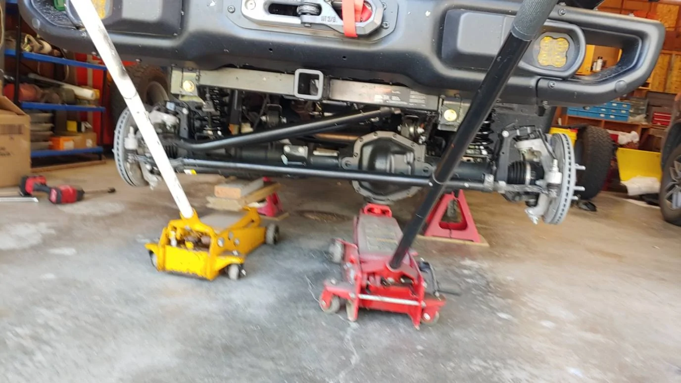

Your informative response sounds like you think I can do this in my driveway. Is it possible to put on springs in the driveway? Do I need jackstands? Special tools like a spring compressor? Hydraulic 3- ton harbor freight jack? What kinda torque in this operation? Am I gonna end up buying a wrench set too? Already bought a socket set and a 13-mm wrench for the sway bar or stabilizer disconnect prior to off-roading (one of gvsukids’ posse showed me how).

1 floor jack, 2 jack stands, and 2 wrenches. Very doable in your driveway.
Edit. Sorry, 4 wrenches. I forgot the sway bar end link and the brake line bracket.

As long as you have a secure flat spot for the jack stands to support the Jeep, and can roll a floor jack under there...... yea.
Safety first. Getting it done isn't as important as getting it done and coming out alive and with all 10 fingers.

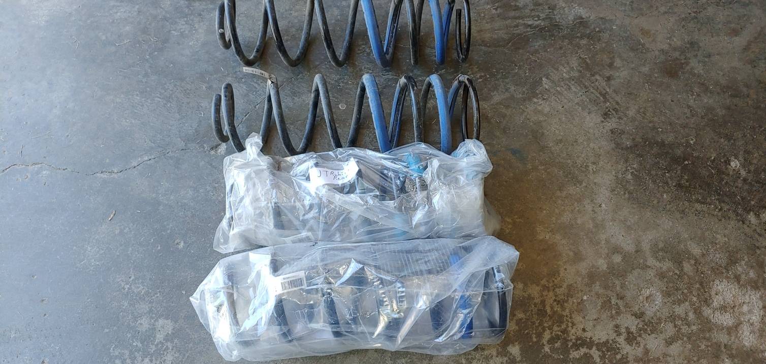

Like said above, you'll need two jack stands and two floor jacks to do it. Spring compressor not necessary. Have a roll of masking or electrical tape to keep the upper spring isolators in place (the rotational position of the springs DOES matter).

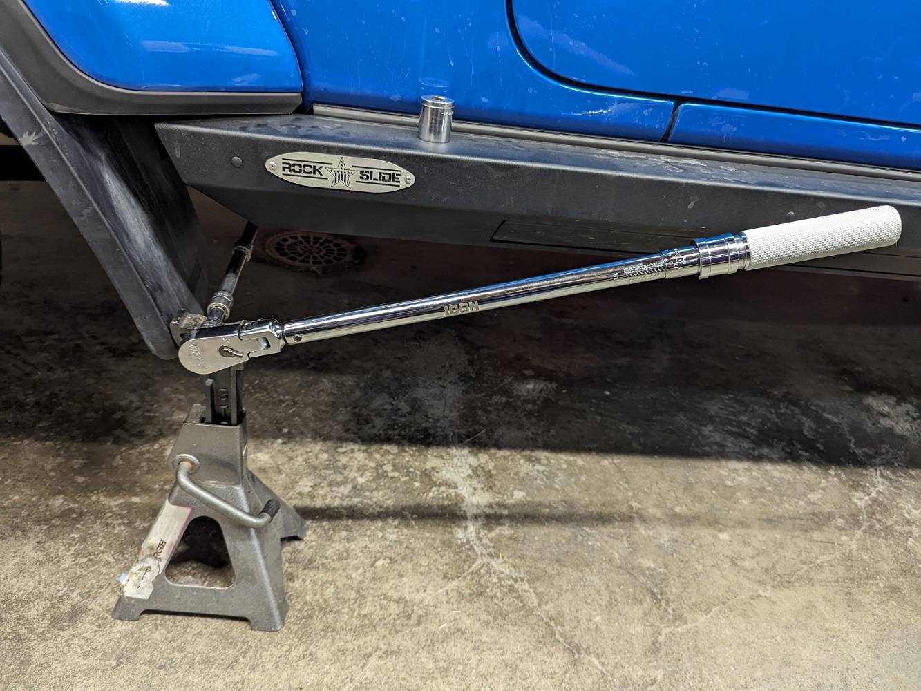

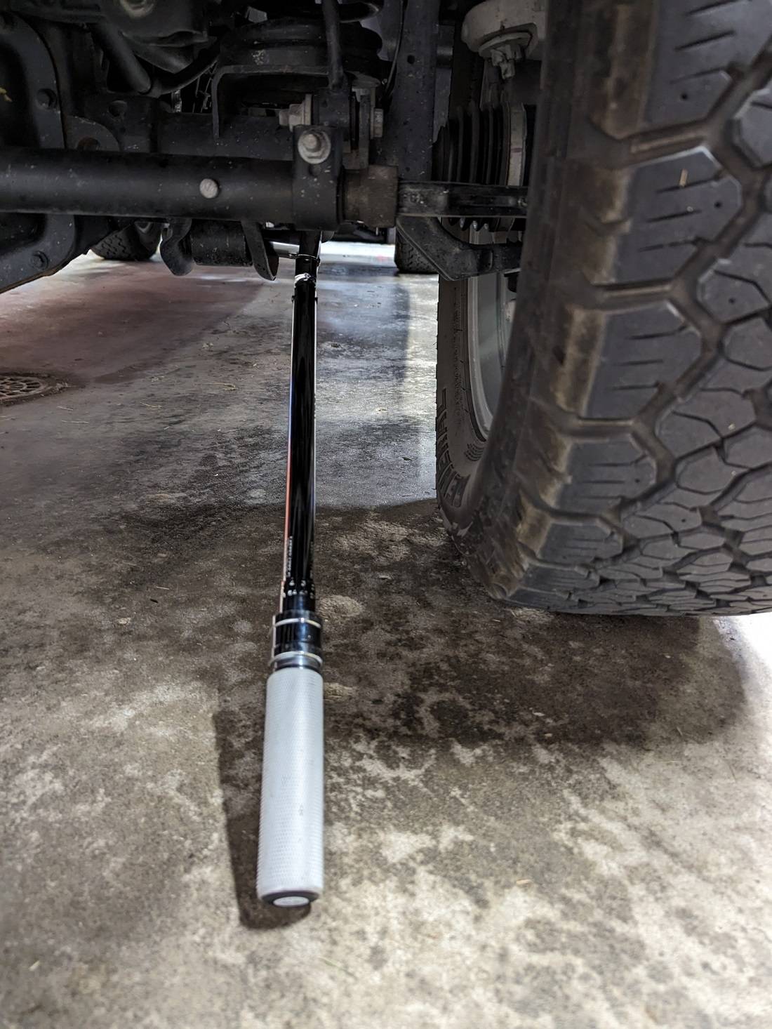

I use a Harbor Freight Icon 250 lb/ft torque wrench.
I like the Jack Stand trick there. How did you hold the other side of the fastener when you torqued it?
40,514
54,044
Box end wrench and allowed it to wedge up against body.
Sometimes the wrench is tricky to get back off, it took a time or two for me to figure the right place and wrench.
