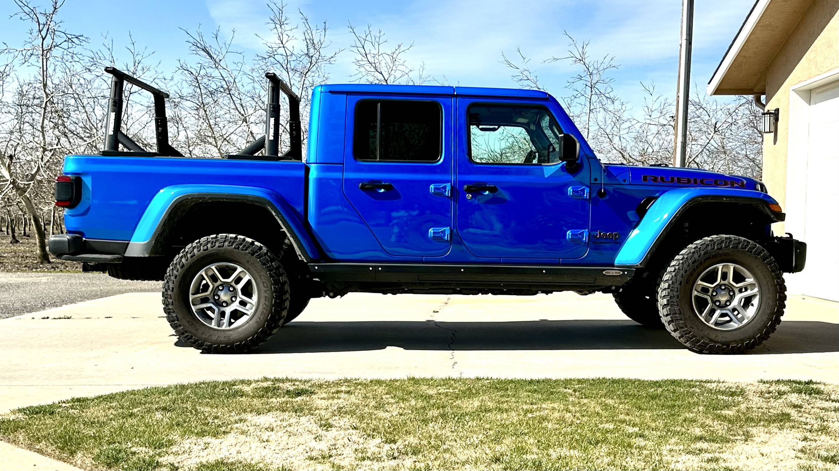

2021 JTR
2021 JTR
Rubicon steel front bumper
Zeon 10s winch
Clayton 2.5ā€ Overland+
Clayton 2.5ā€ HD rear springs
RSE side steps with armor
Yakima Overhaul rack
UWS tool box with 300 lbs of stupid stuff
The back of the side steps are 1.5ā€ higher than the front of the side steps when measured from the ground.
