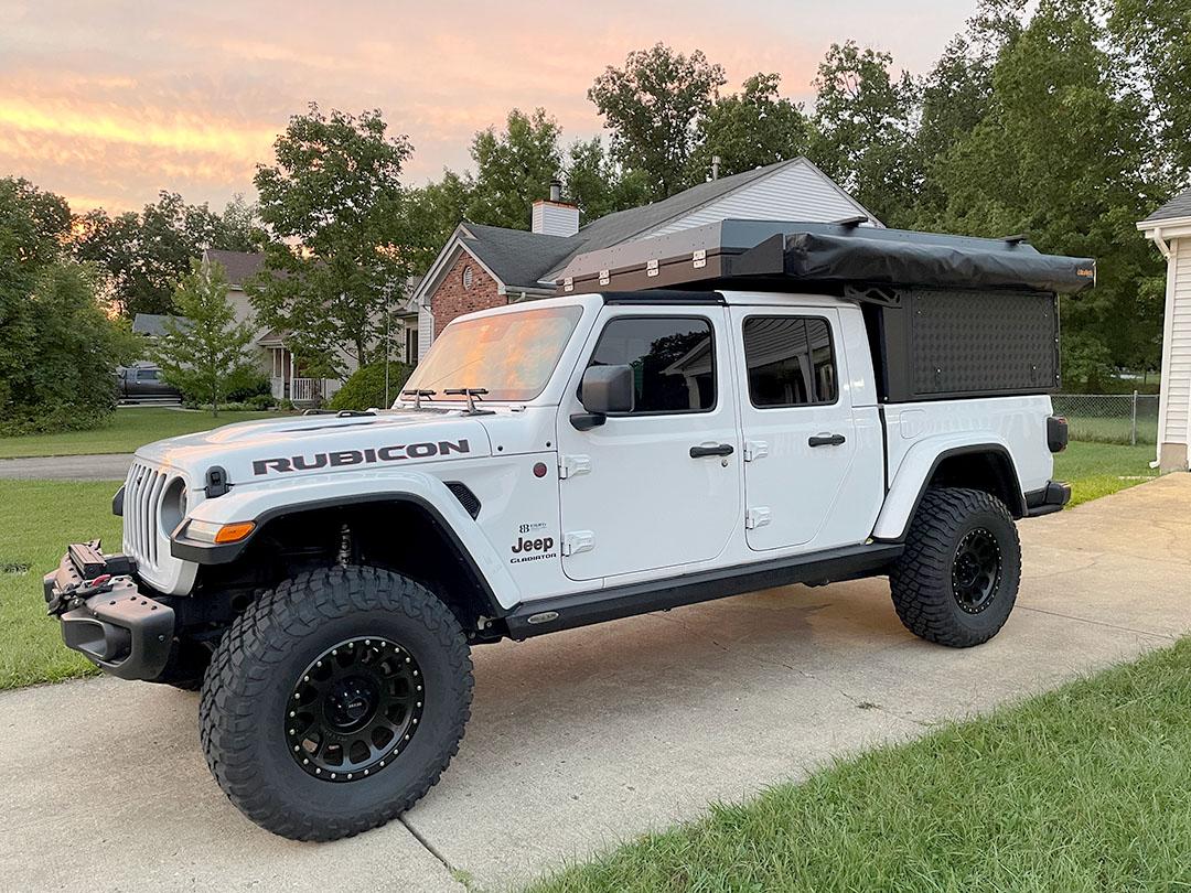

I never noticed much sag even with just the Mopar lift. I installed new shocks and springs and I still don't notice much. I think it looks great how it sits now. The photo below is with just the 2" Mopar lift, springs and shocks.

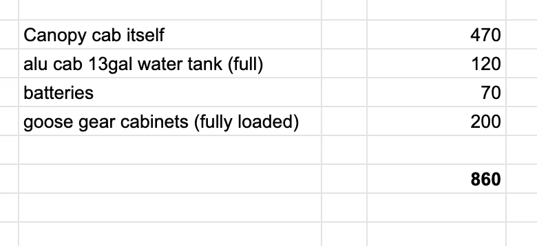

Following this thread closely as I am going to build out a JT with ACC soon. Looks like a static 800lbs+ on the rear so as far as I can tell the best-published option is AEVs 3" high capacity @ 700lbs top capability which still isn't enough but its more than Dobsons EXTRA HEAVY DUTY COIL SPRINGS top range they advertise @ 660 lbs.
Damn that thing weighs 470lbs? Glad I went with another option.
