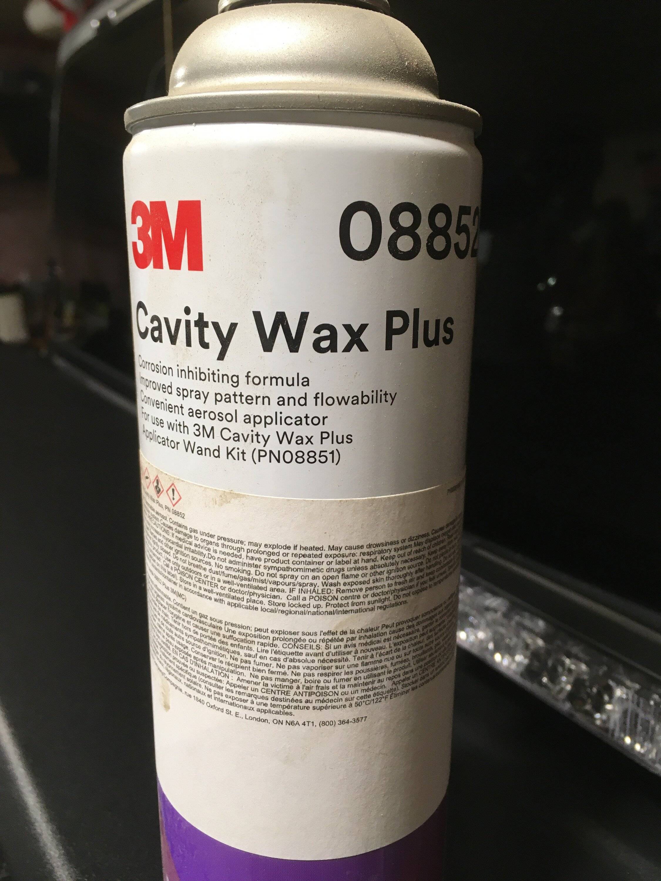

I had the dealership undercoat mine back in February 2021 before I drove it off the lot. I then used 3M Cavity Wax with the wand kit to reach all the internal spaces of the frame, doors and hood and then picked up CRC Marine Corrosion Inhibitor for all the other parts that doesn’t get undercoating. We have salt here used on the roads and the CRC wax spray has done an amazing job of keeping the rust at bay.
Still looks good!
