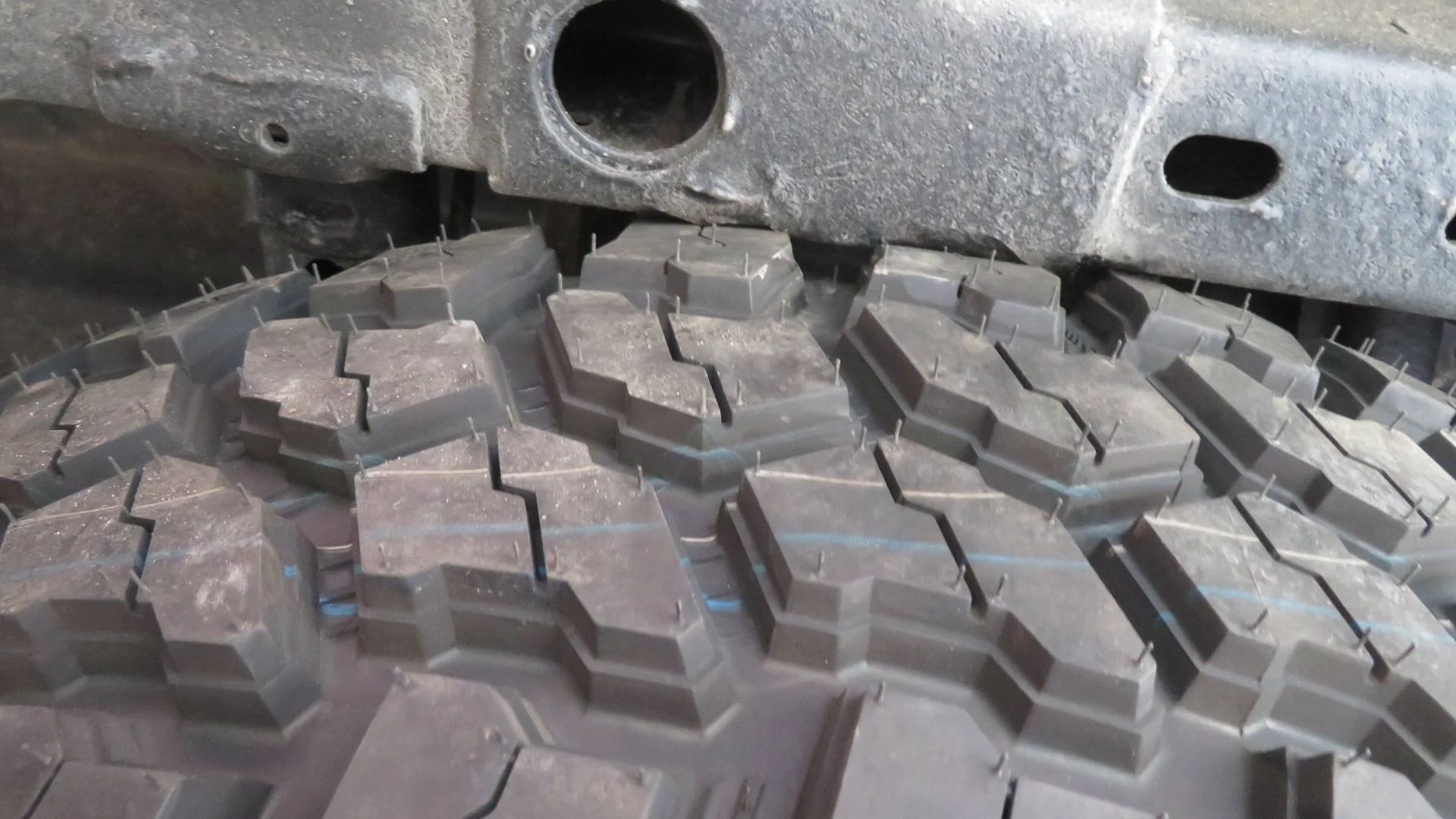

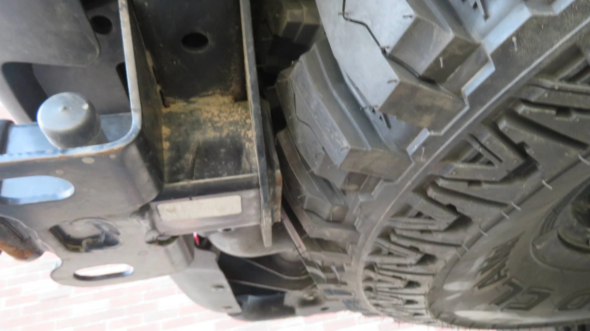

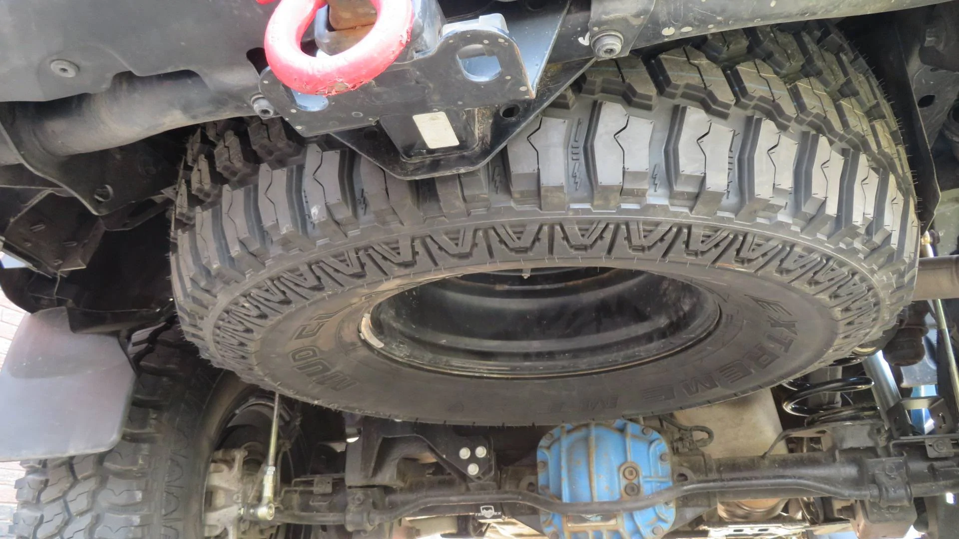

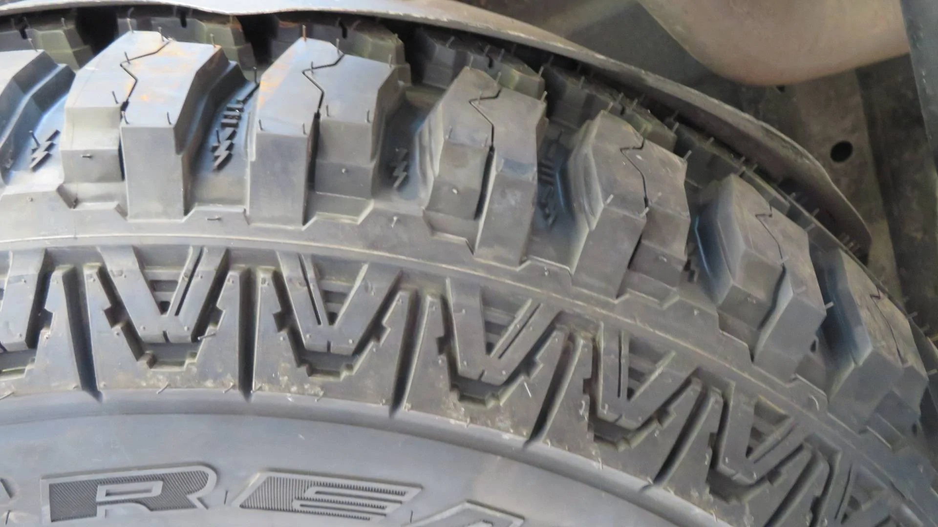

The 37" Eldorado Mud Claw fits under the bed as a spare tire. It's a tight fit.
12,238
32,585
Picture's of the spare tire with 40 psi in it. The top of the tire is sitting flush with the frame. No gaps.

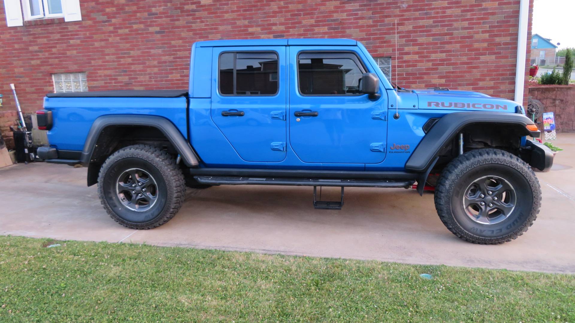

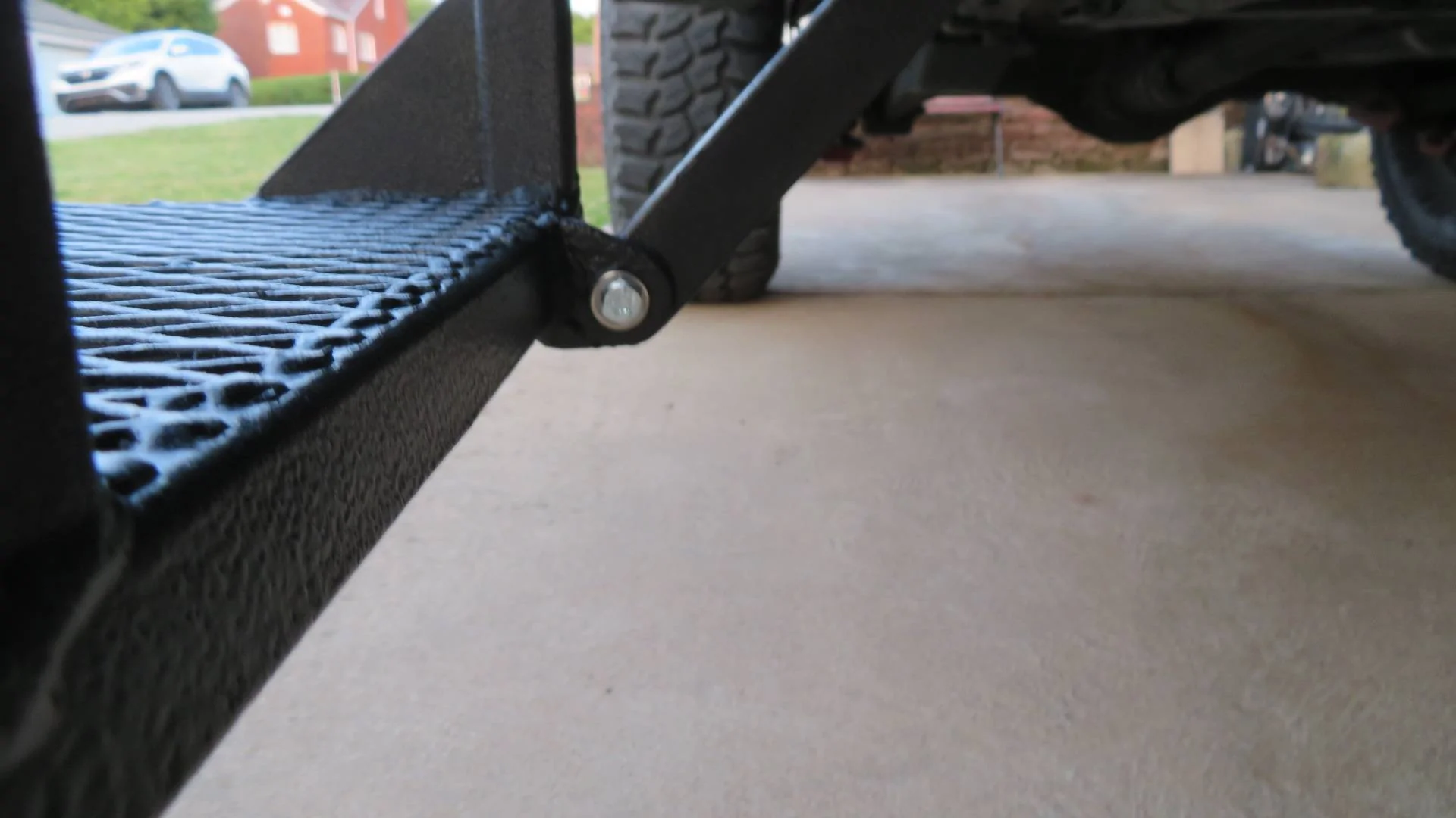

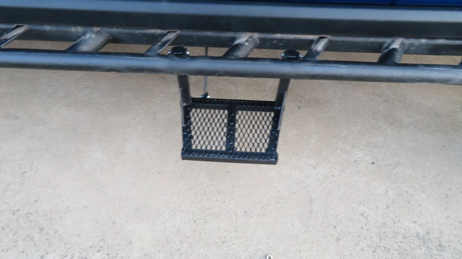

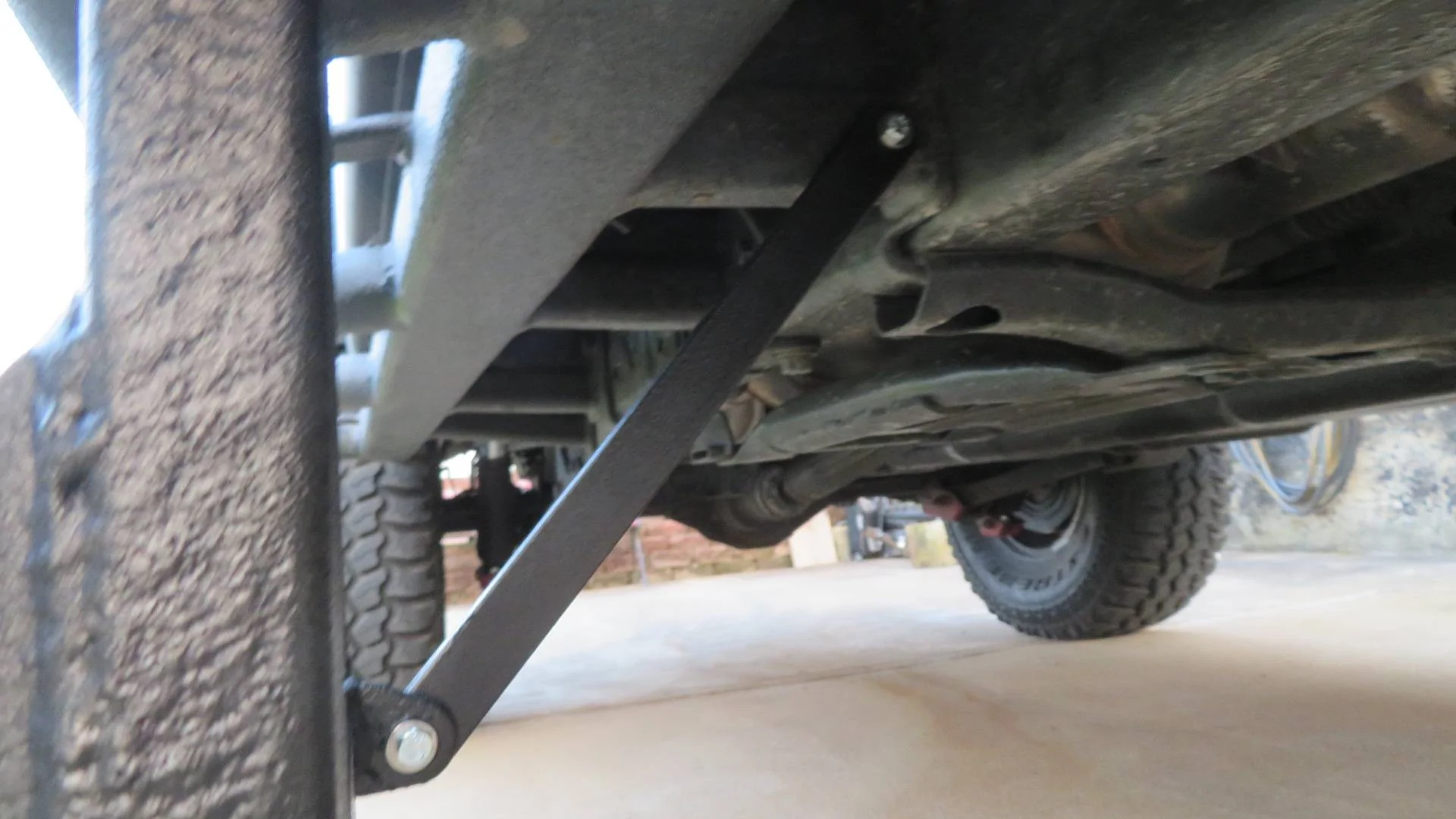

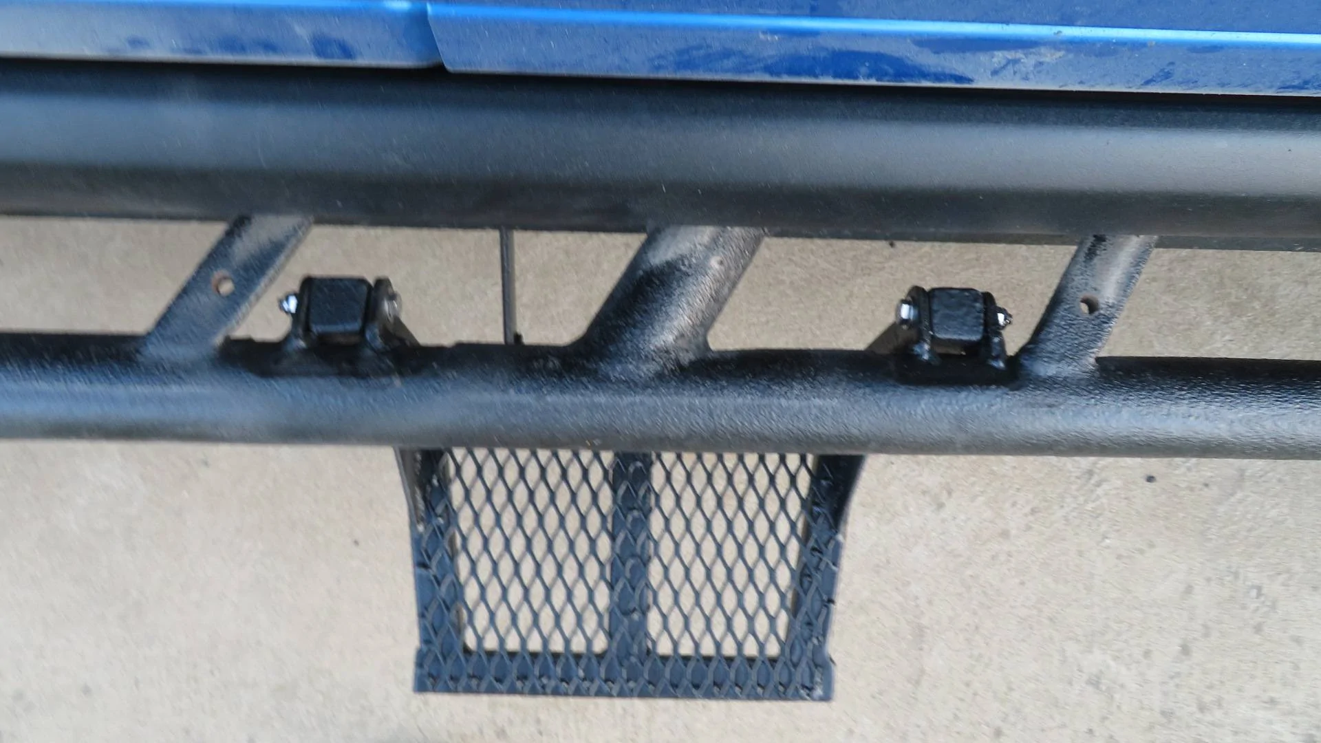

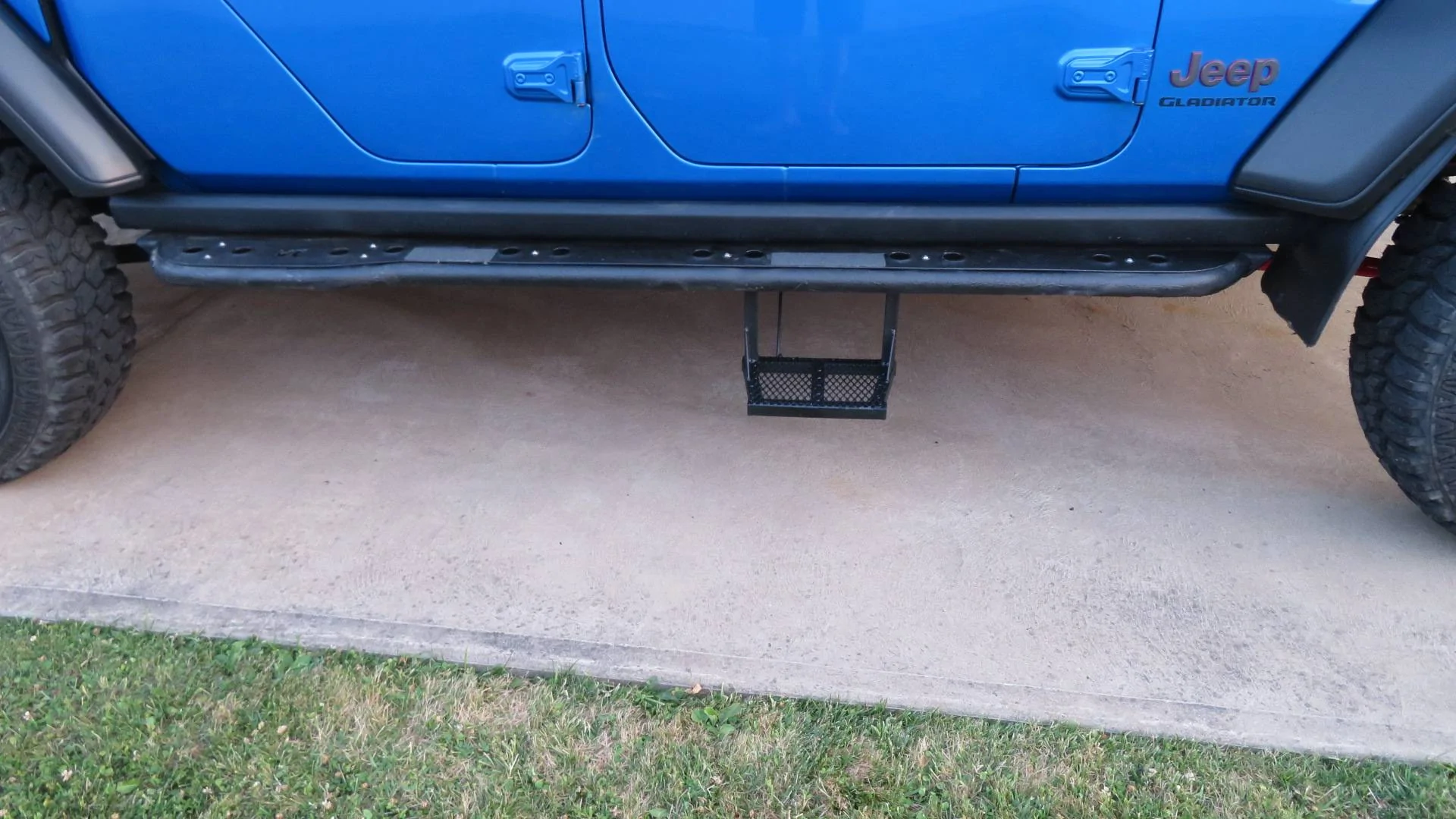

Because the wifey has Parkinson's, plus just having foot surgery. I had to make a set of steps that bolt on to the White Knuckle rock rails. If I go 4 wheeling. I can remove them easily. Wanted to use round tubing. But couldn't find anyone to bend it. All of my friends that I have connections with are retiring. So...I had to go with square tubing.

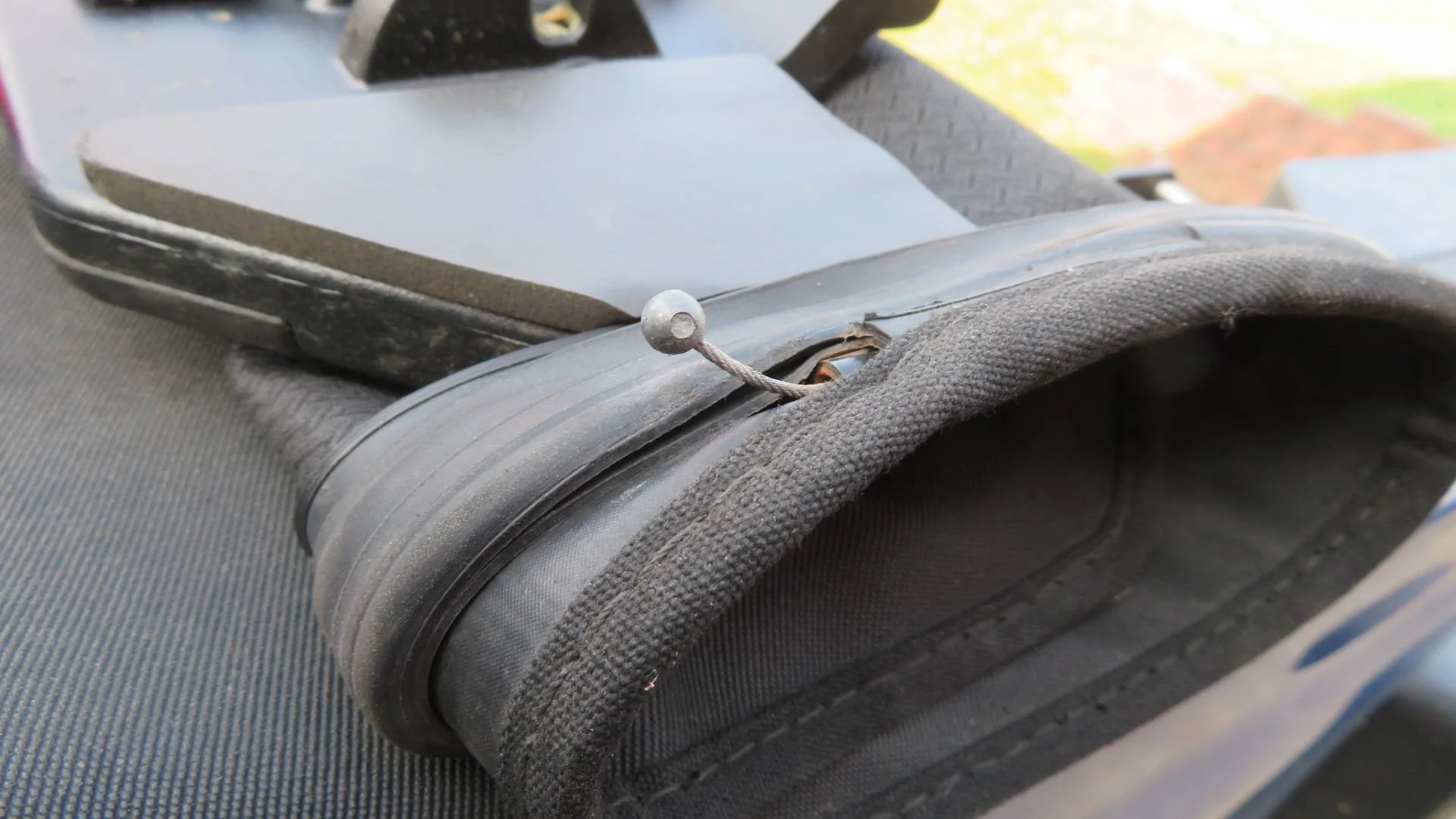

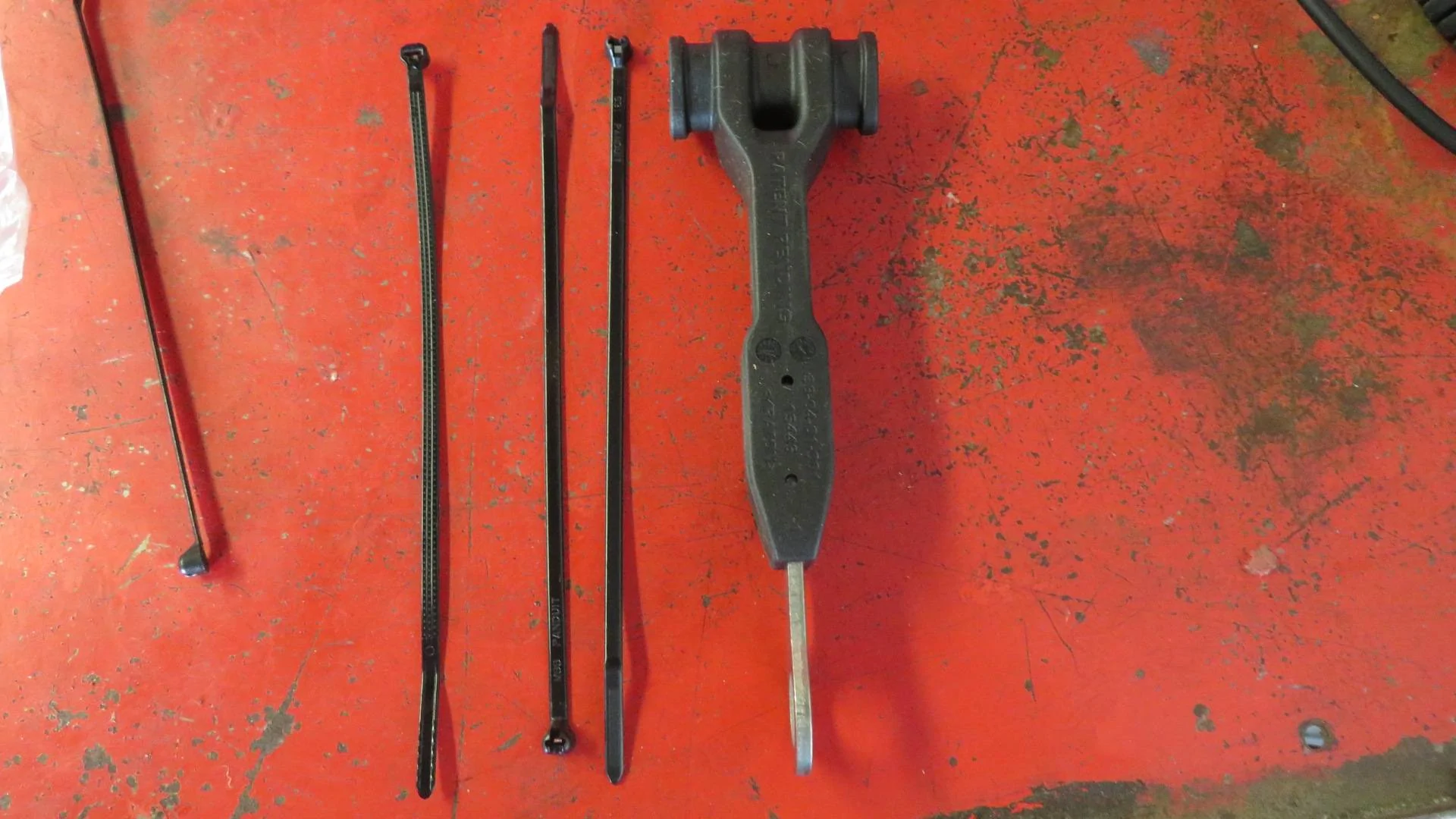

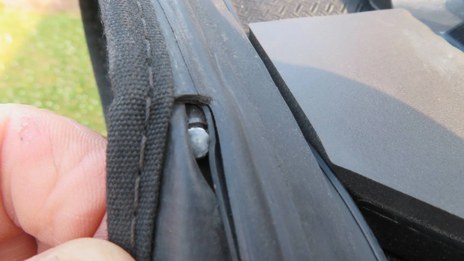

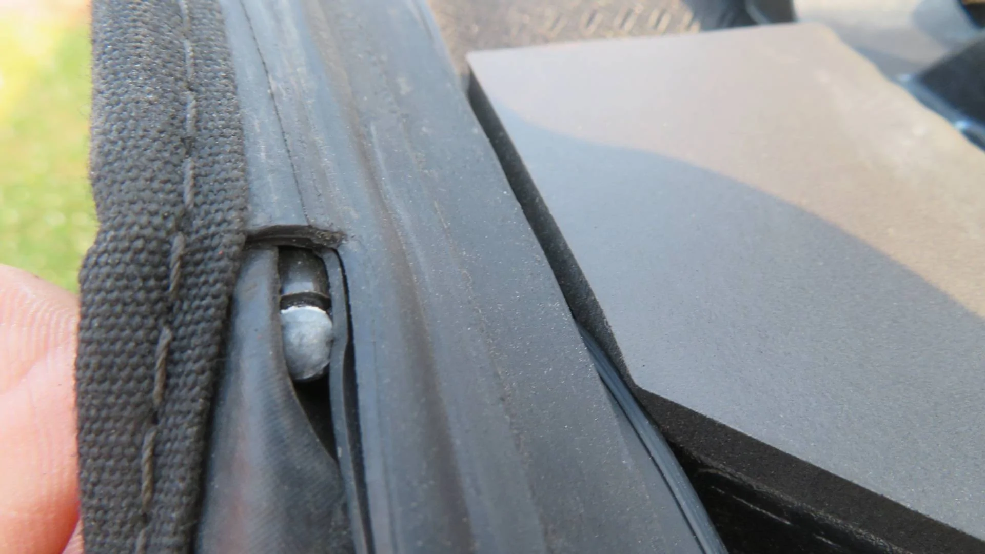

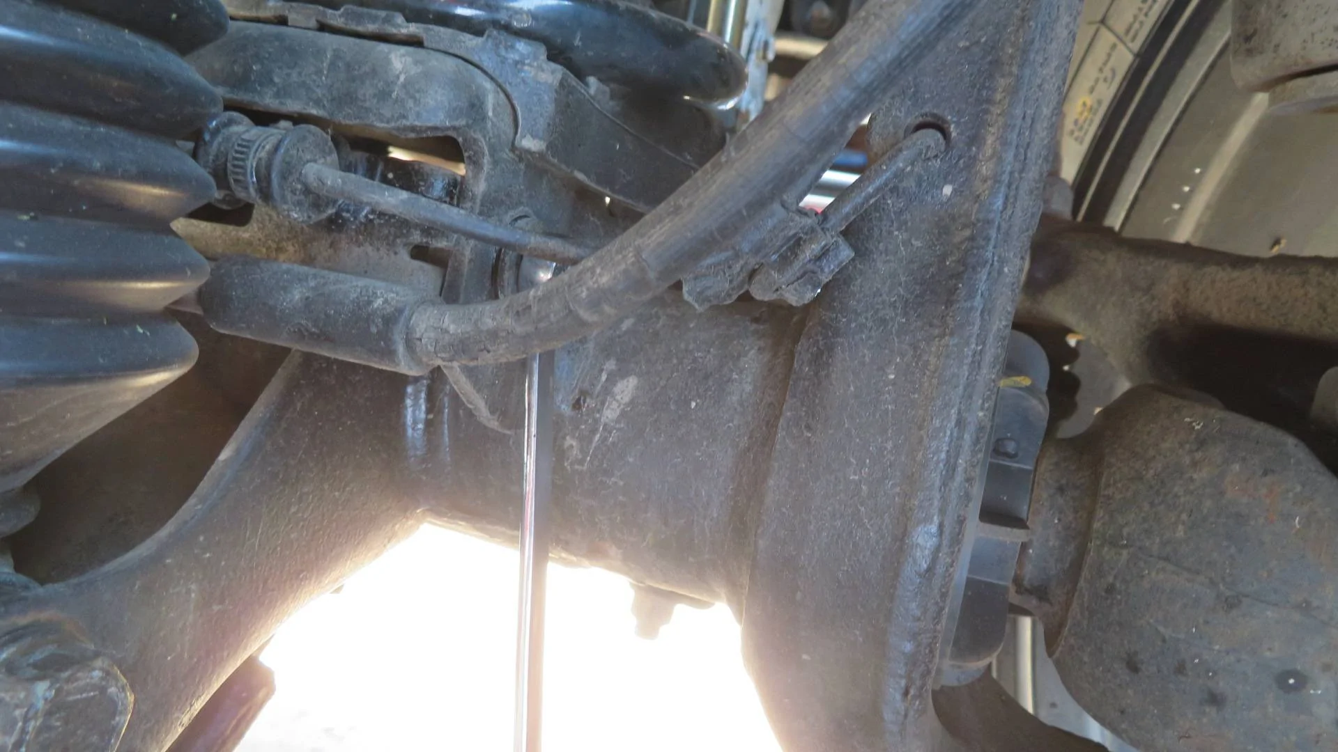

Getting my factory soft tonneau cover replaced under warranty tomorrow. On the left side, the cable seems like it broke and is allowing the cover to become loose.
The 1st pic, you can see where to cable is pulled out. The 2nd and 3ed pic's os of the right side. Where it's still tight.

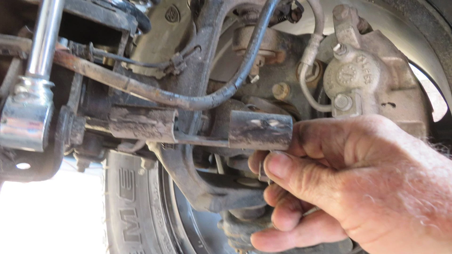

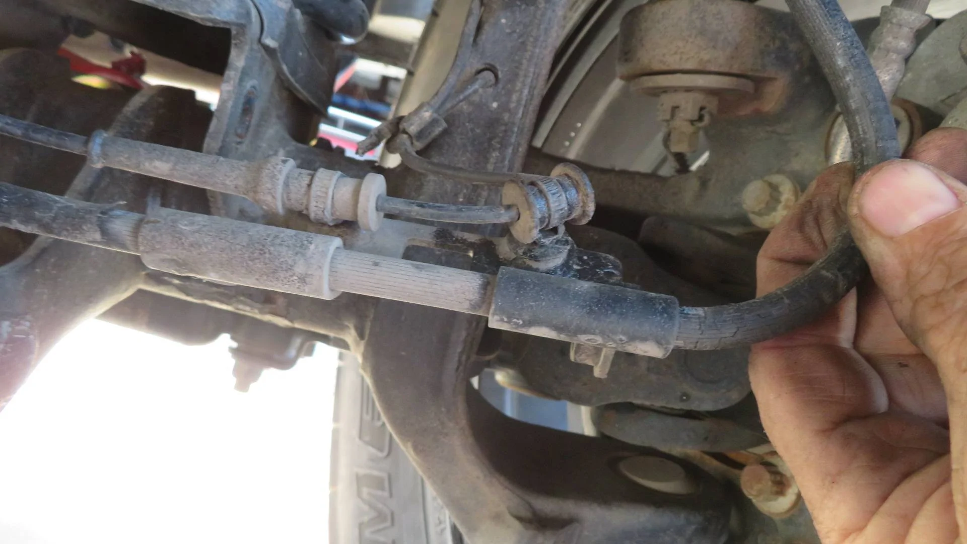

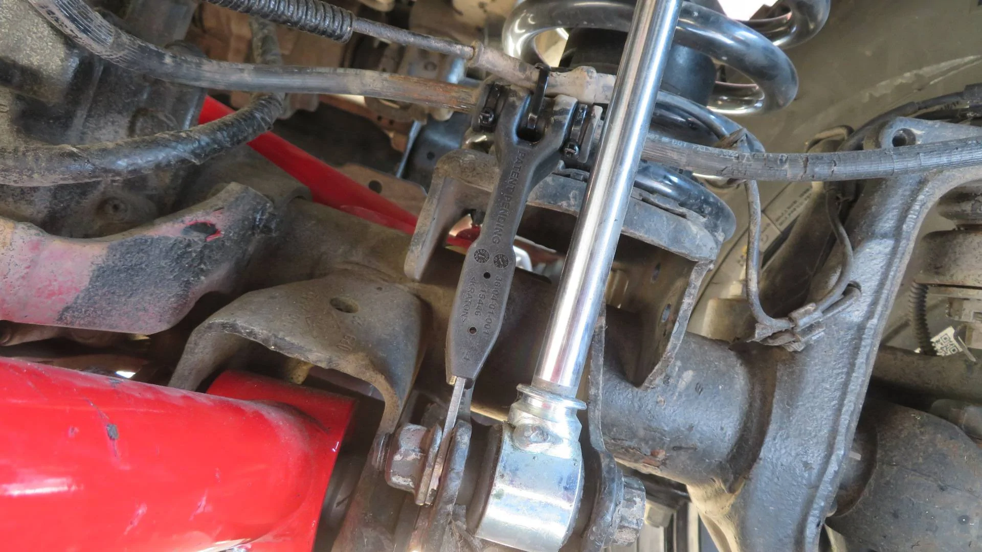

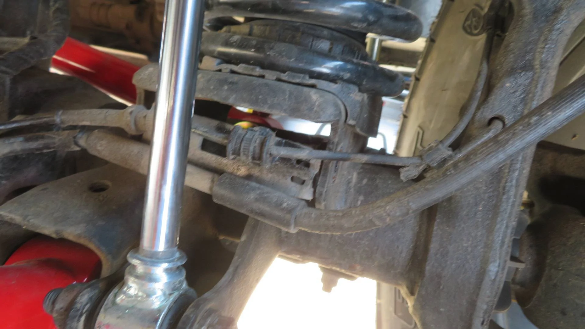

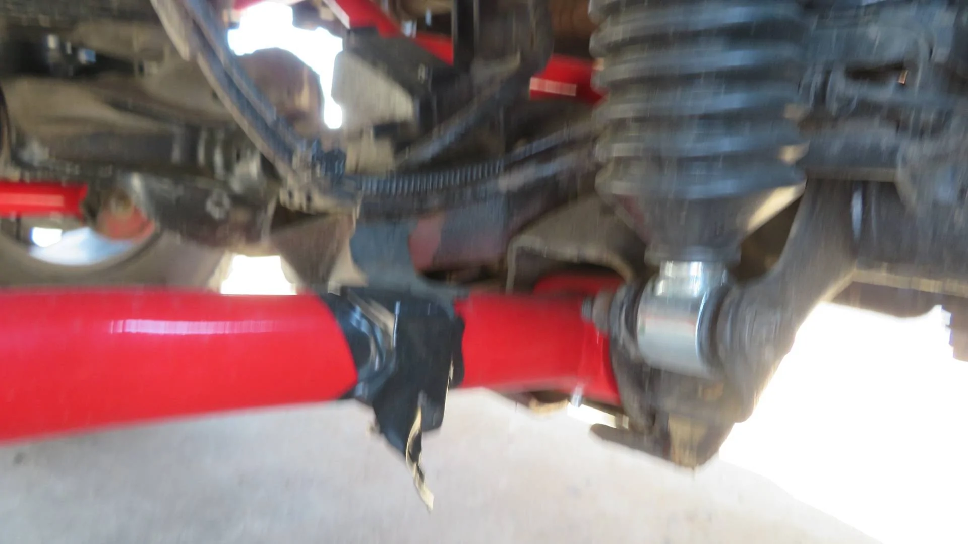

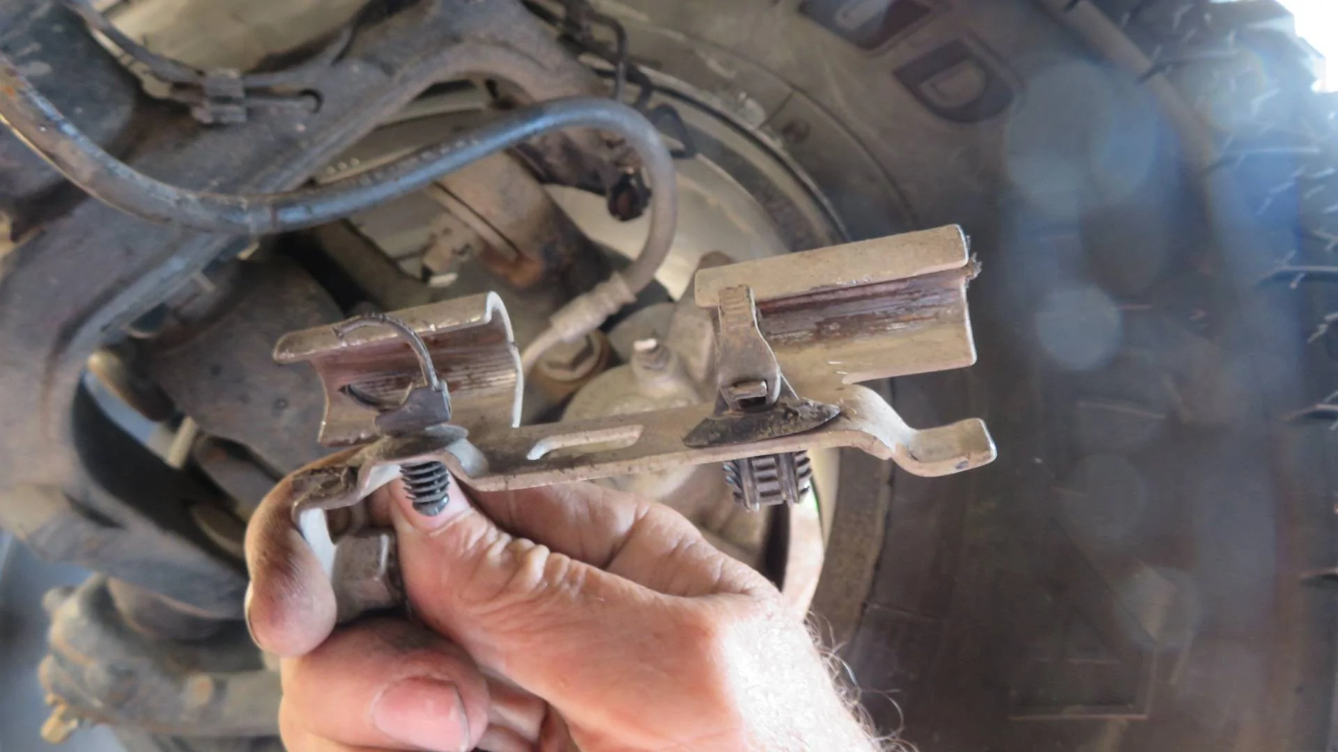

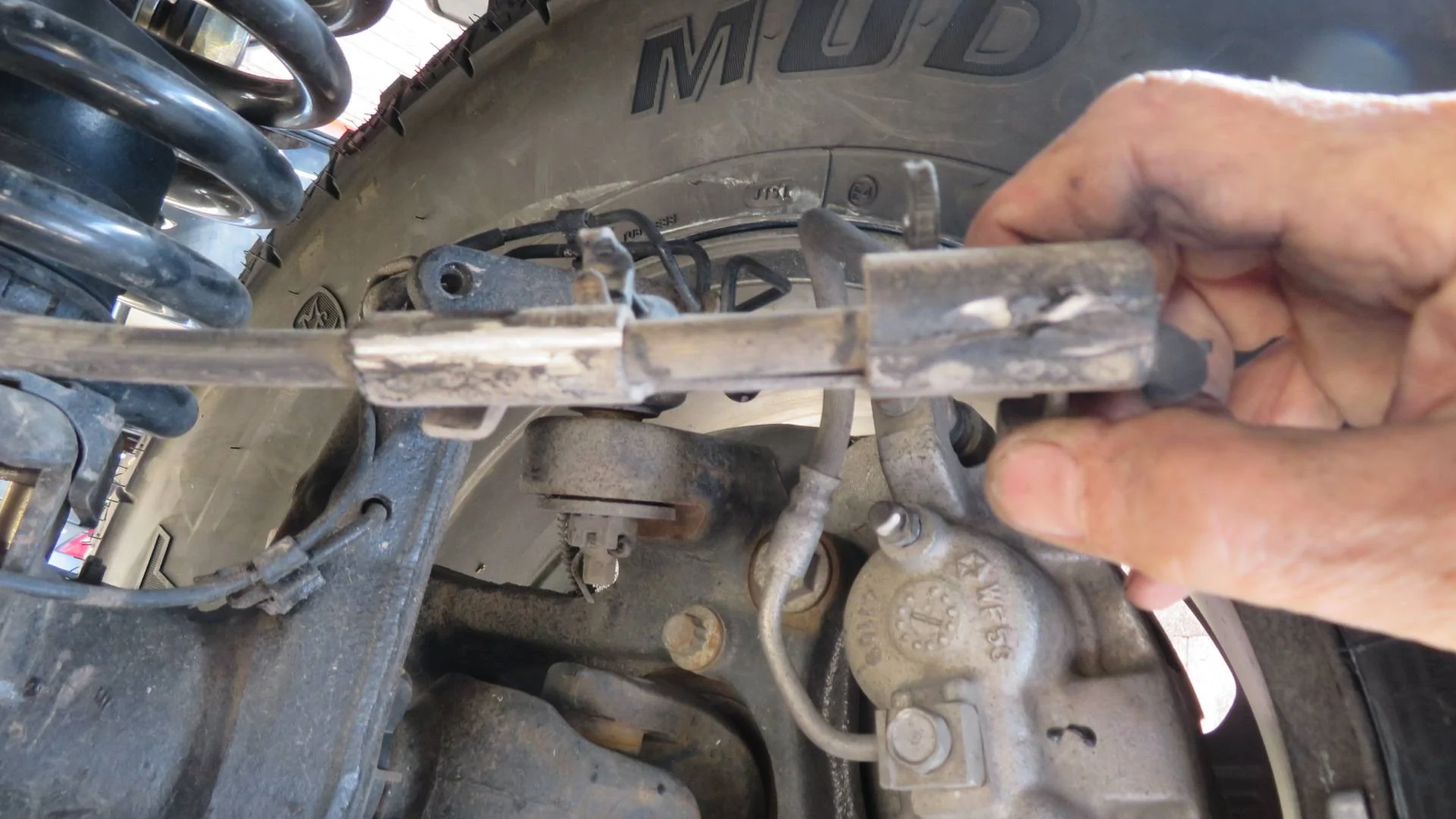

With the Core front lower front control arms. There is no place to attach the brake hose bracket. So I'm using the Teraflex brackets. To get the old brackets off the brake hose. I used a cut-off wheel on the backside of them. I don't cut all the way through them. Just enough to where i could open them up like a clam shell.

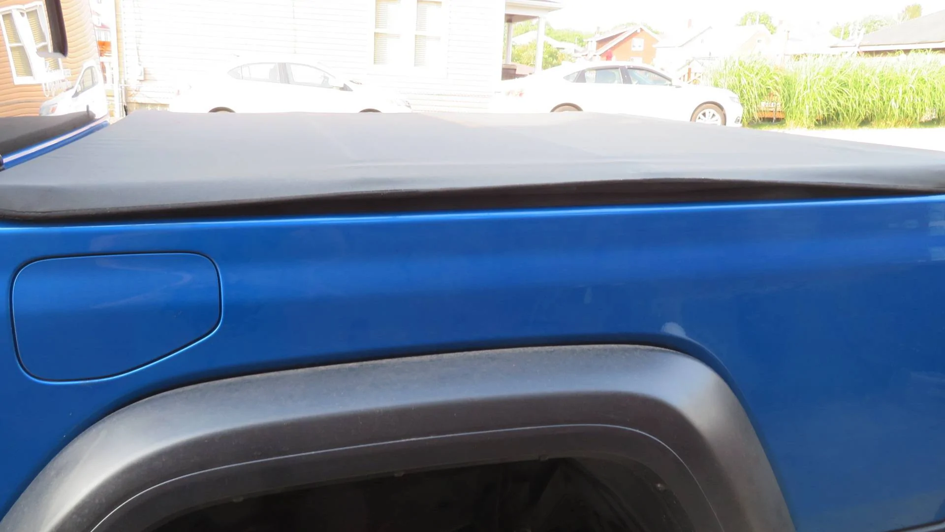

Got my new tonneau cover installed by the dealer today. It's all nice and tight.

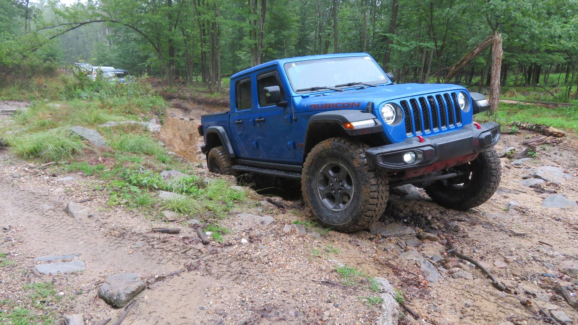

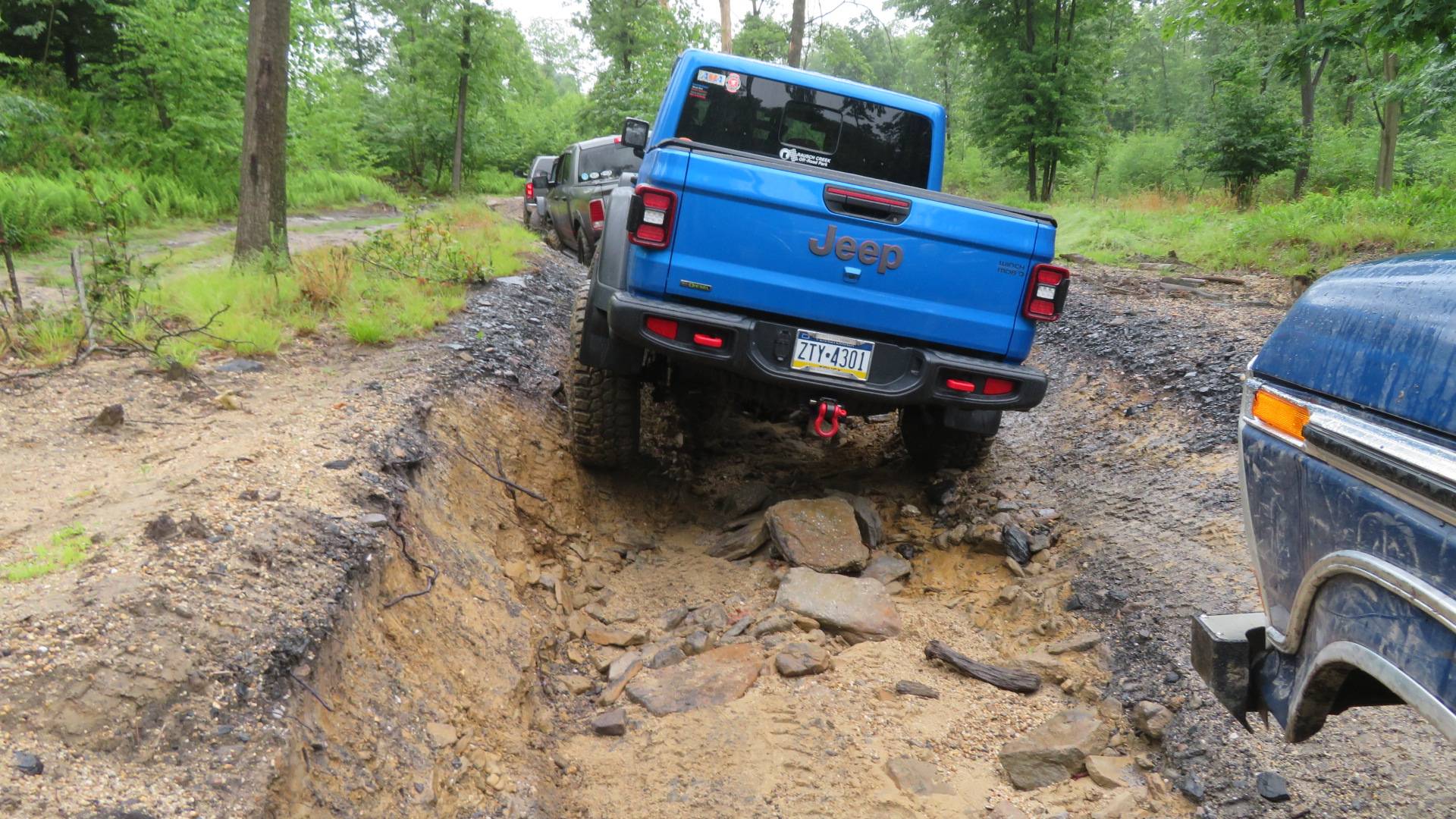

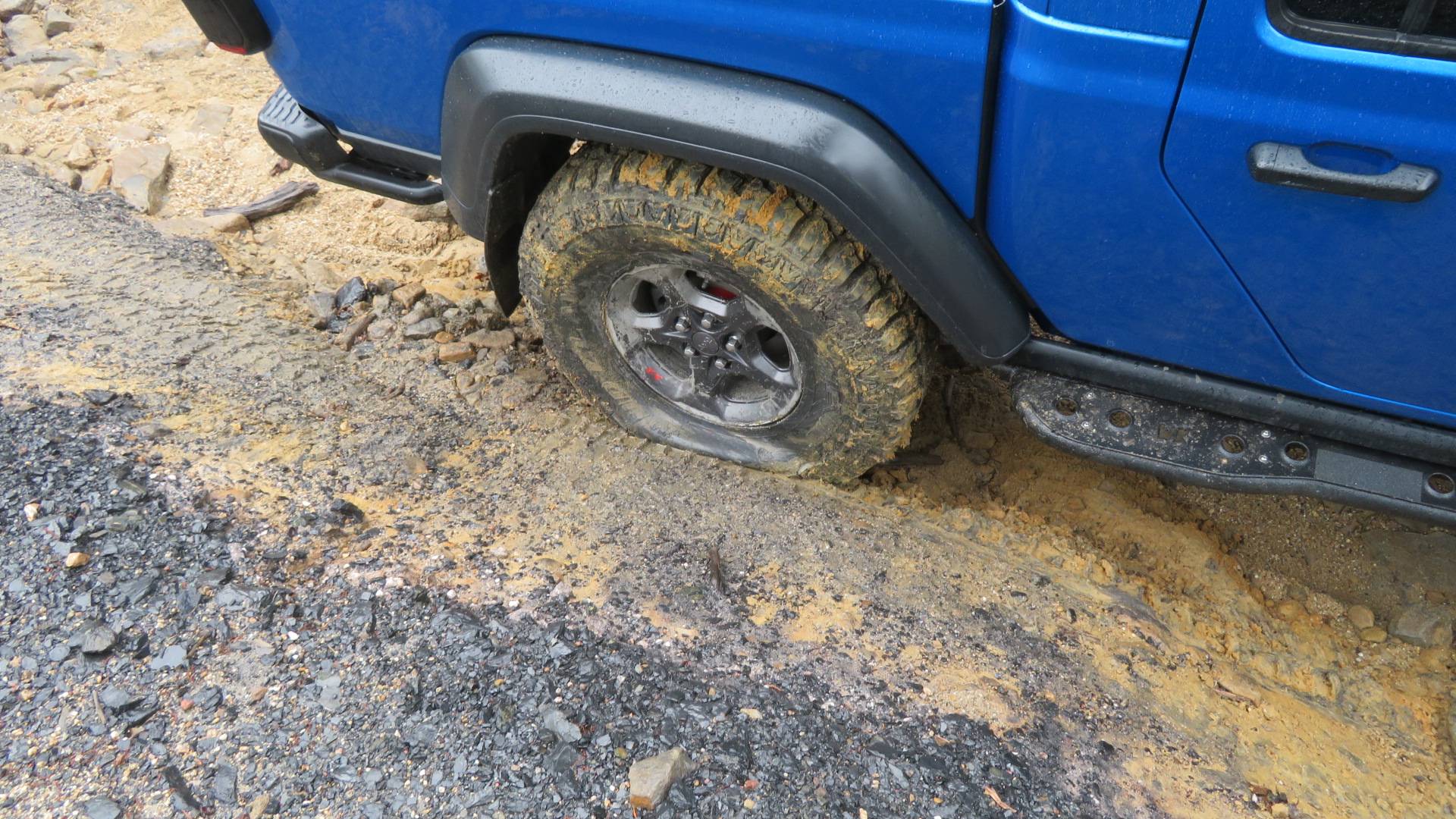

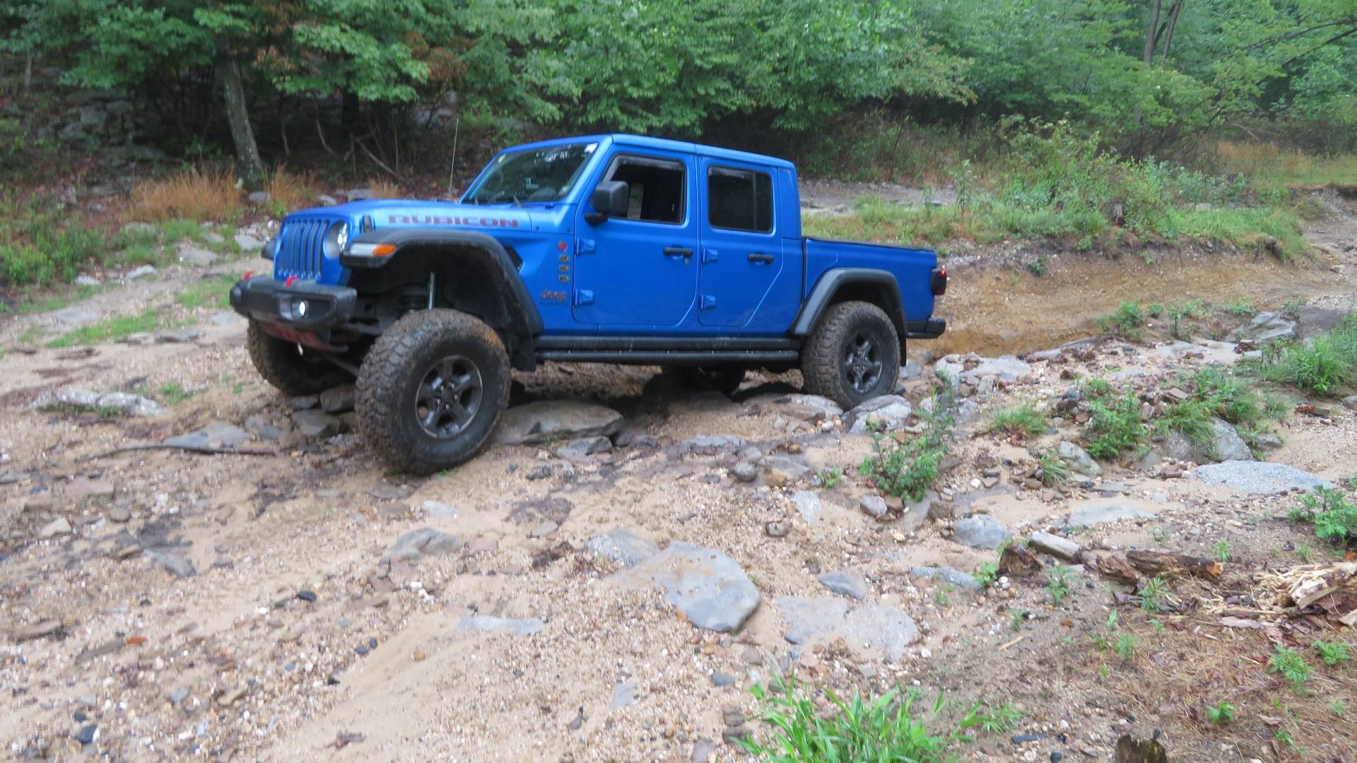

Some pictures from the weekend of 6/23 at Rausch Creek.

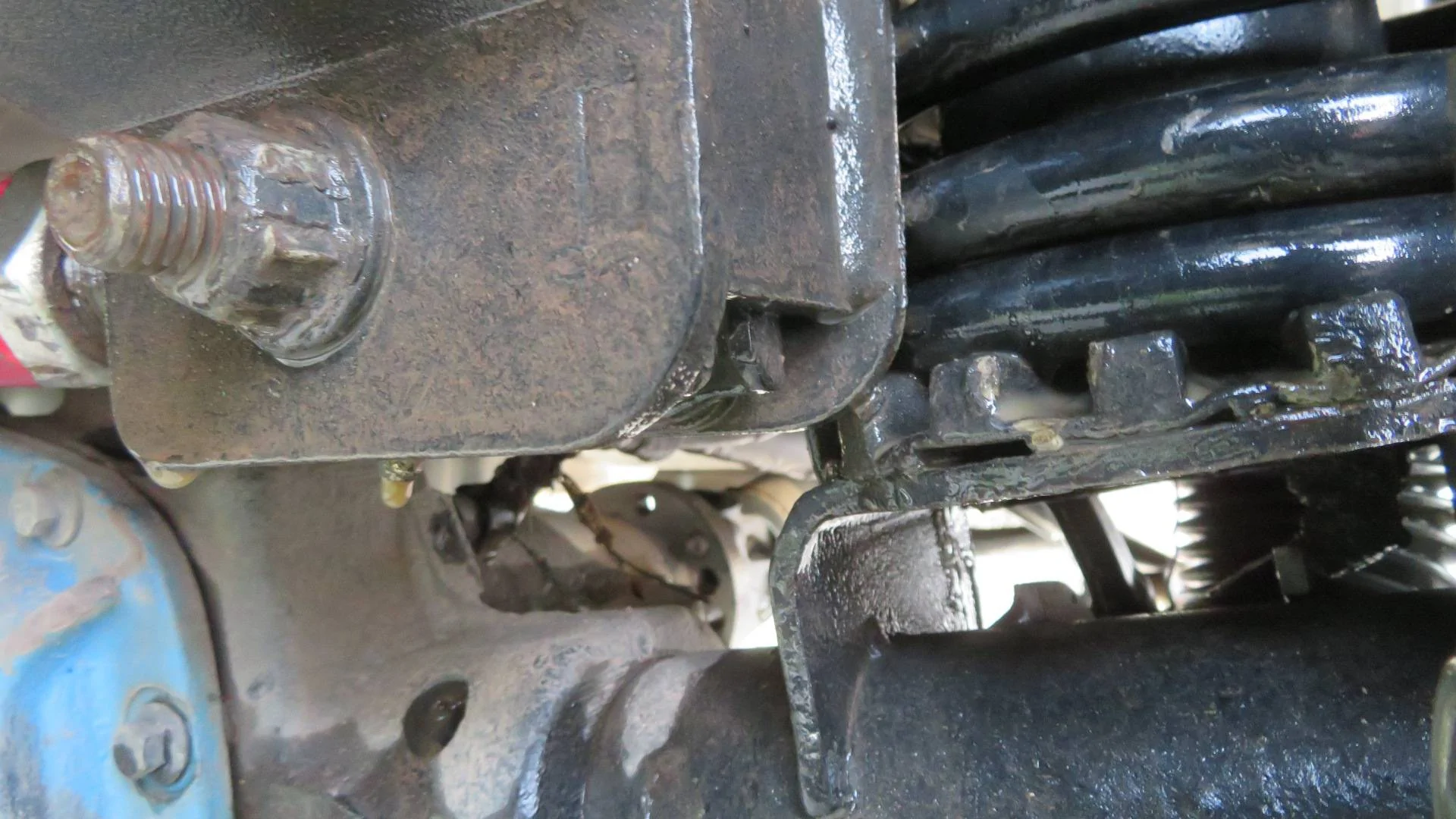

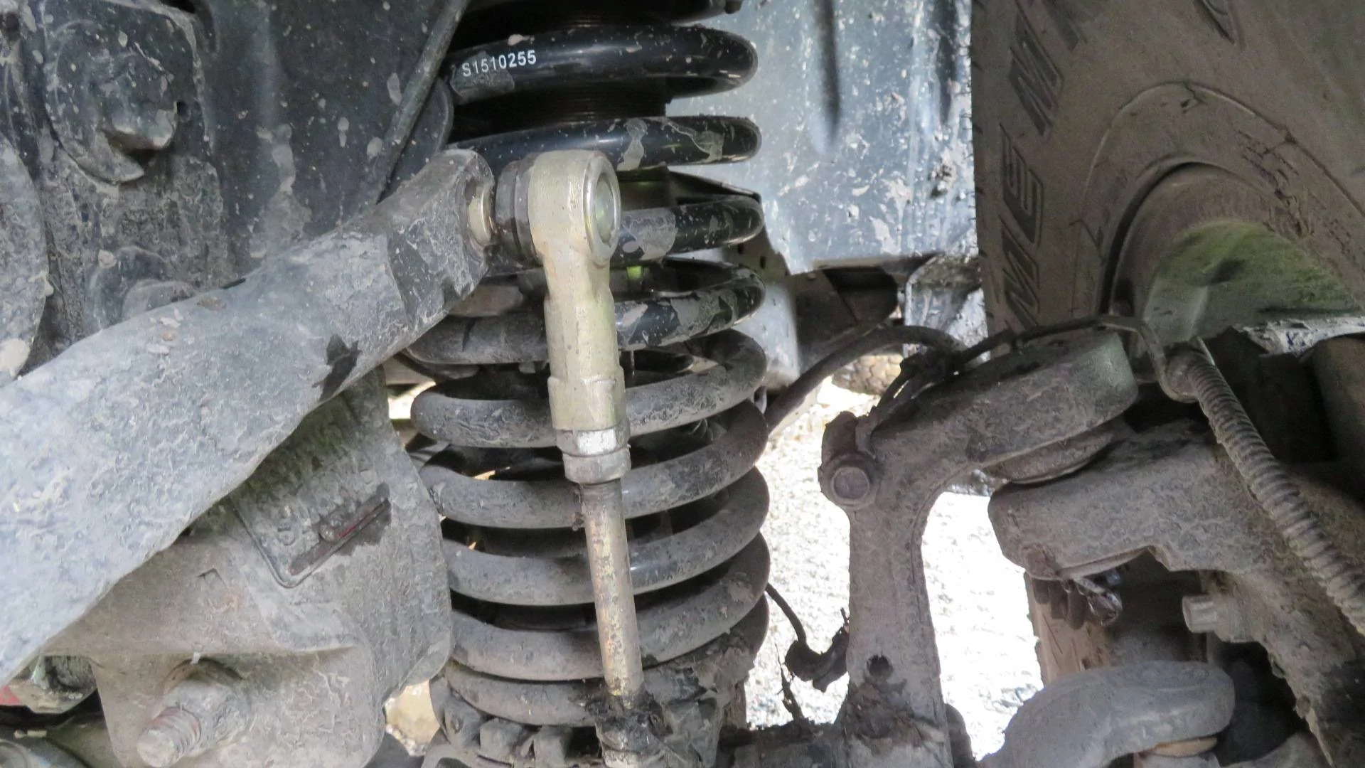

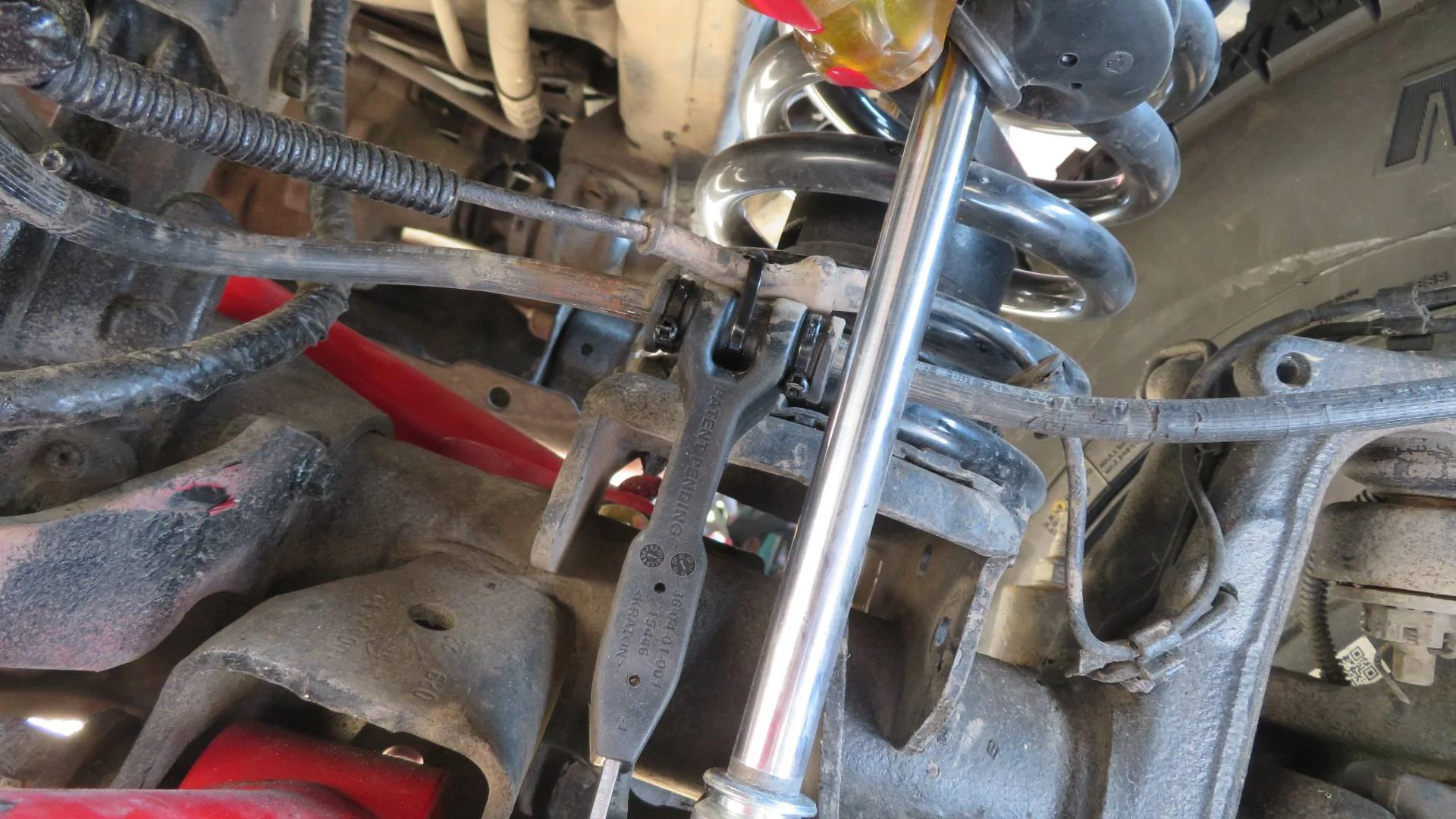

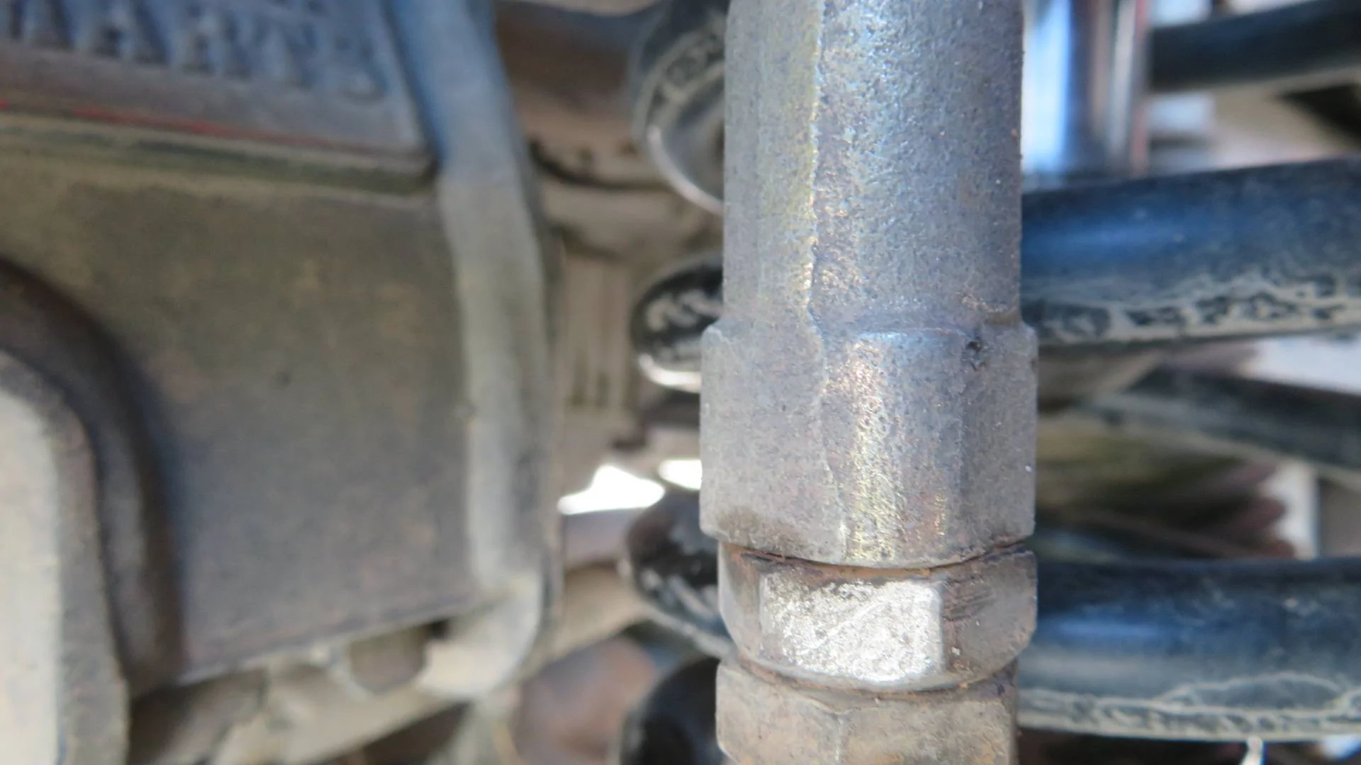

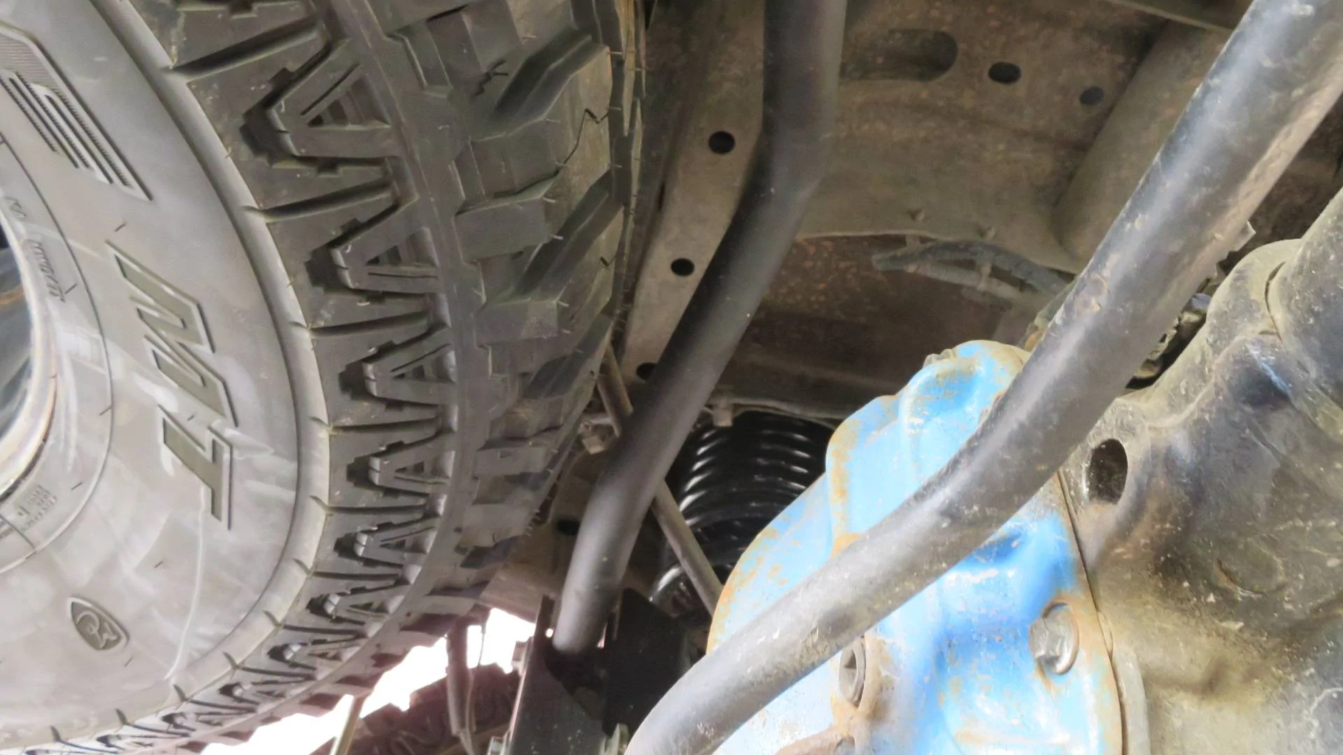

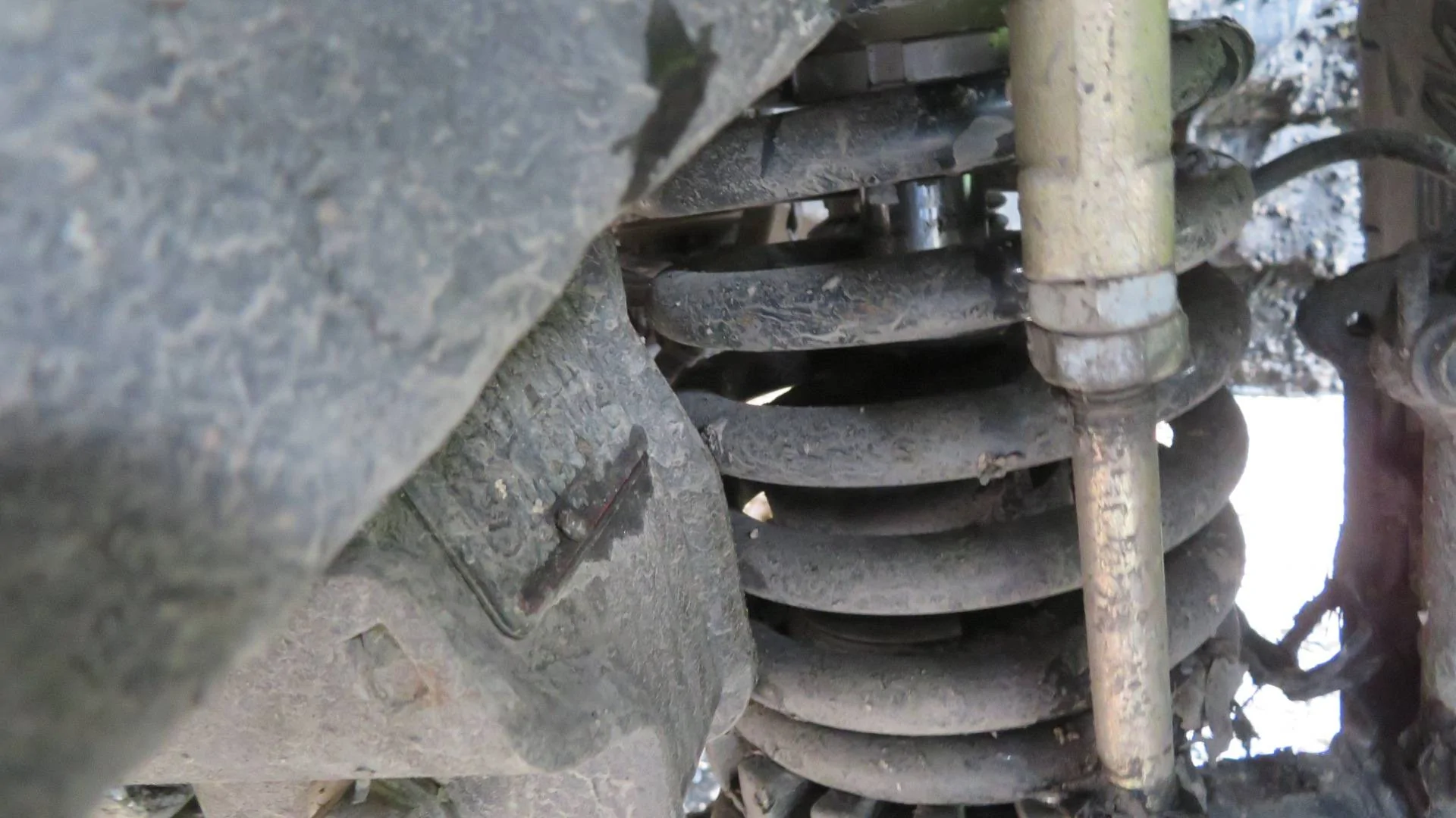

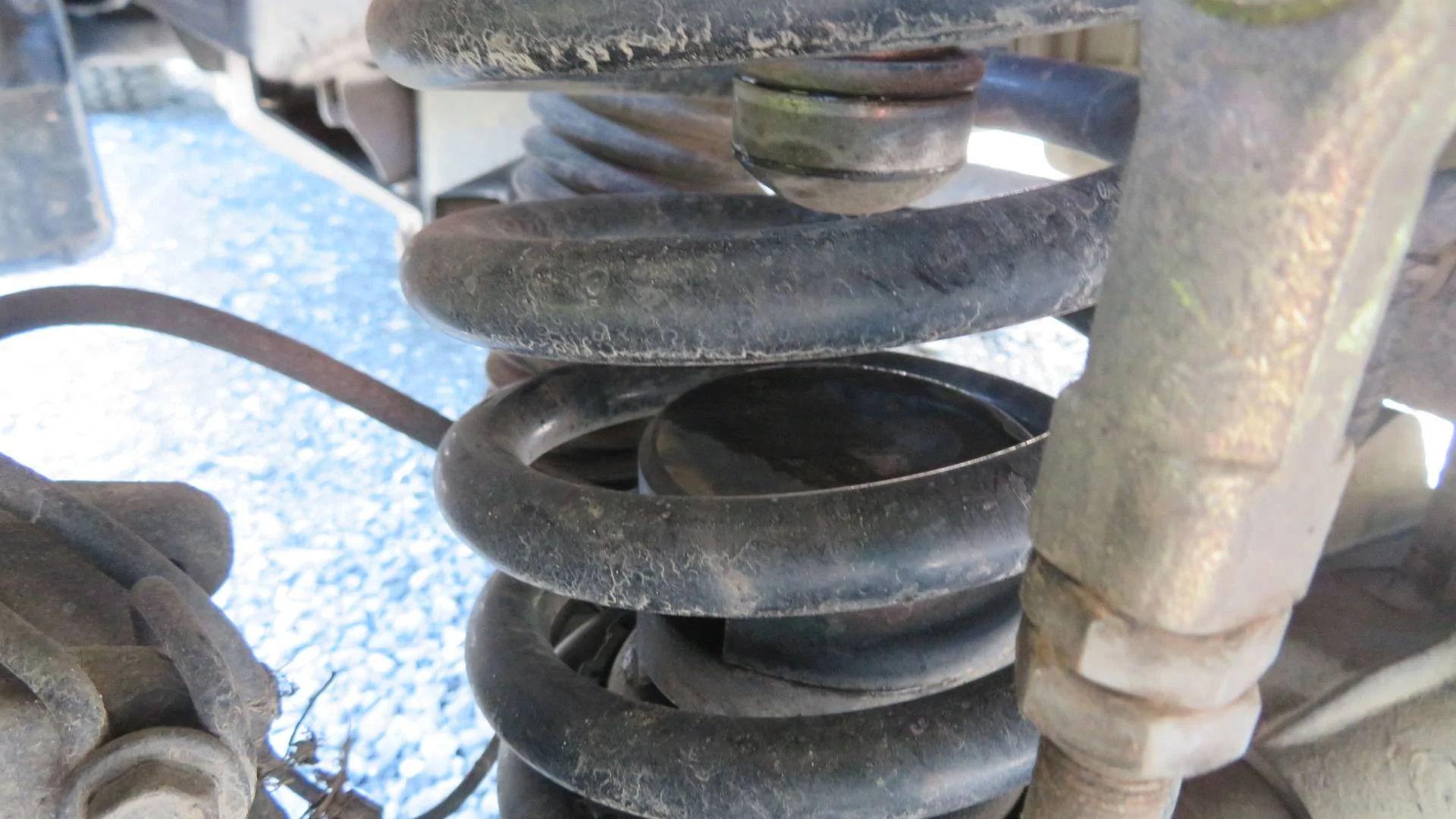

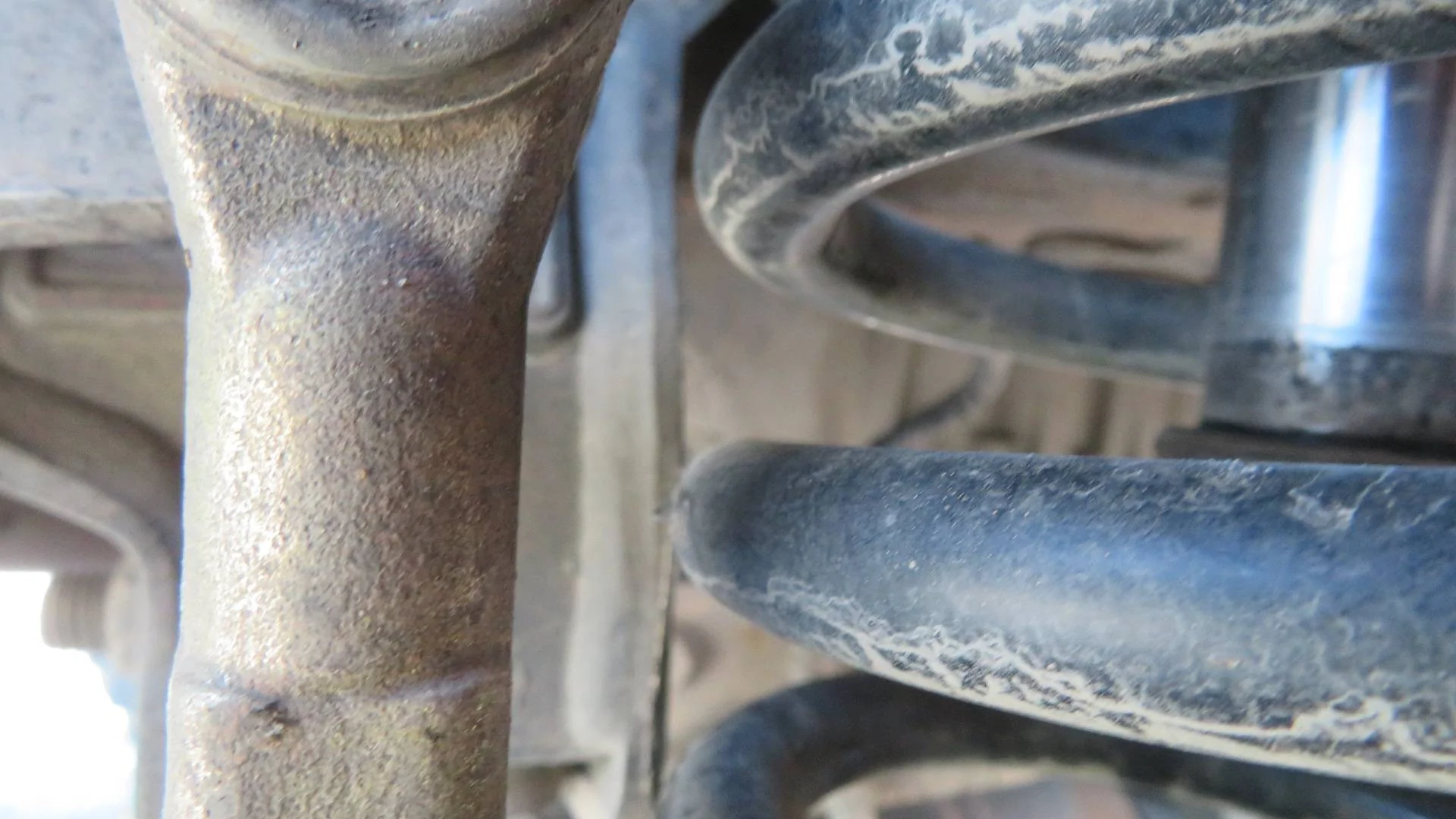

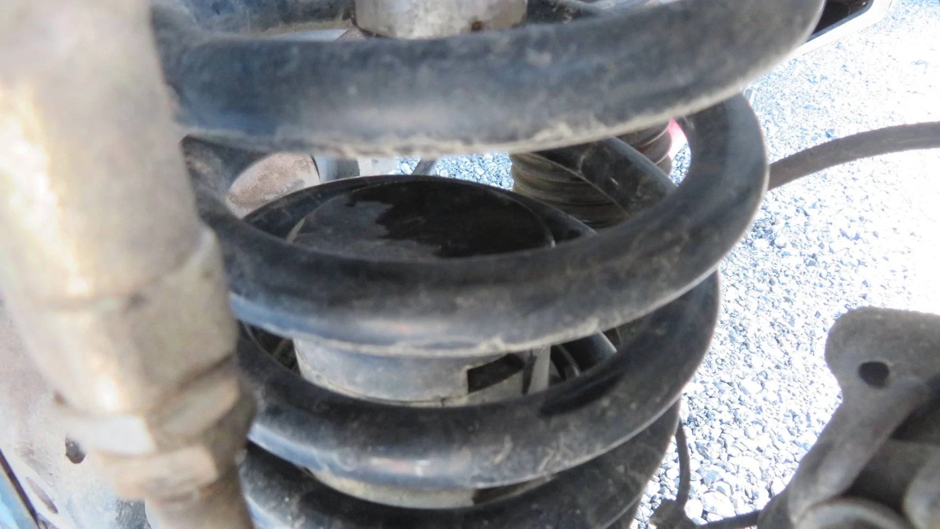

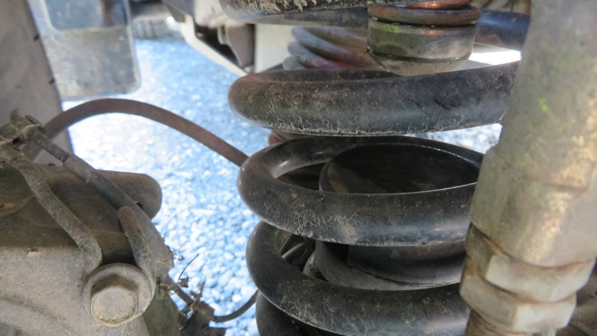

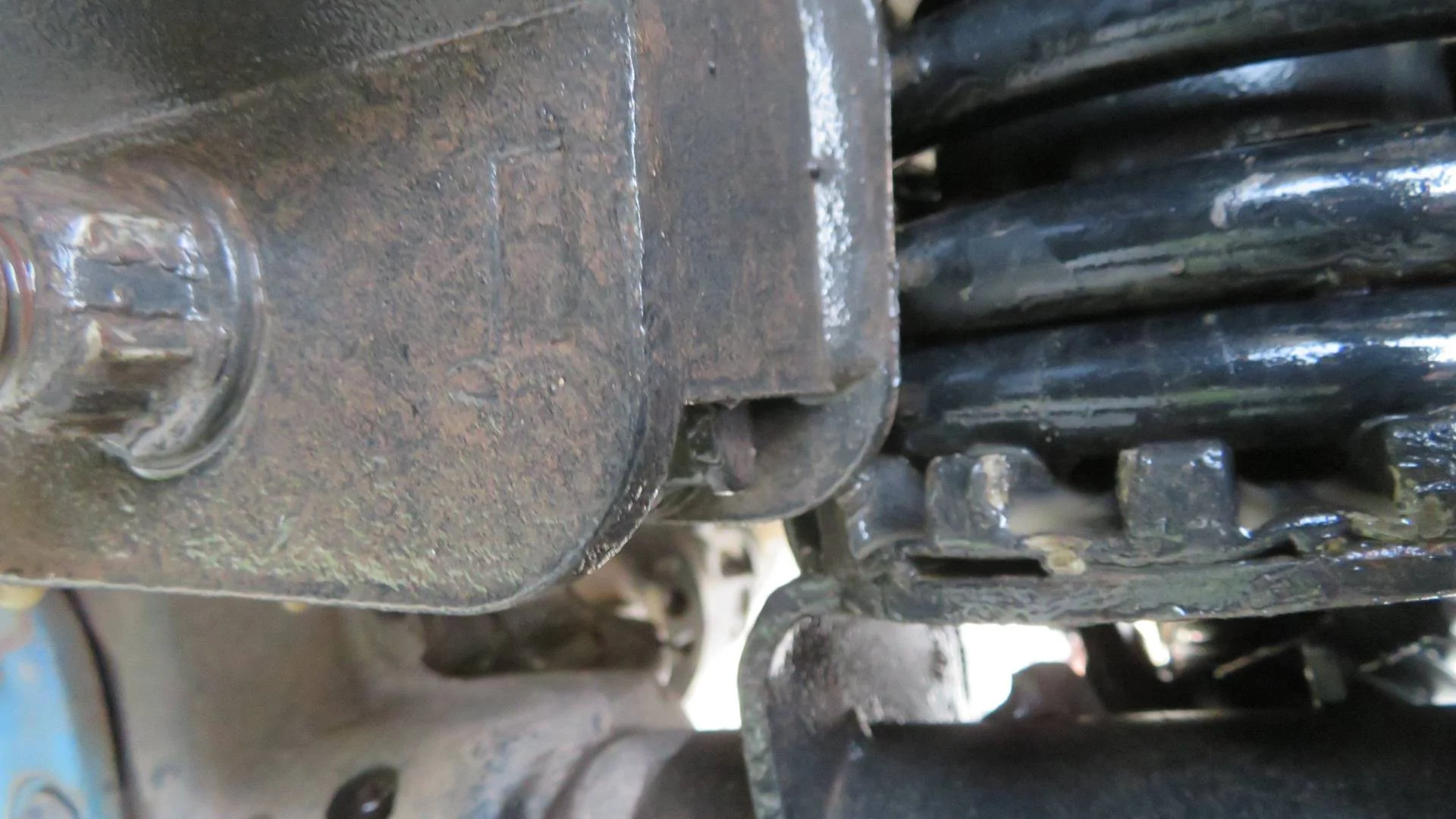

Found an issue on the driver side front spring and the Steer Smart steering box reinforcement bracket. The spring rubs the bracket at full stuff. Maybe next weekend, I'll remove the bracket and grind on it for clearance.

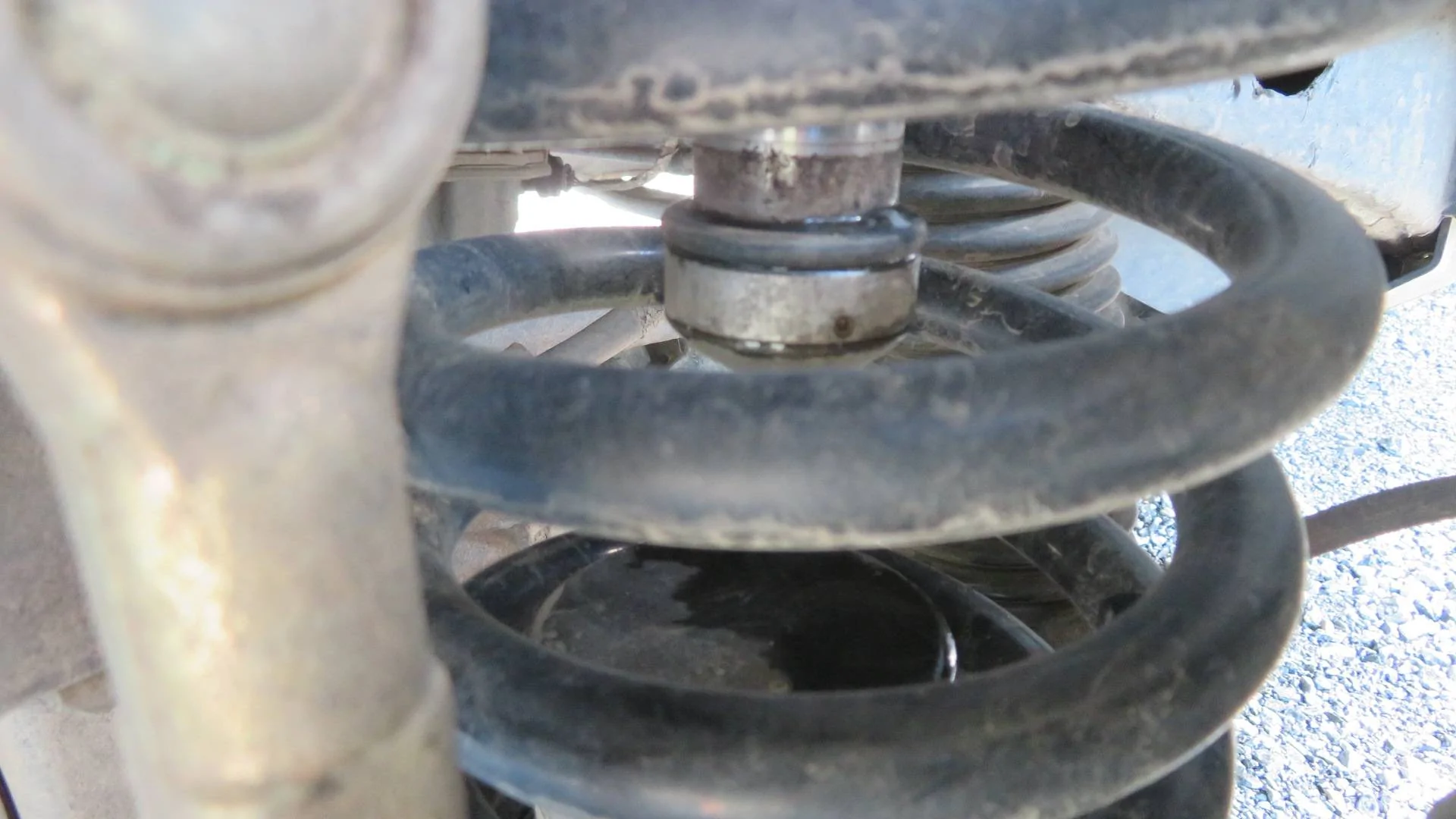

Both of my JKS hydraulic bump stops leaked. That's oil from the bump stops sitting on the lower bump stops. The bump stops still work. Have to use a LONG pry bar to get them to compress.

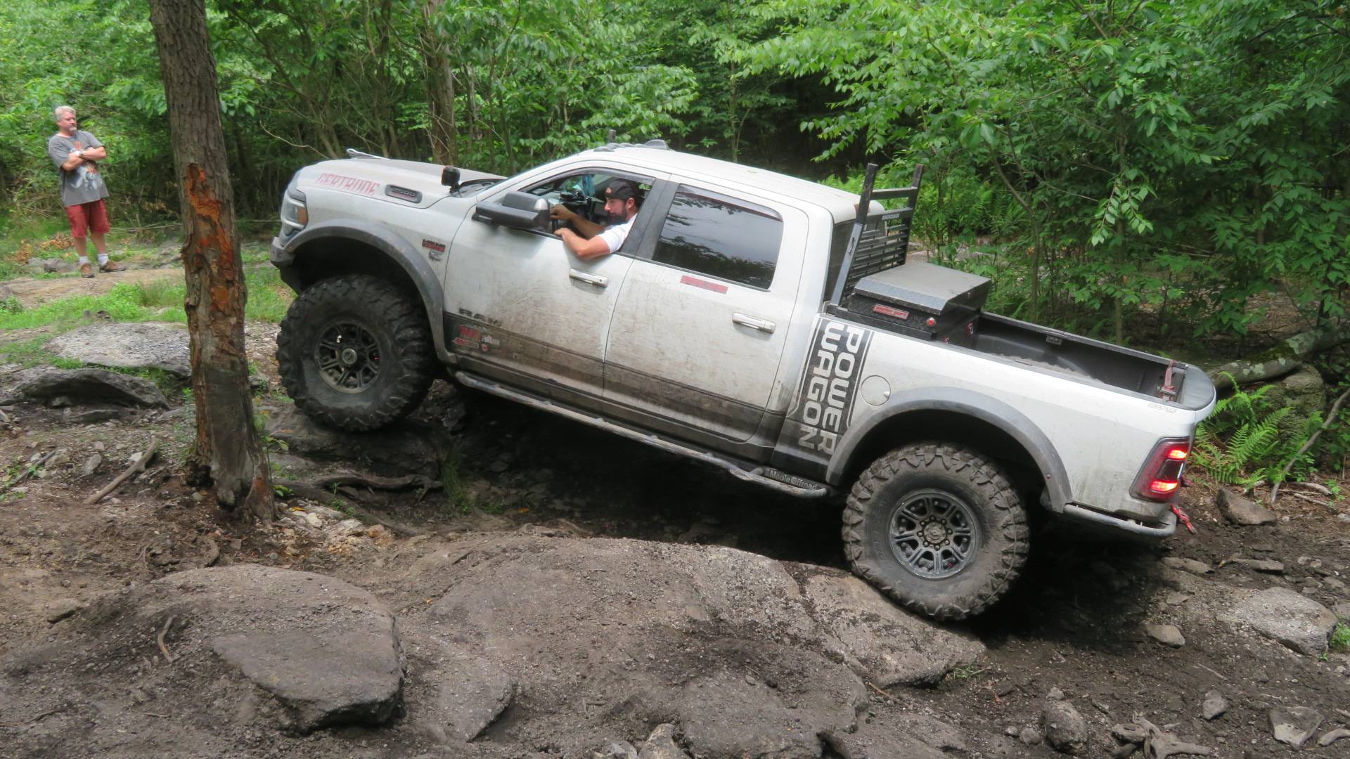

My buddy Dom and his crazy Power Wagon. His has done red and black trails with it.

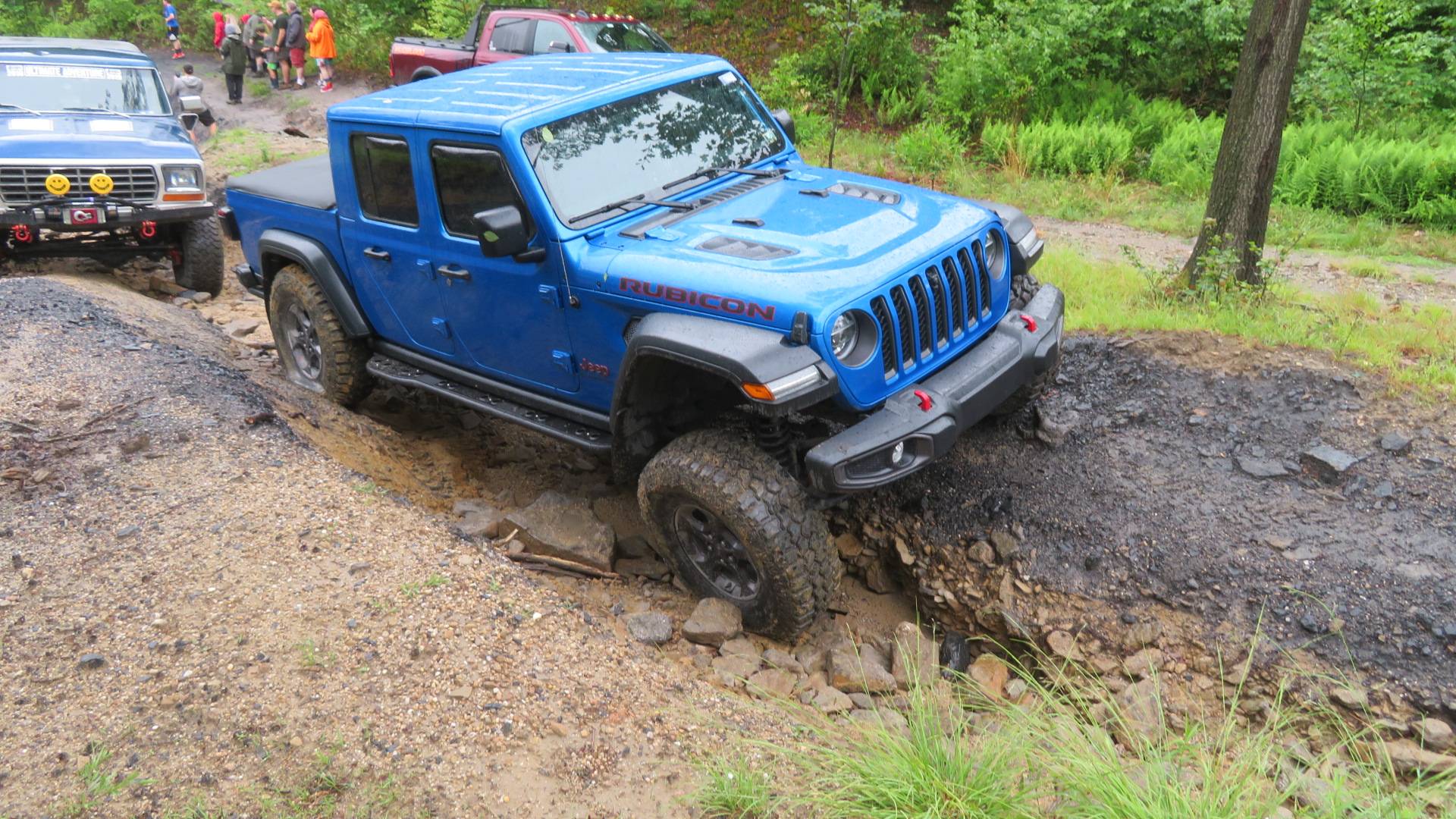

Going under a fallen tree at Rausch Creek. Went under it at a 30* tilt.

Harder than what it looks.
