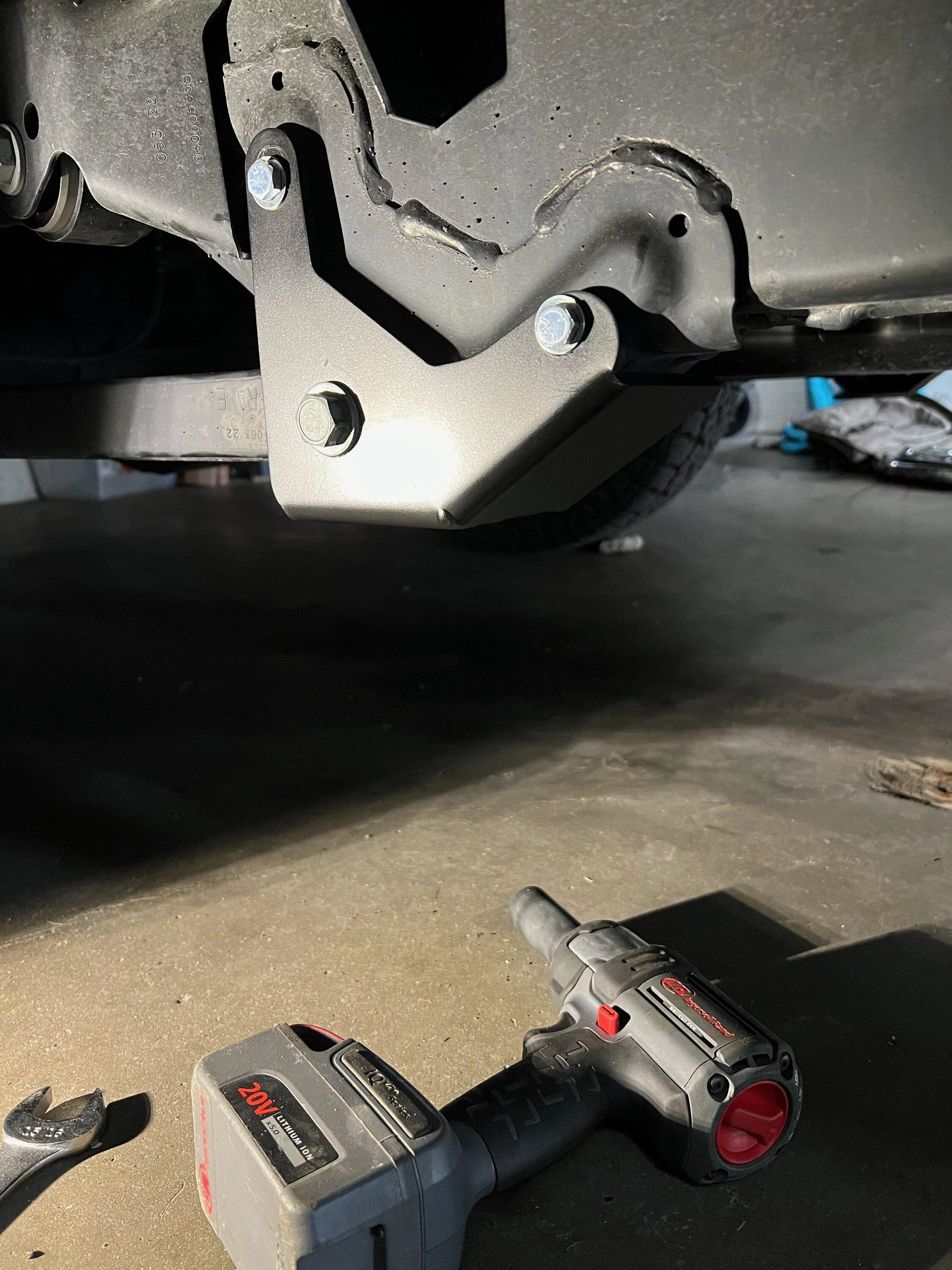

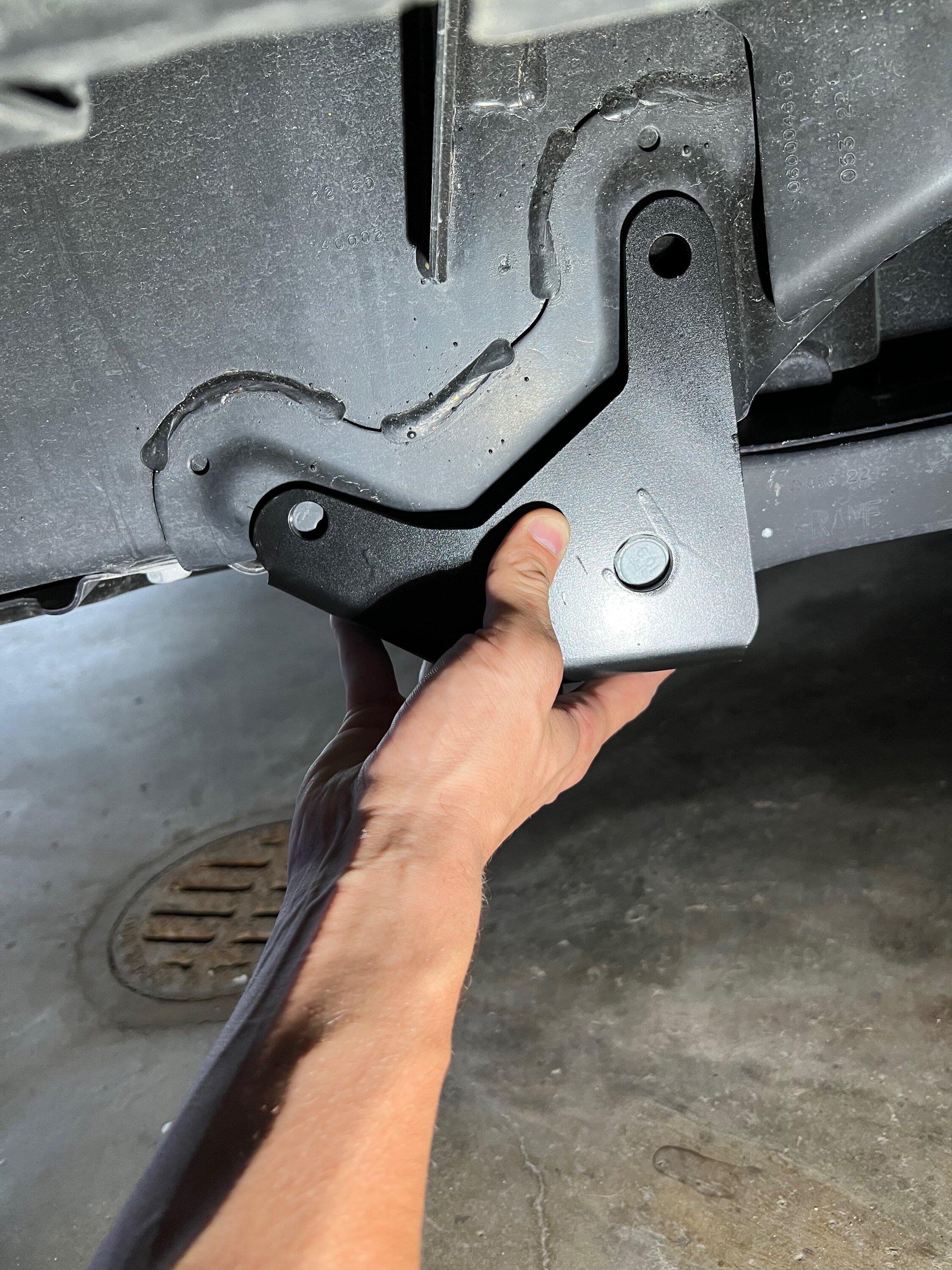

For anyone reading this worrying about the fit of Rusty's skids, I installed mine today in about 15 minutes.
I actually reached out to them because with a "dry fit" I was 100% convinced they weren't going to fit. (Pic below... the control arm bolt is right under the big hole at center. Yes, I suck at using spray paint.) They replied back and said the holes are big to allow for variability between frames. I put them on this morning and sure enough, they went right on.
