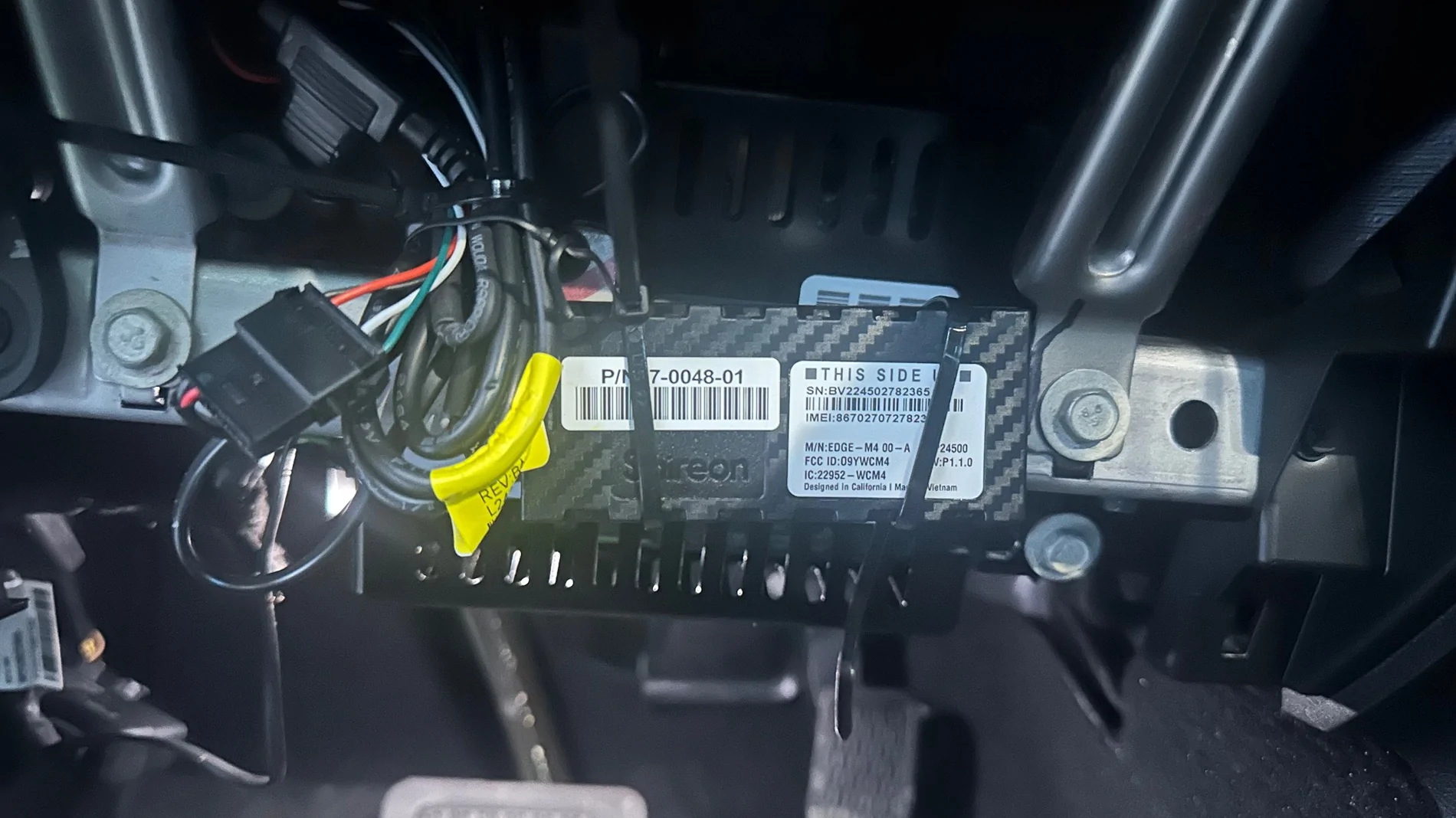

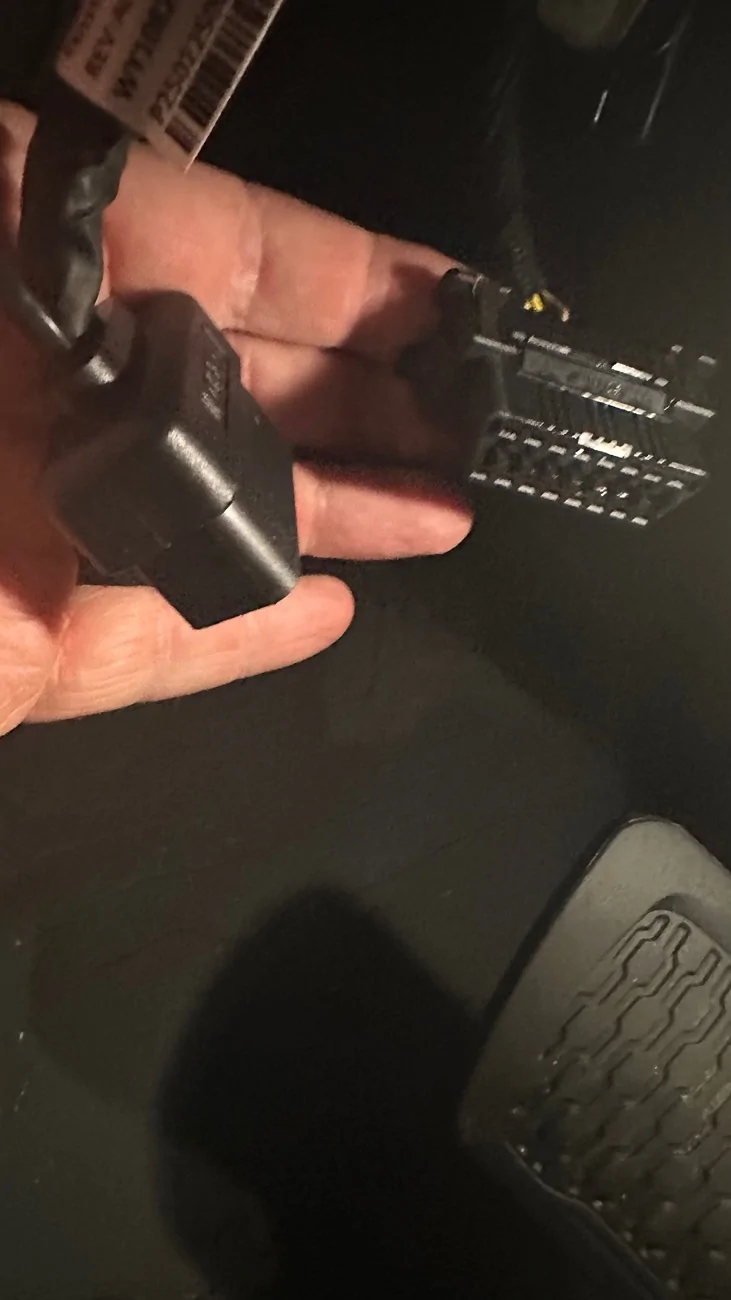

I’m trying to research in between tax returns. I did finish all my Corporate returns on today’s deadline and plan on taking a day off tomorrow to catch up on some sleep. I started tracing the wire and OBDII looking thing that someone above told me to take out.
Getting in and looking I found this and it looks like they should be plugged together.
Jeep Gladiator Safety Warnings and Doo Dads IMG_6268
Then I traced the other end to behind that panel underneath the steering wheel and found this.
Jeep Gladiator Safety Warnings and Doo Dads IMG_6267
Looks like a Spireon tracking device.
