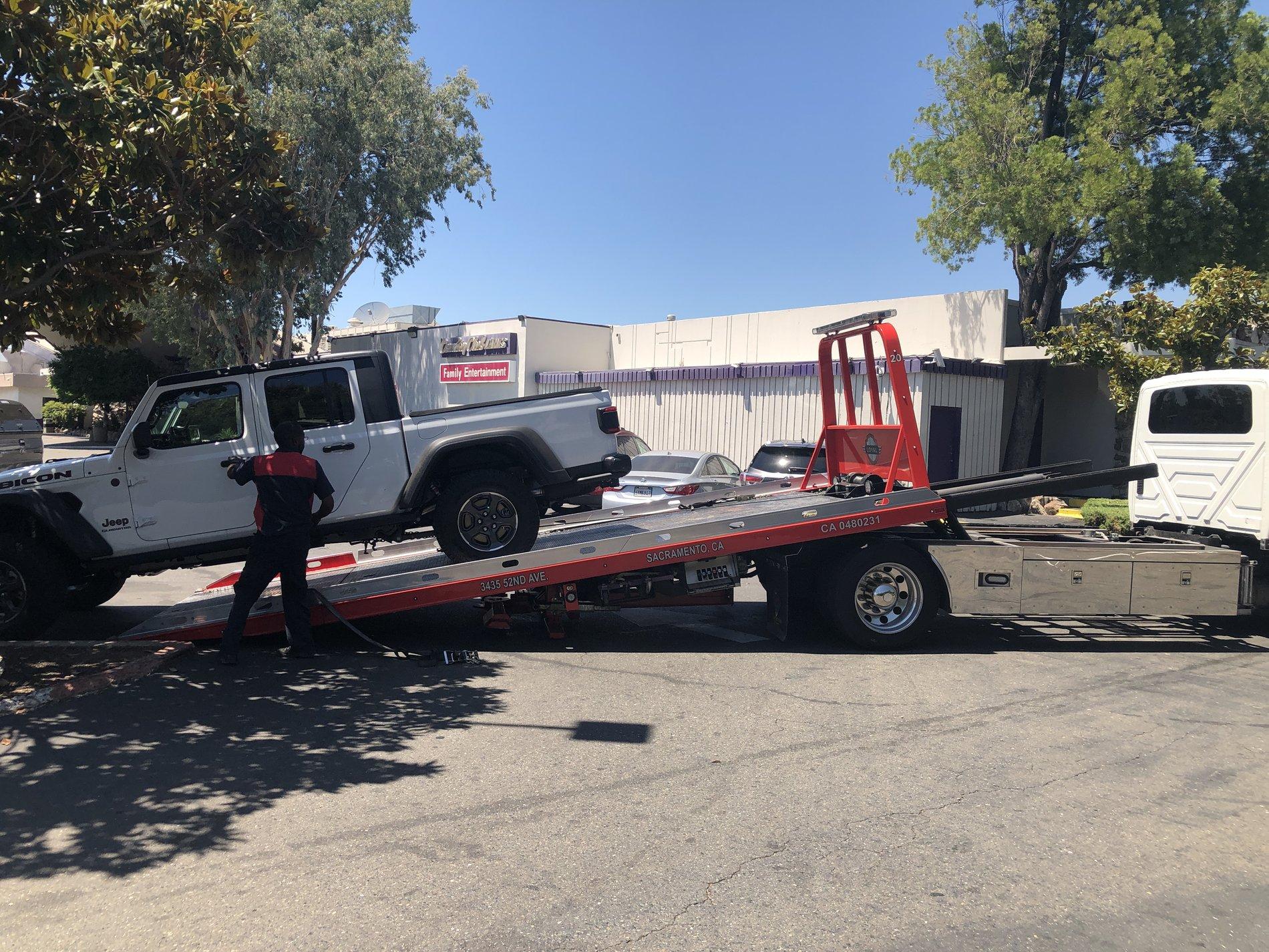

So I am out and about with my kids in my new Gladiator. We park the car and run some errands. We come back and jump in the car and try to start the car. Nothing! No turnover! No Sounds! Na Da!. The instrument cluster lights up. We can open and lock the doors. The interior lighting works. Nothing on the touch screen. I call the dealer and the next thing I am getting the car towed back to the dealer. They keep it for a few days and finally tell me that the Start Stop battery had failed and it would be over week to get the replacement. Needless to say, the car has not been returned. The problem I have is: how would Jeep design a start system for a car that is designed to go out to the middle of nowhere, that can fail to start when even has two batteries with no signs or warnings? Could you imagine being stuck on the Rubicon trail with no way to start your car? There has to be a way to bypass this system in a pinch.

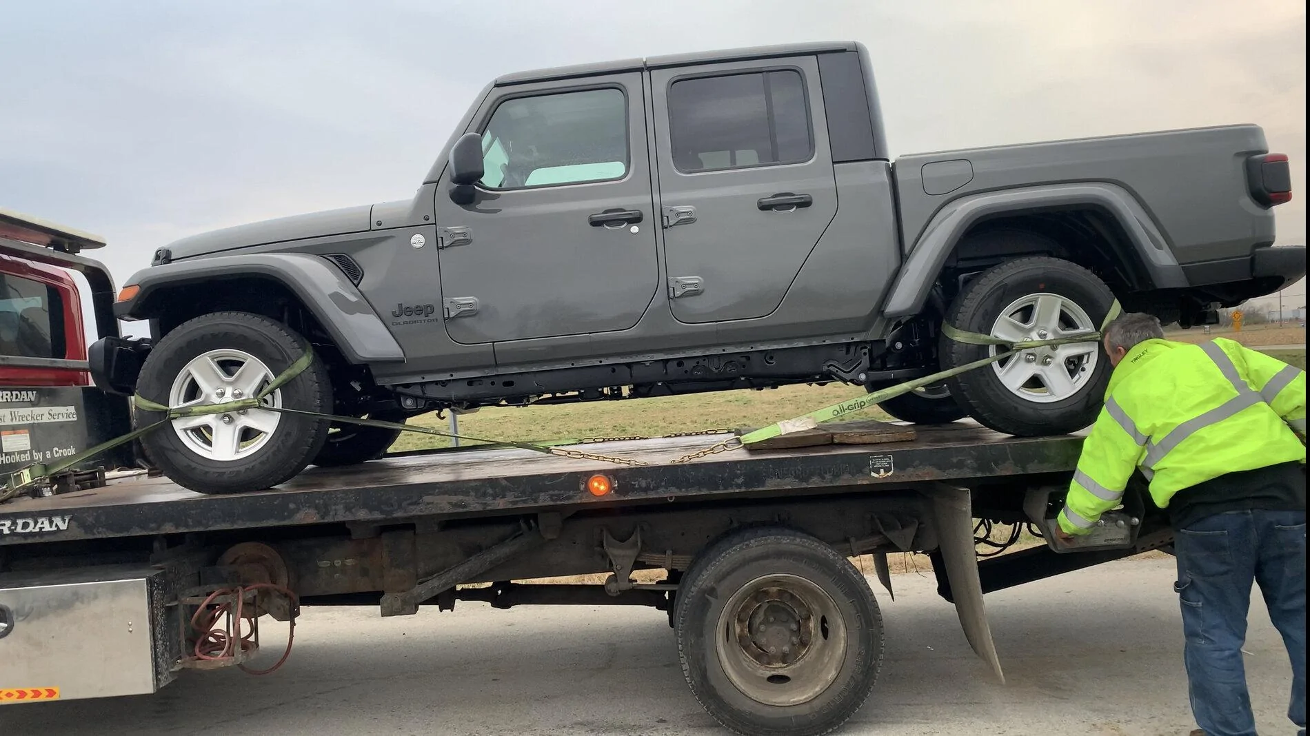

Jeep Gladiator Gladiator Down! Failed to Start with no warnings IMG_5378
I had the same issue tonight on my way home from shopping with the wife. It is a 2021 Sport S Eco Diesel. I pulled out onto the road and smelled a rotten egg smell and got the warning that the start/stop was not available. I pulled over as not knowing what it was and shut the jeep off hoping it would clear the error. Went to turn it back on and nothing.
I have only had the jeep for a week and it has 308 miles on it.
Funny part was my wife's Liberty died at this same location a month and a half ago and that is when we decided to order the Gladiator
