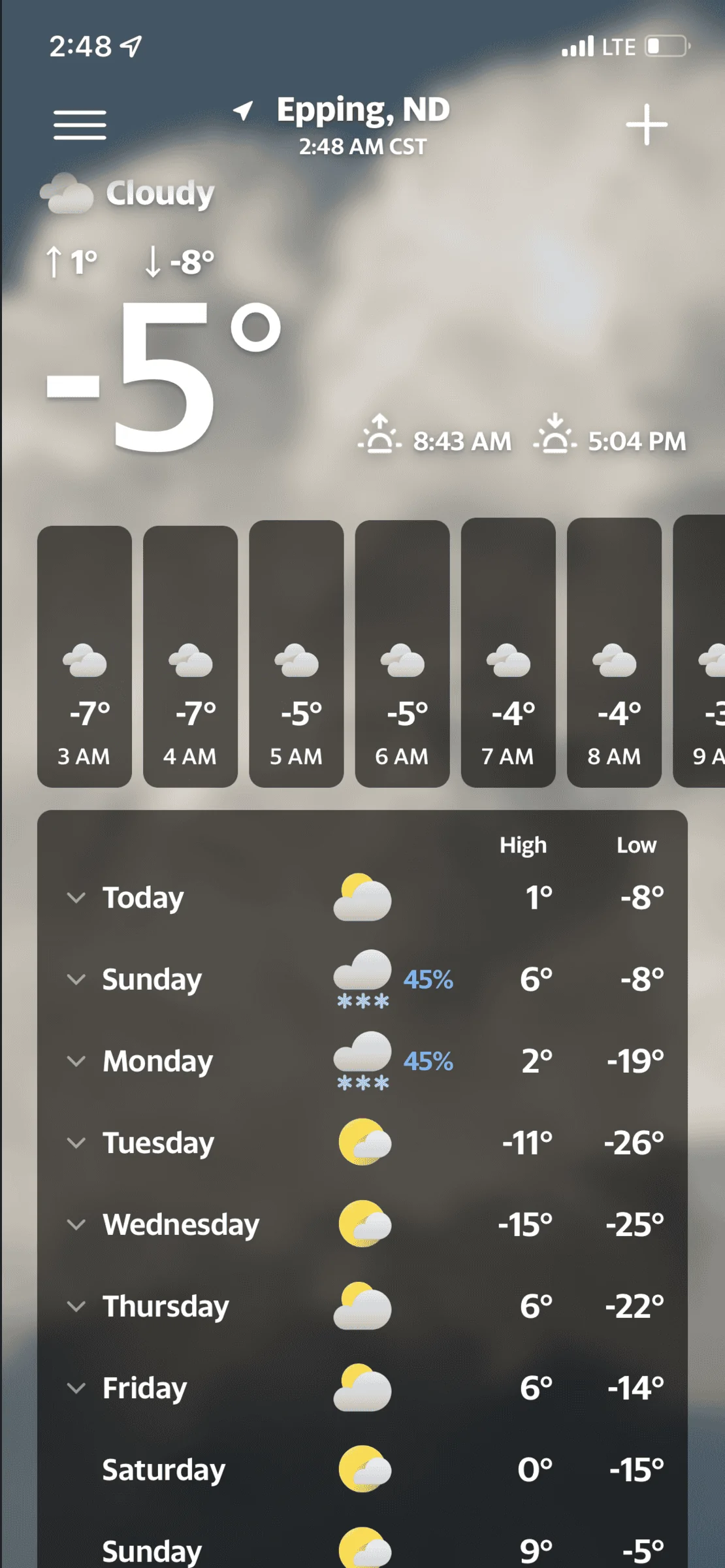

I wish I did have one but I don’t… currently working in North Dakota and it’s cold. But my gasser JT has started no problems.
