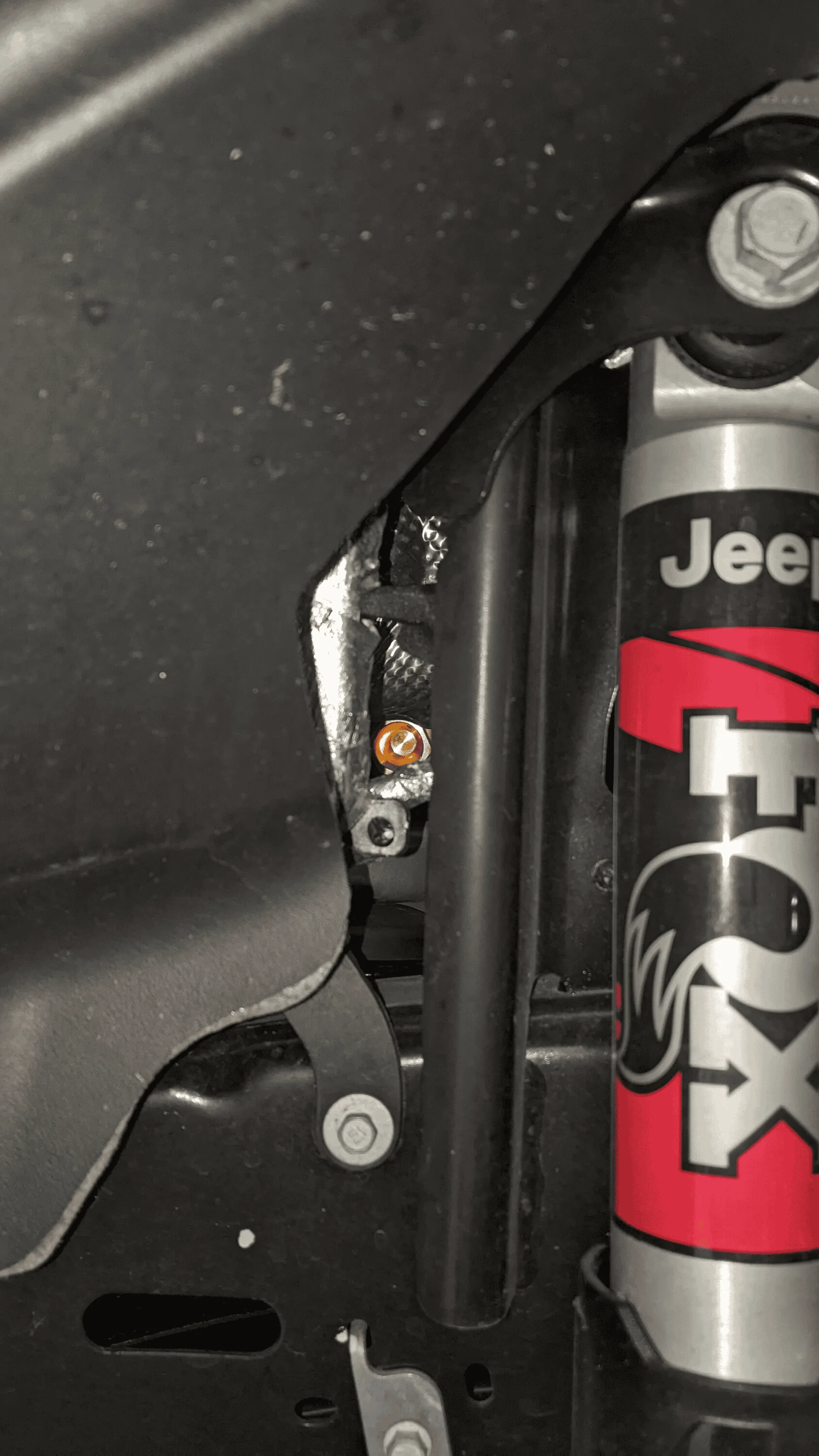

They dropped the block heater for the diesel in late '21. i tried to order one when i ordered my JTRD in Jan. The dealer said that Jeep dropped the option. I checked to see if I had the heater installed anyway. It's just a brass plug sitting there.

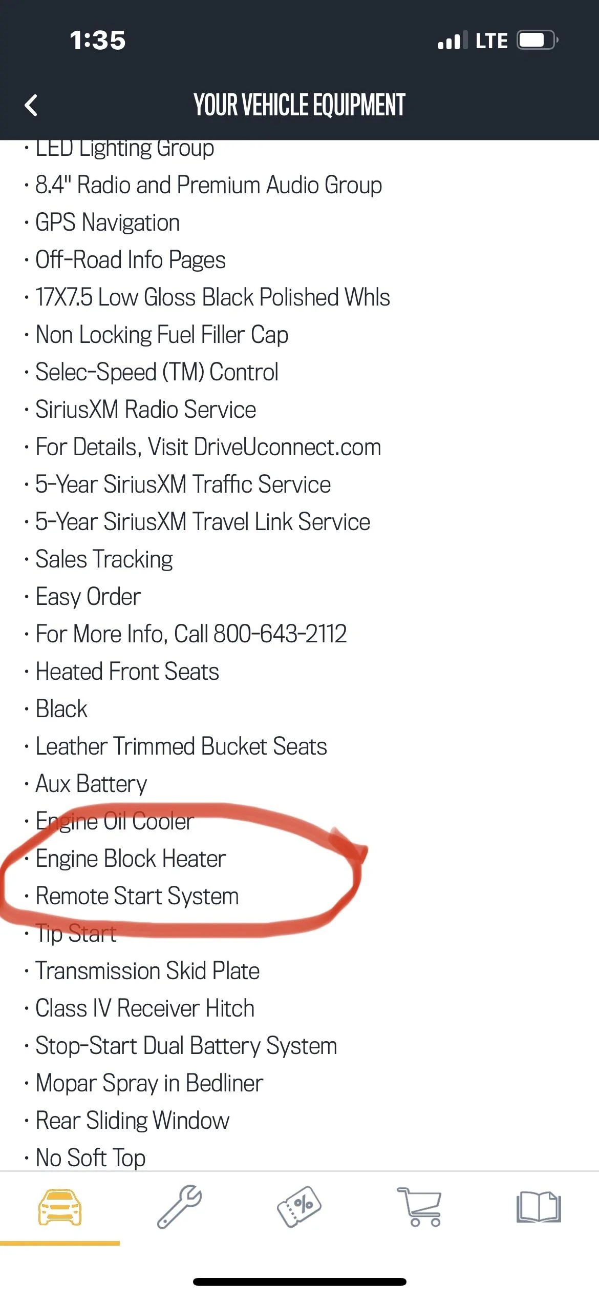

Wondering if I am in the same situation. I have a 22 JTRD, so built in the tailend of 21... I thought I remember adding a block heater to the build, I do have the cold weather package... I recently looked at my window sticker, a block heater wasn't listed. I was trying to locate the plug, but couldn't find it.

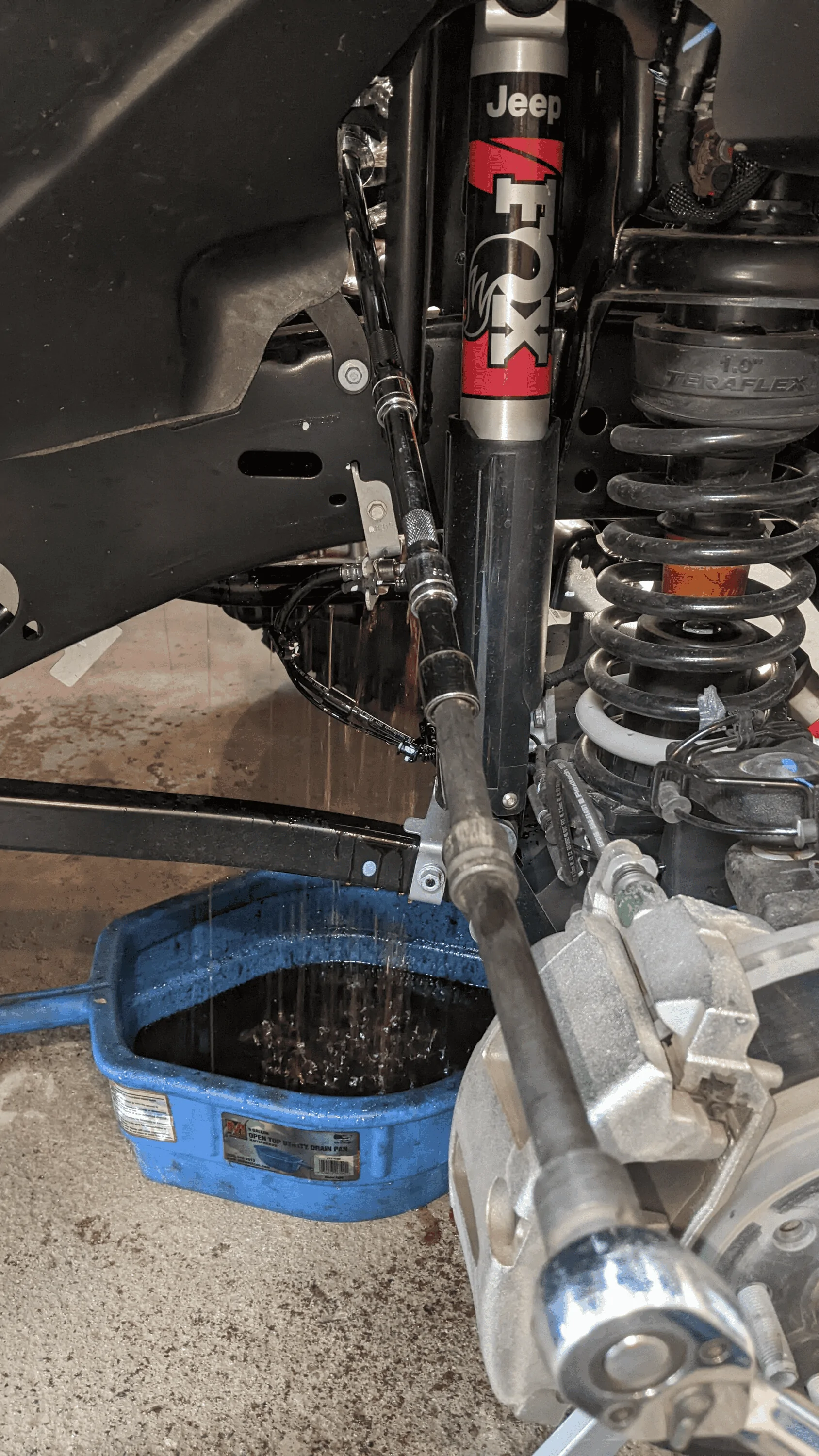

Yeah, the plug is on the passenger side. It's best to remove the tire.
Here's the best install thread on it.

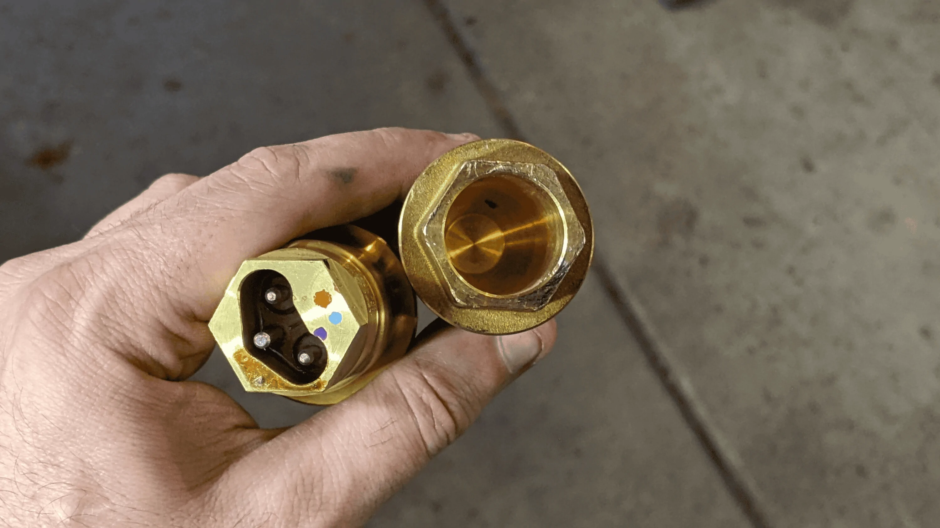

It stopped on it's own. Figure that I lost about a 1/2 gallon.
If the you have the one on the left. All you need is the cord. If you have the one on the right. You either replace it with the left one. Or use the new style that goes into the one on the right. I'm thinking since you have a '22 build. You have the one on the right.

The old style block heater # 56044738AA.
The new style blocker heater # 68523853AA. You will need the matching cord.
