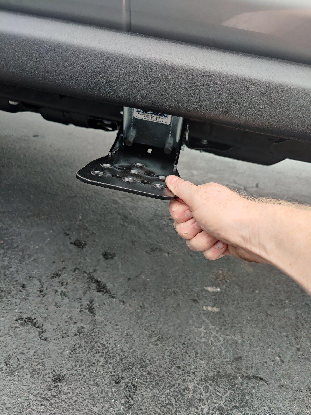

Wife loves the single hide a step...

How hard was that to install? I had one on my JKU (that my wife didn't end up using) and it was a PITA to install. Very well could have been an ID Ten T error on my part though. Looking for something for my new Mojave. She has already said it is tougher to get into and I'm planning on bigger tires soon.

Well it was a pain the first time I tried. I didn't think it would fit... then posted a question here and someone showed me how they installed their using zip ties to hold the bracket folded in place)...
Tried again and it went in w/o issues!
You just have to loosen the rail bolts (install suggest only loosening the one you are sliding the step on, but I ended up loosening the others, didn't take very long - 3 bolts per brackets, 4 brackets = 12 bolts to loosen at most, all easily accessible).
So IF I had properly folded the bracket with zip ties (which I won't lie is a bit of a pain), I probably could have installed it in less than 30min (if you're doing 4 I would say around an hour as it shouldn't take much longer since the rail will already be loose at that point).
I did just one since they aren't cheap and I don't really need one for myself (I'm 6'1, wife is 4'9!).
I did mine in the drive way in 30 min, Was pretty ez.
