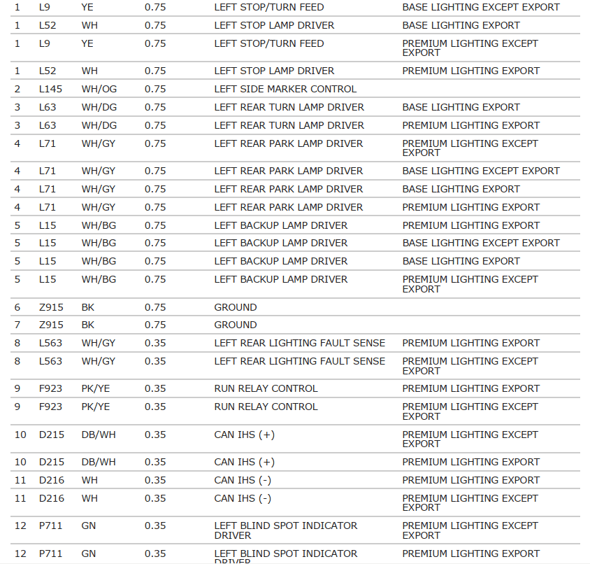

What's the best way to handle an intermittent electrical issue? The left rear turn signal and brake light on my 2020 JT has this issue - I have traced it down to the wires going from the wiring harness to the connector that the light assembly plugs into. I can wiggle that wire and get the lights to work or not work. But trying to get the service department to find the issue seems futile: if it's working when I pull up to the service advisor's desk they see that there's no problem. I'm tempted to just fix it myself by adding a jumper around that connector, but then I'd be killing any future warranty work on that harness.
If it was my truck, which is still very much under warranty, I'd disconnect that connector. I'd inspect all pins on both sides - the truck harness side and the tail light side, to ensure they are all "sticking out" the same amount and none were pushed back -meaning they'd not latched in and were pushed out of the shell when connected. Push all firmly from the wire side toward the connector shell to ensure they are seated in the shell and snapped in place.
I'd then apply some electrical grease to the pins and the seal and put it back together.
I'd pay special attention to pin/connector #7 (I believe it's number 7) that is a ground as well as the other ground pins in that connector. I have the pin-out i the house on my server - shop chromebook doesn't do well getting there)
Since it impacts two items, it's possibly a ground or the lead to that function itself. I'll have to go in and refer to the file I have of the pin-out for that.
Found it - brake/turn are pin 7. That's a "corner pin". The one above (or below) it is #1 and that's a ground.
So pay attention to #'s 1, 7 and 6 because the latter 2 are grounds and the first is the stop/turn pin
Likely it's a very simple matter of a poor connection here - a pin on either side out of place, etc. as the wires very very rarely break or have issues themselves.

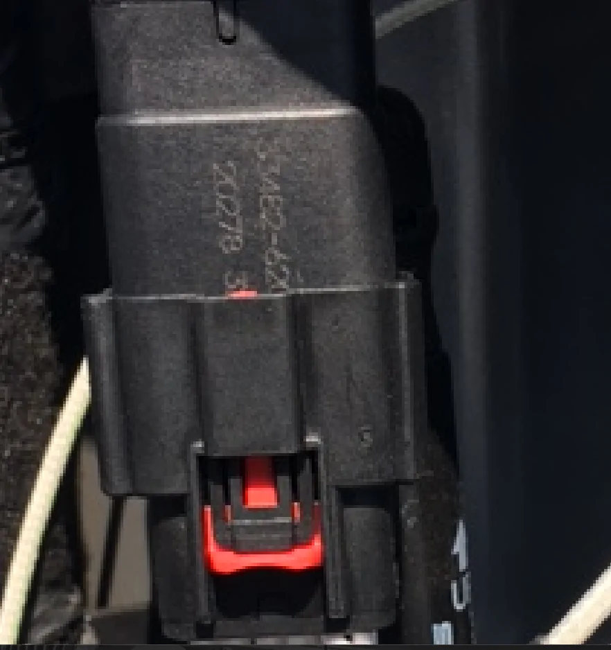

Thanks, Bill. Is there a trick to getting that connector unplugged? I tried briefly, but it seemed like there was something holding it together - maybe a locking lever or something?

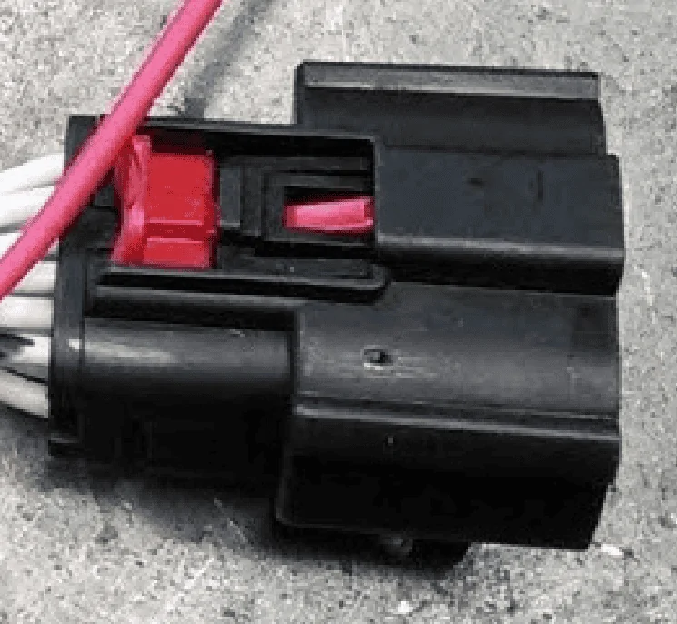

The tail light connectors - at least on Overland with LEDs, is like this - pull red lock down/out, press tab, connectors pull apart.
