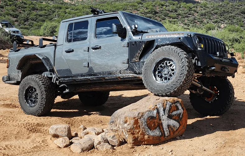

Did you ever take into account the payload rating? After all of that additional weight from the accessories do you have any payload capacity left over for yourself and a passenger? The added weight is just another stress on a number of the systems that you've had failures on. another reason for the dealer to say no.
However, I have to admit the rejection of your sun visor mount claim sounded pretty lame.
I hope you didn't show this picture to your service writer! :)
6200 curb weight vs 5,000 pounds stock.

Ok- so we just do math different… really it’s 23k in mods not 40k.
so looks like it’s time to start throwing money atmore mechanical pieces vs aesthetics.
Check out PSC’s full hydro assist kit. Try not to throw up it’s like $3200+ just parts.
then$2500 for some skids.
??? just want to seal the deal and help you to that $40k mark
LOL, this thread was suppose to be about the dealership warranty not about how much I spent :) But since you called me out, below is the spreadsheet with all the upgrades: currently at $40,150.97. Would've easily been 60K if I didn't do most of the work myself.

? eesh. I mean you are 40k in on parts but haven’t upgraded to PSC hydro assist, 1.5 ton ends, aluminum drag links and tie rods. Still rocking factory axle housings…. Would really like to see the build sheet to know where the 40k went?? I suppose just different priorities? ?
As far as the dealer? Brave my friend brave- I avoid them like cancer. I wouldn’t trust them with a factory vehicle, let alone one with that much thrown into it…. They tend to screw up the basics… ??‍♂ to each their own I suppose. I value my time- I want things fixed right and once the first time. I don’t have time for rain-deer games, pointing the finger at nonsense and getting out of most fixes…. ??‍♂
All of the things you've mentioned have been done minus PSC hydro which is on order. I've attached the build sheet to an earlier comment as well.

All good! I should've been more clear in the beginning. I did learn a few mistakes alone the way though:
1. Going with a spacer kit and then ripping it out. Should've gone with a full EVO lift kit from day one.
2. Adding spacers to the tires instead of buying rims with -18mm offset. What a difference!
3. Getting Fab Four full width fender and being forced to chop it due to rubbing.
4. Making it too heavy. Fab Fours bumper and fenders look good but they're super heavy. I also have to take off the front and sometimes rear fenders anytime I do serious wheeling because they're too wide!
4. Waiting for 2 years to regear. If you go with 37 inch tires or above regear ASAP!
11,373
30,355
Easy to do:
Big Items:
Fab Fours bumpers/Fenders ~6K
5 inch Lift Kit ~5K with installation
37 inch tires with rims ~4K
transmission regear ~2K
rigid lights ~2K
diamondback cover ~2K
front/rear drive shafts ~2K
steering: tie-rod, drag link, steel knuckles, ball joints, truss ~5K
all the miscellaneous stuff like armor, skid plates, sunrider, axle shafts etc...
I bought mine right when Covid hit so got nearly 15K off the sticker price, that's how I justify it in mind :)
Gross Vehicle Weight Rating for the Rubicon is 6250 lbs. You have 50lbs of payload left. So, technically you overload the vehicle every time you drive it anywhere. Another reason the dealer turns you down for covering what you think should be warranty work.
