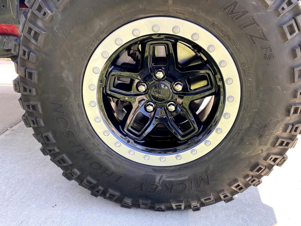

My AEV Savegre IIs don’t stick out. I like the tires nice and tucked under the flares.
17x8.5 with 5.77in backspacing (+25mm offset)
