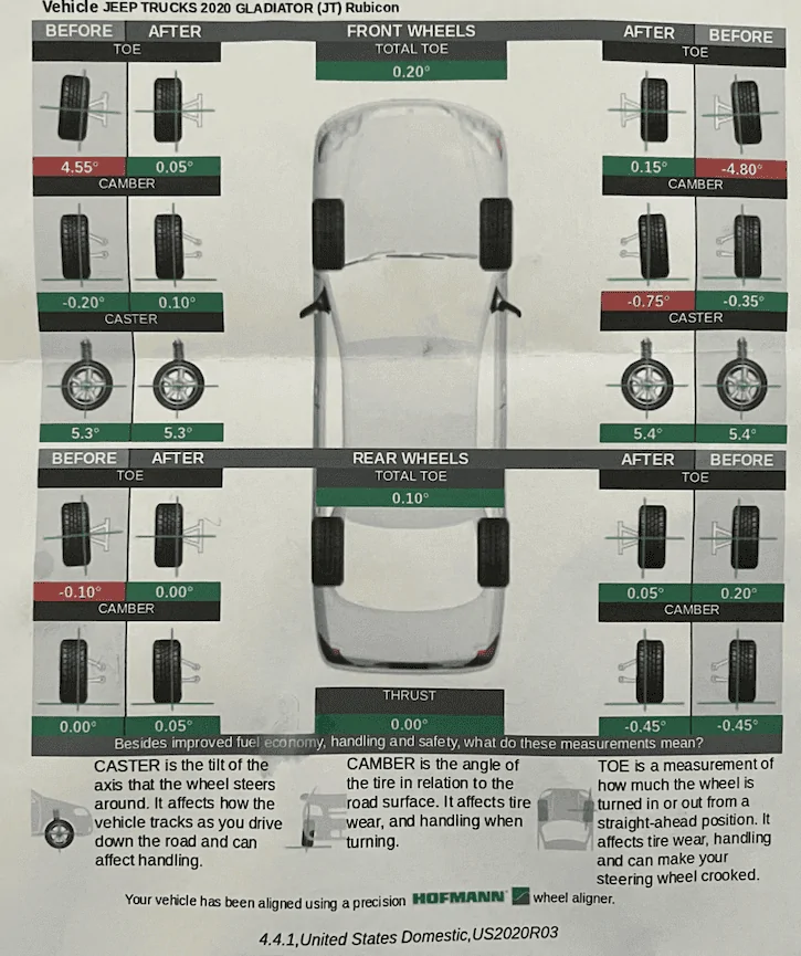

Mine pulls after the swap. Nothing else changed and it's not play on either side of center and the pull has grown. Alignment is ok.

I had the dealer take care of my Gladiator ’s toe in when the stearing box was rep,aced under the recall advisory earlier this year, they sent it to a front end specialist shop to have the front end alignment done. Solved my pull to the right issue.
cheers
Looks like 0 toe is desireable, then? Mine doesn’t pull and doesn’t really wander but I feel like I could get a little better feel in the wheel. It is toed in slightly from what I remember when I checked it a year ago. Maybe I’ll crawl under and get it to zero and see what that does.
