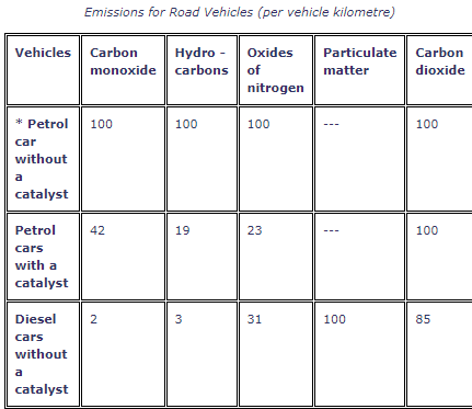

No matter what don't blame manufacturers for problems we are experiencing due to unrealistic restrictions being thrown at them by the anti-science anti-engineers at the EPA and CARB. They are doing the best they can to provide the products that we want and need. Rather than complain we need to do everything we can to work around and solve issues being created by these unrealistic parameters.
Attached is an article showing how much they have been repeatedly and endlessly forcing these regulations onto these platforms. If anyone can find specs for light duty please share. These are all educated discussions and facts we all should be having and aware of.
Note** That in 2001 diesels were only producing 25% more NOx than gas motors. Also note that per the EPA by the time that Bush was President we had already cut auto emissions by 99%. All regulations since have been to cut fractions of 1%. These regulations are no longer about clean air and just about Crony Capitalism and controlling the means of production. If you surrender we will no longer have the freedom to purchase and drive what we want. We will be slaves to the electrical grid, which is already stretched beyond it's means and abilities.
As far as soot it is good that it is being regulated but the fires and BBQ'ing is producing far more soot in our atmosphere than all the diesels combined by insane proportions. These regs are a handicap, don't let them win.
https://dieselnet.com/standards/us/hd.php
