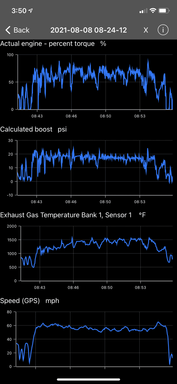

Went and pulled some data logs while towing this AM. These numbers will SHOCK any diesel owner... I totally understand what is happening now, and why we are all seeing different oil / coolant numbers when derates happening.
Here was the test.
1. Load up my camper and truck and take it to a scale to get an accurate measurement of weights. With the weight distribution hitch, myself, empty bed, basic tools, full tanks of DEF / Fuel.
  1. Jeep Weight : 6240 LB (close to max payload, with 1 person, and no camping gear in bed!)
  2. Trailer Weight: 3140 LB (about 50% of what it should be able to safely move)
  3. Trailer Frontal Area: 48ft apx...
(I have the PDF for the weights from a CAT scale if anybody is interested)
**** (This has a weight distribution hitch involved some some of the trailer weight will be transfered to the truck. Likely 450lbs with the way I have things setup)
2. Drive around town, then up i70 (7% grade starting at 5300ish ft up to evergreen 7700ft apx), capture a ton of details via OBD.
Important details.
  1. Air Temp 72
  2. 5th Gear holding 2100(ish) rpm
  3. 55mph
  4. 40-70% engine torque demand was held (not pedal position, but demanded engine torque metric (from OBD))
  5. Throttle pedal was about 20-40% position.
  6. DPF Soot Load was about 45% (fine)
  7. DPF regen status was 0, meaning not in a regen state.
Findings.
Near meltdown EGT's sustained... During the incline min EGT was 1090, max was 1590!!!!
The big hill climb started at about 8:43, with another smaller hill that was close to the 8:26 mark.
These high EGT's melt piston's, valves, etc. These high temps are UNACCEPTABLE, any diesel builder will tell you, this is an Engine Killer situation. Hope these Italians used titanium for valves and pistons....
I was in the slow lane, AC OFF. I was driving VERY easy, there was plenty of room left I could have pushed a lot harder.

Nice test with data! Did you experient a de-rate?
Egts aren't far off from what I saw in my 2006 Ram 3500 running a stock tune, so I wasn't alarmed to see 1500+.
I didn’t derate on that trip. I bet if I do the same thing later this week when it’s high 90’s I will. :)

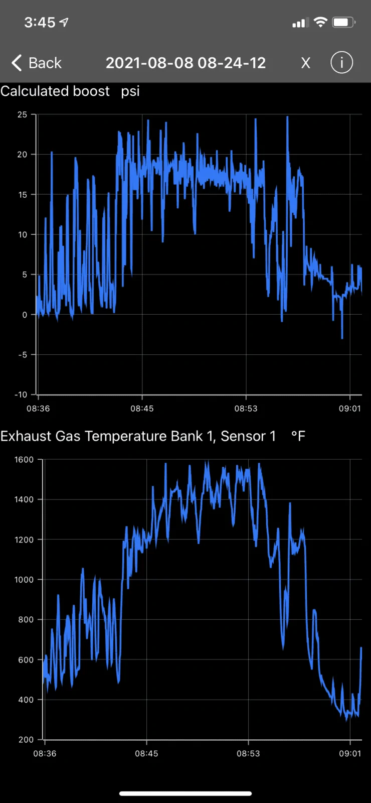

It'd be interesting to see boost vs EGT. I assume it was full boost over the period of increase.

Also keep in mind if the EGT is 1500F (measured at the turbo inlet I assume), the combustion temp in the cylinder could be 2000F,2500F. Who knows ... lots of heat though.
FYI was not full boost over that period. But there was definitely boost.
Jeep Gladiator So disappointed in this Diesel platform; wish there was a return policy. 2932B3E0-B476-4FF0-839C-1C26420891D3
Remember 7% grade, 7 miles
here is with applied torque / speed. This shows I was nowhere near full throttle.
this shows from on-ramp to exit.
