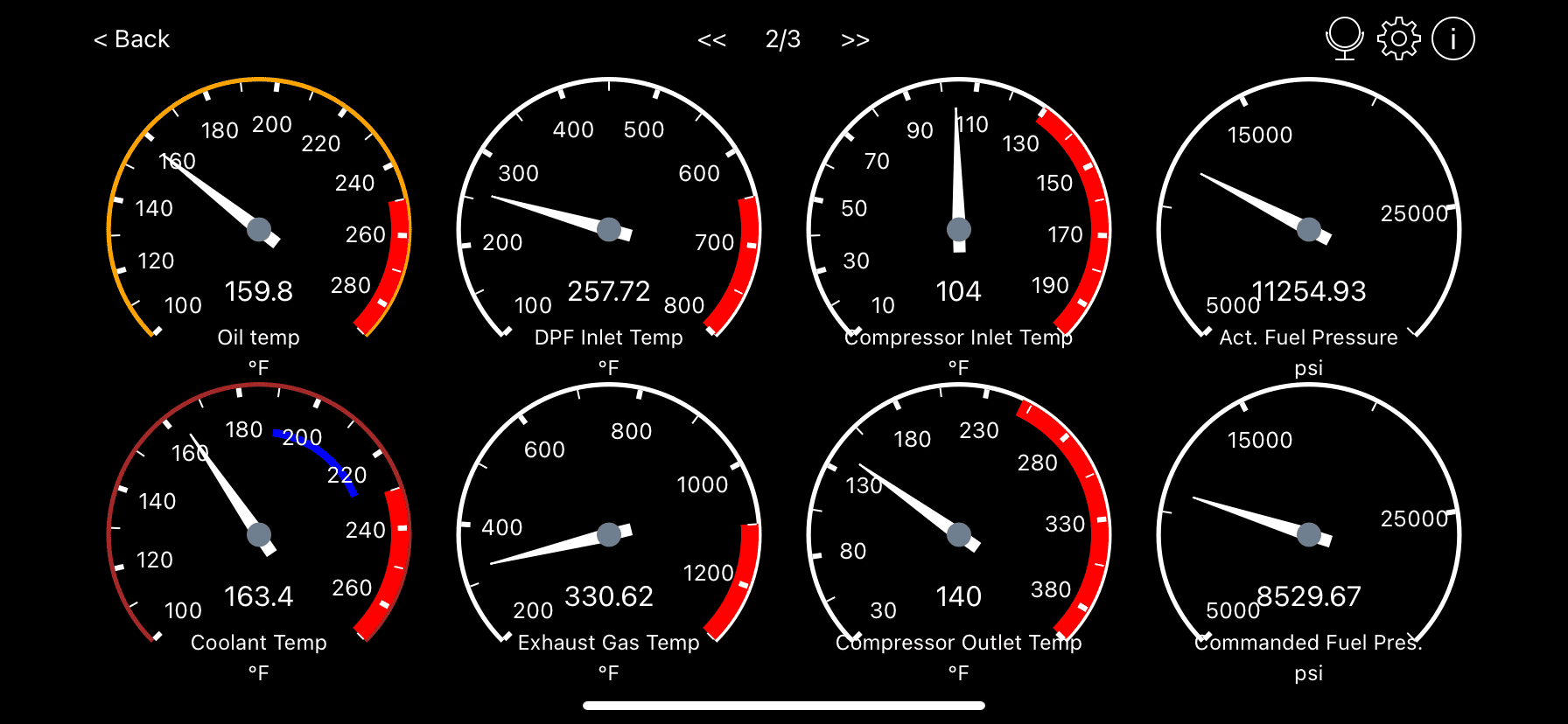

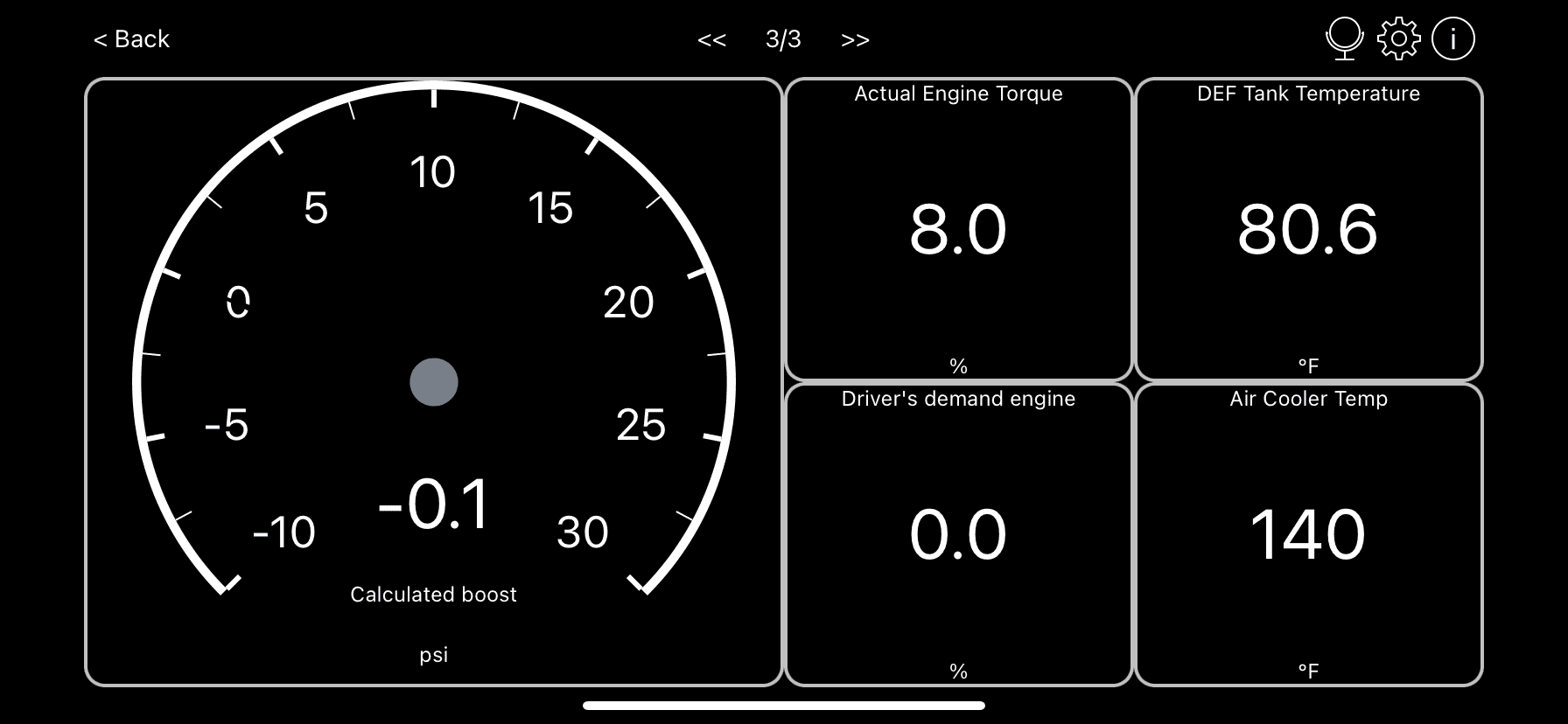

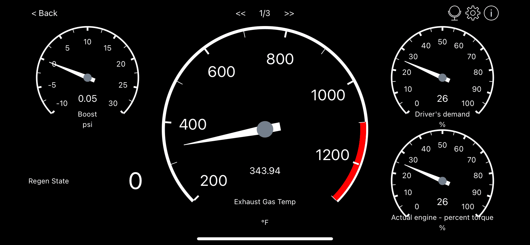

I have been working for several hours to build out some nice temp dashboards to monitor when you tow. I have them mostly dialed in I think...
Go to Amazon and purchase a VeePeak OBDCheck BLE+
Amazon Link (OBD Scanner)
And on your IOS device download this app. (Purchase the full app (PRO) It's cheap, like 8 bucks)
Car Scanner ELM OBD2 App
Then you can import the dashboards I have worked on by downloading this JSON file to your IOS device, and import it once you setup your car.
JSON File including Dashboard Config
(Settings, Dashboard, Restore Dashboard)
You will quickly be able to see Engine Derates, Fuel Pressure being cut.
Regen State (Passive / Active / None)
Turbo Temps (inlet / outlet)
Coolant / Oil Temps
Fuel Pressure (Demanded vs. Actual)
DPF Inlet Temps
EGT's
BOOST
Trans Temp
There is MINIMAL Lag in the Gagues (like sub 1 sec)
And all of this is your's for about 50 bucks or less....
I based the redline's on my testing just data collecting and driving around town.
Cheers (images are when engine is off, which is why some of the metrics seem weird.)
Also, the one thing I am noticing is higher air temps than I would expect compared to my other turbo engines. I am betting this might be a cause of the derate.. Meaning Meth might really change things.... or a better air cooler (intercooler) and Oil Cooler.
Coolant / Oil Temps
DPF Inlet Temps
EGT's
BOOST
Trans Temp

Thanks! Hope a few others can use it to start to diagnose what triggers the derate! Many cases I have heard of derates occurring post shutdown which indicates heat soak, but the oil / trans / coolant temps do not align.
I am really starting to wonder about charge air temp (post intercooler temp), as if that is too high issues can occur.. If that's the case a meth kit might be able to change that dramatically.
