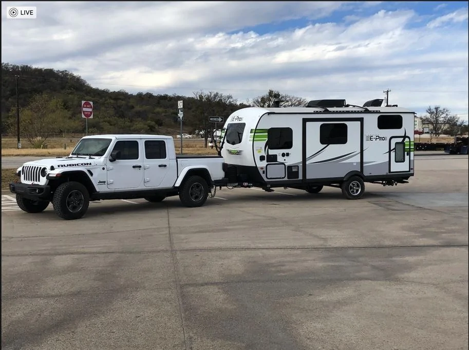

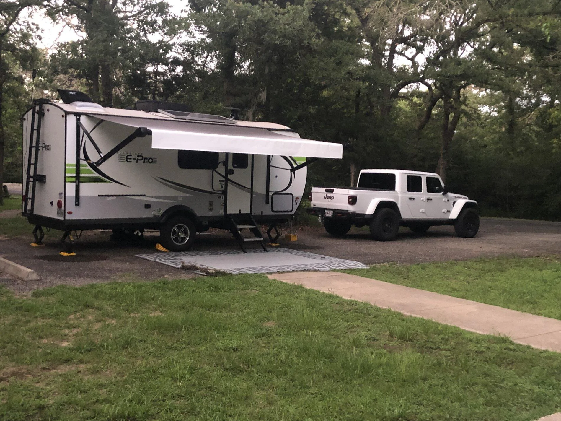

Nah, looks worse than it is. NOBO's, e-pros/geo-pros, and some of the Winnies are pretty light. My e-pro is similar, all aluminum build and is ~4000k lbs dry, probably around 4300 with batteries, propane, some water in the lines, silverware, etc, and ~4500 lbs ready to go camping. It could be a little more or less.. I have not weighed in yet, but it's just the wife and me and we pack light.
That said, I would never tow mine without a good weight-distribution/anti-sway hitch (I use an Anderson style). And of course a brake controller is mandatory. But, I have zero stability issues and can comfortably drive with one hand and relax (minus the occasional semi blowing past me doing 90). It's not an F350 obviously, but it's not bad really.
Now, you are pulling a wall down the highway, so the faster you go you will feel it, and your gas mileage plummets, especially on hills, but anything at or below 65mph is a breeze (unless of course it's hot outside and you are on hills).
Mine is 22ft. Notice how bad one angle makes it look. Also, in one photo I have stock 33" tires on and no weight distribution (was bringing it home from the dealer). You can see it sag, and it was sketchy driving it home on bumpy back-road highways. I don't have a pic handy of it with weight-distribution, but there is almost no sag.
