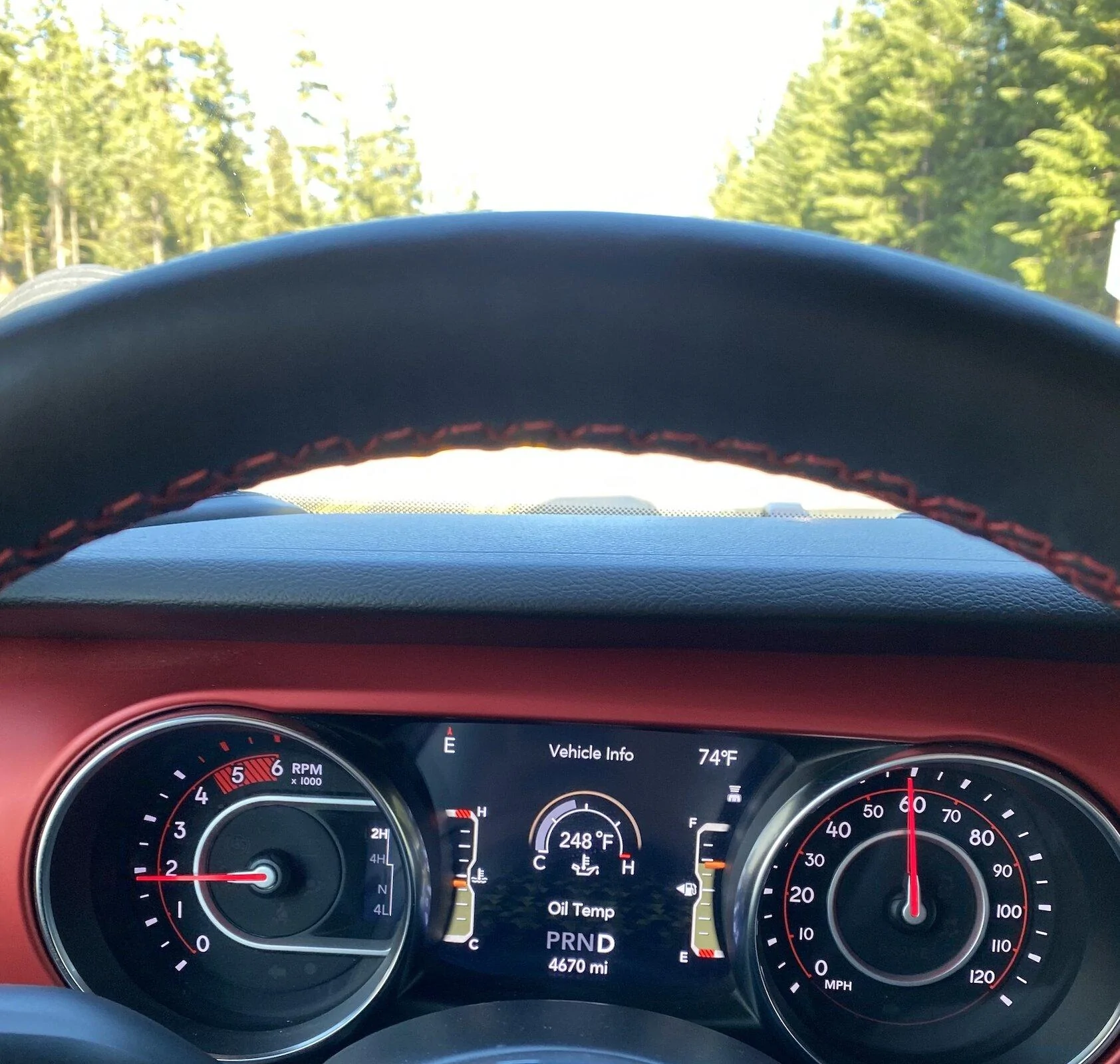

Yeah, that’s not what I’m seeing with my JT. I’m seeing much higher oil and coolant temps before a derate.
Are you running hot on your trans? Also with the 35’s are you bouncing between 7/8 a lot?
Fyi, I’ve had mine to 12100 ft altitude and don’t see derates.
Your coolant is likely at 220 in that photo by looking at the vertical gauge.
I would try driving in manual ‘mode’ and see what happens.
Again this isn’t what I have experienced so far.
I wonder if your issue is DPF related, or fuel quality issues.
Also I see your adaptive cruise was enabled. Turn that off and see if that helps.
maybe fill up at a different station?
That vertical gauge will read like that all the way from 180 to 230. Ours was running 230 on the way back from CO and the gauge in the cluster never wavered from roughly 1/2.

So after we returned from our trip, I started tinkering. Ordered the SB hood scoops, Moved the Horns... Here is a pic of the dash, derated, heading up Mt. Hood recently... Again, family of 4, and gear for a week road trip.
I do have 35in BFG AT's and a tazer to set the tire size.
You may have something else going on. I have not heard of anyone derating without towing a load, especially in cool weather. So unless I'm wrong, or unless your family is bringing gold bars and your tires are flat, I'd take it to the dealer. Because I really, really hope we are not derating just driving around. If so, I'm out.

This is such an interesting thead. Again I will say I Love my diesel Rubi. I don't really know what all this "towing" you guys are talking about. My vehicle will derate at the drop of a hat, on a slight incline. Few weeks back we headed to Moab. Idaho is tough because the speed limit is 80, and people want to go that fast, and the hills are steep. I lost power a 5 or 6 times in Idaho and Utah... Family of 4, with our stuff for a week long vacation... that's it.

I should have took pictures of the other temps... always forget to pull up ORPages ;) Coolant temps were 212-218 usually, and the trans never ever seems to get hot. I use ACC in the lowlands, but I like to use my foot in the hills, so it was indeed enabled, but not active. Oh and in regards to the 35's, I was worried that it would be shifting all the time, but it doesn't. I just seems to want to hang out in 8th, unless I ask it to go, and then it shifts down and goes.. unless it decides to derate :(
Assume you meant DEF, not DPF? (not snarky, just making sure don't know what DPF is?)Yeah not sure about DEF, lot of reading about what is best, but no clear answer, so I just use whatever is on sale, with a new date, and clean packaging.
Fuel? Could be it... I don't fill up at the same station every time, especially on the way to Moab... I run 76, Walmart, Fred Meyers, Shell, and Sinclair...
Good Idea on trying the Manual shift option, I can give that a shot.

Man! Tough that this is happening for you, also yes, curious if your diesel particulate filter (DPF) is getting clogged up (maybe an active regen (Dealer invoked) is needed?

If you're derating while not towing a load, I would certainly take it back to the dealer. Your coolant/oil temps are way lower than what I've seen/experienced when mine started to derate.
