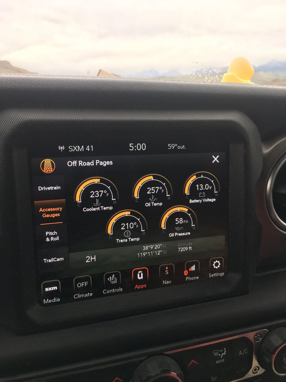

Agreed, when I purchase any towing vehicle I always aim to only tow up to 60% of the max tow rating. Longevity/ vehicle stress are real concerns.
I started this thread due to the stark performance differences I experienced when comparing it to my 4.0L Tacoma which has a similar rating. (6400)
Since then I have towed in a few different areas.
- Flat land (up to 60mph) is great.
- Small hills are fine, (less than 3min of higher load levels) it does warm up.
- Long climbs in the mountains on hot days does require I do not run a/c and it’s better to blast the heater. Also stay sub 48mph.
Images that show the hot temps/derate at the beginning of this thread are towing well under the max, and comparing it to the Tacoma 4.0 when climbing Colorado mountains.
I stick by what I said. If towing is your concern in Colorado, in the mountains, performance is better in the Tacoma.
If we see an IKE video, I bet the taco spanks it up the IKE.
I can say flat land the eco diesel spanks the Tacoma, up to about 60mph.
Remember the Jeep has bad aerodynamics.
The torque is real, but my disappointment was climbing hills here in Colorado (where I live, and where I tow).

Am I reading this correctly?
I'm trying to be nice here and not call a spade a spade.
No wonder temps are pegged.
It’s a spade. However, people are reporting high temps when general towing under spec in above 80 degree temps. Just sharing my experience. Just pulled 10-11k lb in 60 degree temps and she didn’t squawk at all. this is from one of the big grades on HWY 395 south called Conway summit. So, I just wanted to share that it seems the issue is more with outside ambient temperature for temp spikes. Obvious, I know. But, it is good to narrow down and then figure out a solution. I am eagerly awaiting the GDE and banks tune.
Ambient temperatures are certainly a factor, but I think long steep grades is causing the most problems. I was towing my travel trailer in 117*F and had no problems, but the high flowing front grille is big on the 2020+ Ram EcoDiesel compared to the Gladiator.
I know what you mean. I live at 7,000' feet and tow all over the mountain west. For reference, I've dropped the speed down as low as 28 mph when towing over Wolf Creek Pass and Ike Gauntlet with the EcoDiesel. That's the best way to keep the temperature down.
