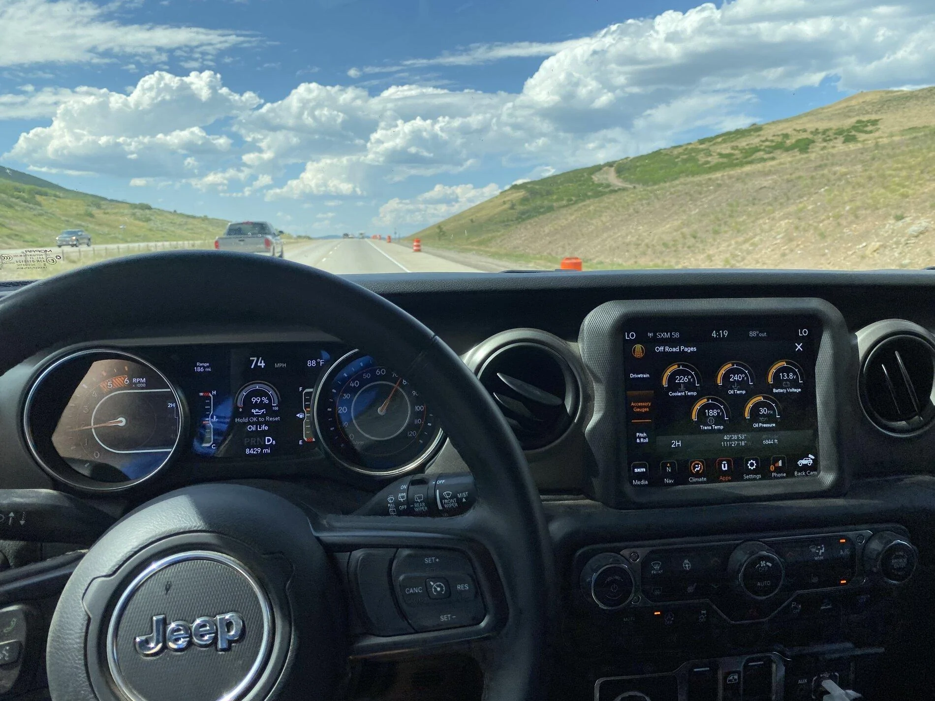

Glad to hear it. I'm going to give it a go towing again tomorrow. I plan to leave earlier in the AM to try and beat some heat but it's a 4 hour drive so I'm sure it will reach the 90's towards the end. Got a fresh oil change today after my cooling troubles last weekend while towing. The problem is, the speed limit will be 80MPH where I'm towing tomorrow so the 50MPH range is just not safe. I'm going to try to keep her at 65. I still reject the notion that I should be OK with having to blast my toddler with the heater in July just for my jeep to be able to tow a small trailer at highway speeds.
These temps are from today, NOT towing, but it WAS a pretty good hill.
Thanks for showing us your screenshot.
I noticed that you had your AC on “LO” which is max cooling. Any reason you did that instead of using the auto temp feature? If I do that on mine I freeze myself out of the Jeep, even in the low 90’s we’ve been getting around here… I’m also wondering if you have the ceiling liner panels on your ceiling? They make a huge difference for us…
