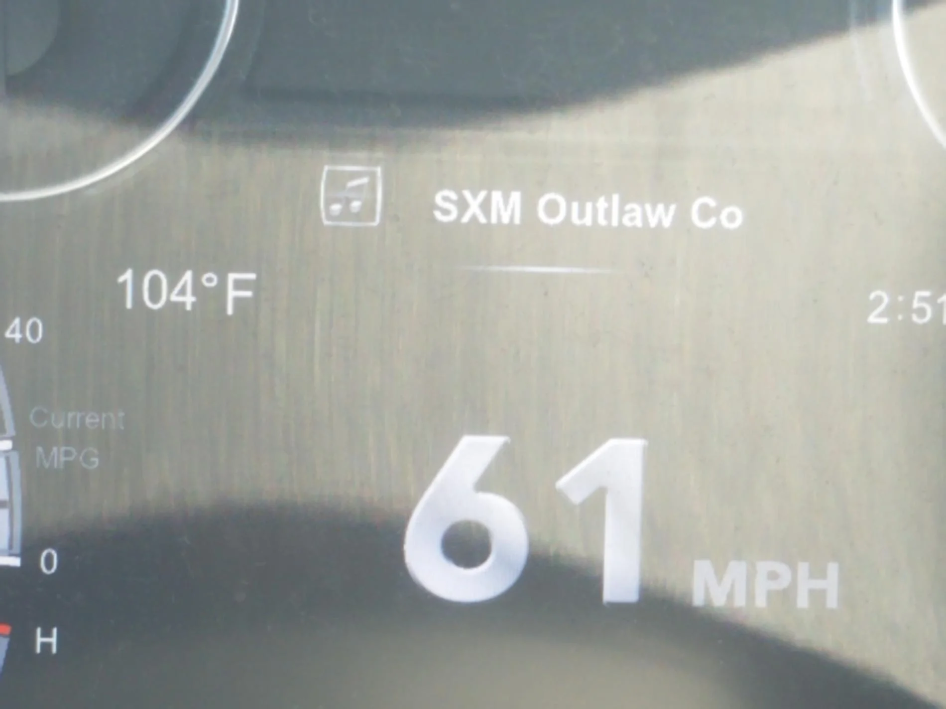

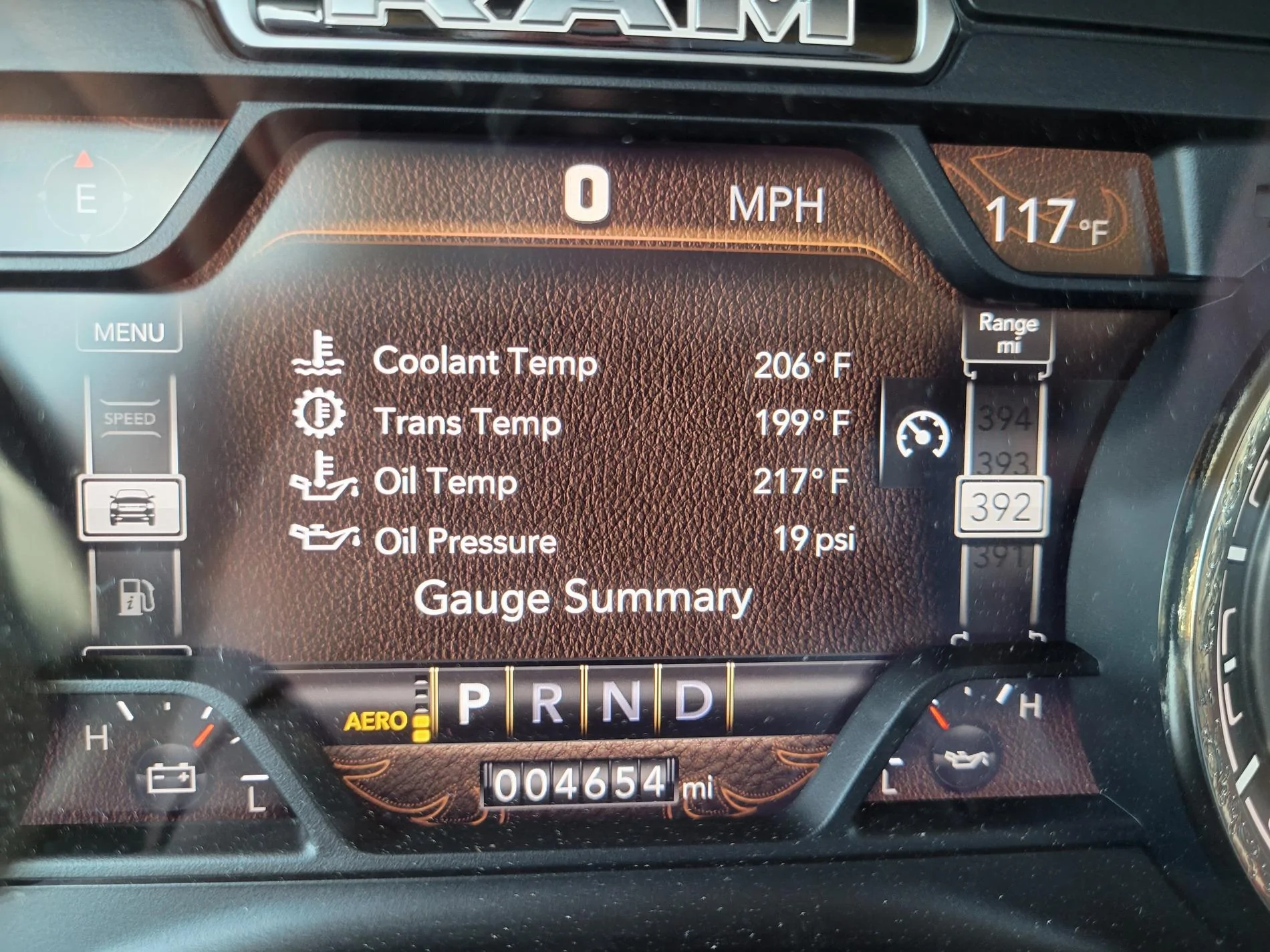

These are the hottest temperatures I've towed in with my two trucks. The key is to slow down!
2015 Ram EcoDiesel - 104*F
2020 Ram EcoDiesel - 117*F

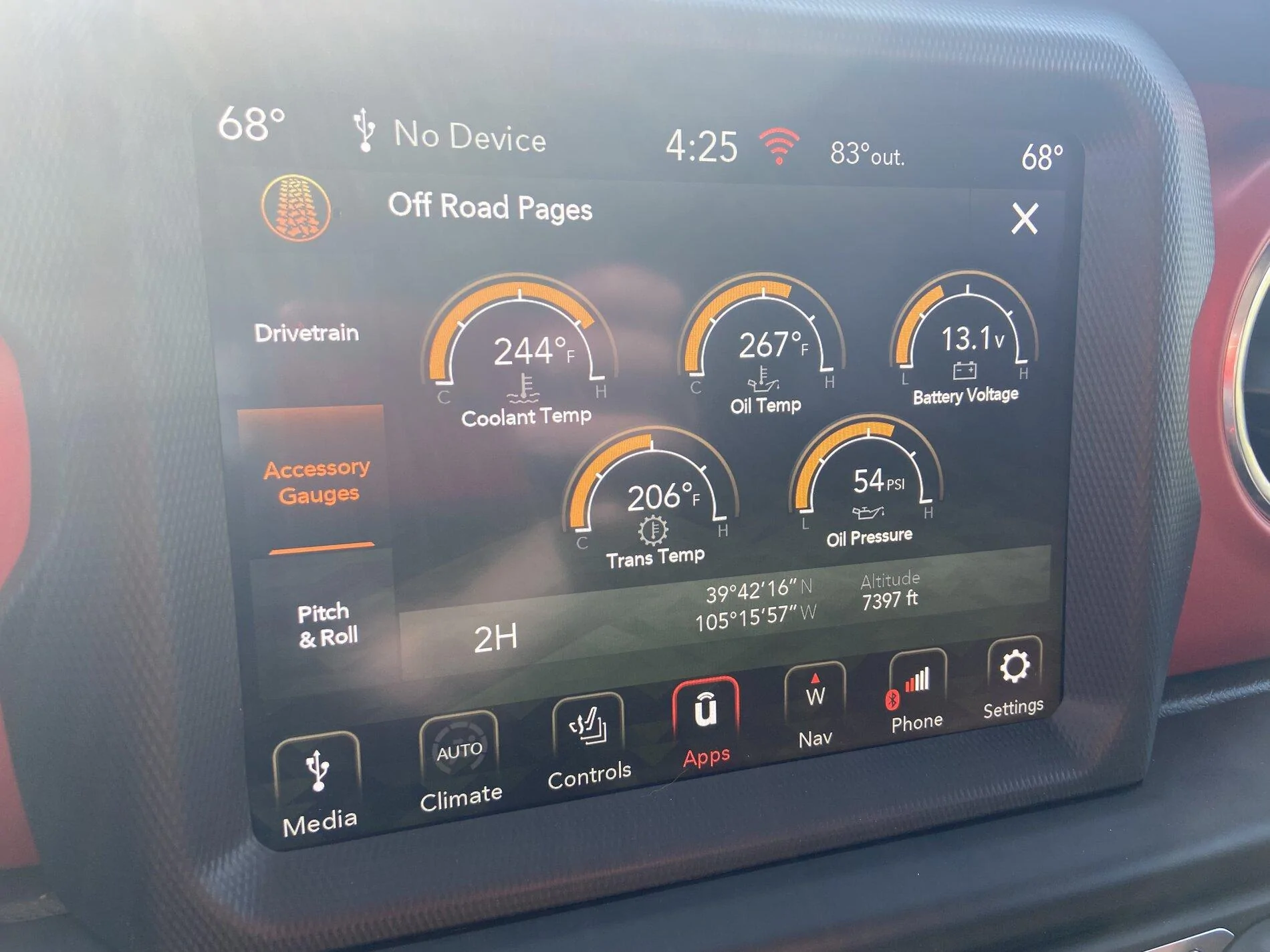

Mine derated much sooner than those temps. Once it cracks 233 water or 255 oil I lost power.
I can only "slow-down" so much. Would barely do 55MPH at some points on an interstate that is signed 80MPH. I was a hazard to others. I do not believe I should have to purchase a full size truck to tow a low-profile teardrop trailer in the summer. My expectations are inline with the job I'm asking the 3.0 to do as it corresponds to its rated and stated capabilities. Throw in the exorbitant prices of Jeeps, especially diesels, and a material disconnect can be plainly observed.
I'm a little surprised they're pulling power with an SAE40 oil around 260F. My thought when I saw my 3.6 oil above 250F, "That's a bit hot for SAE20." But for SAE40? Wow. But then again, modern mil spec helicopter gear oils I'm familiar with are comparable to SAE20, if not even thinner.
The coolant temp is a bit more understandable. I wouldn't want my coolant anywhere above 230F for very long.
It seems for you diesel folks, a larger radiator for the coolant and or oil would be useful to help avoid the limiters. Or at least reduce the time spent in that scenario.
Both systems effectively remove heat, but coolant is twice as efficient as oil. When either is beyond its thermal envelope, the other has to carry the remaining heat load.
