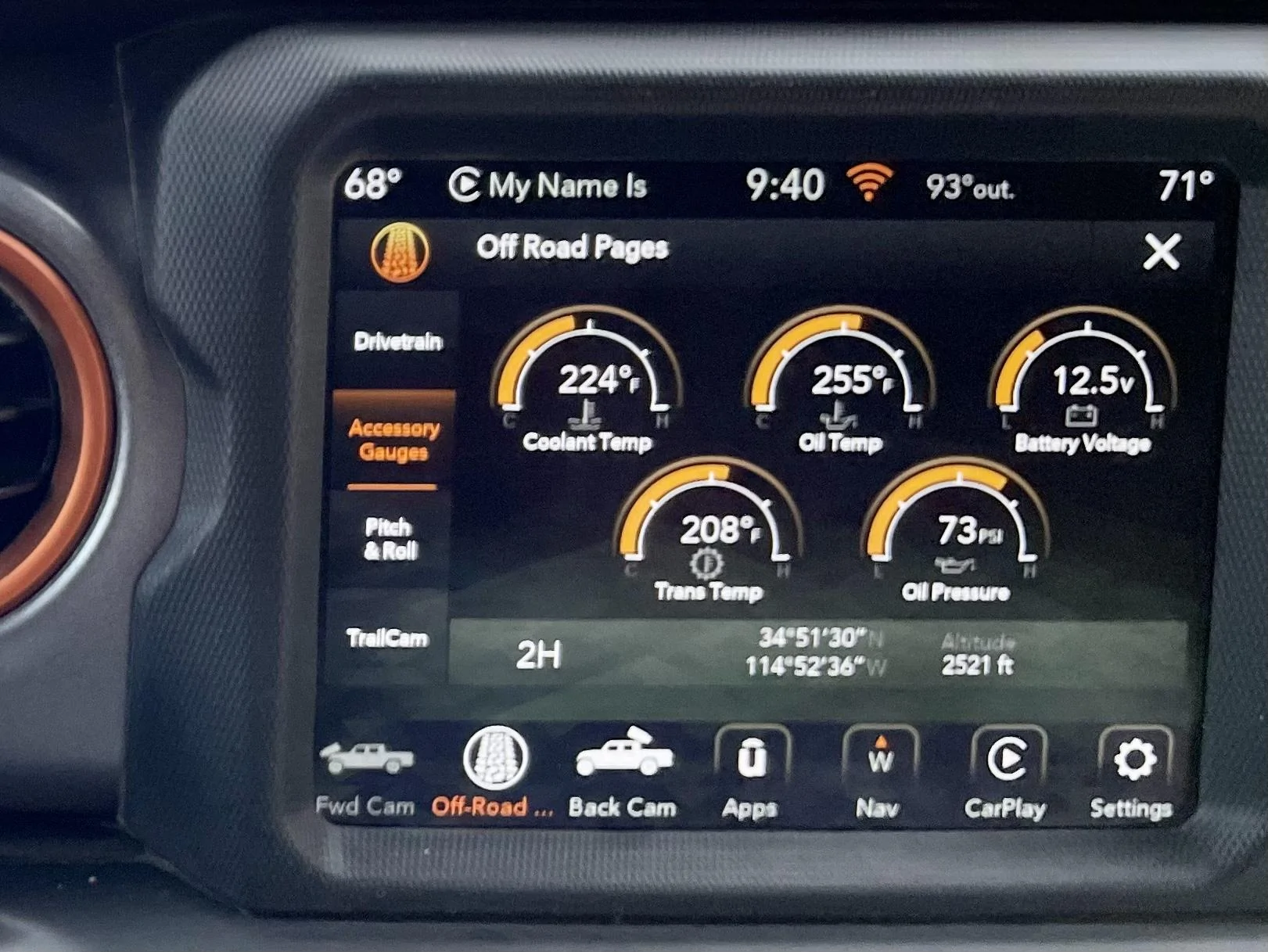

These temps don’t seem terrible to me. A little hot, sure, but it’s a diesel with hotter combustion temps.
For reference, here’s a pic from this weekend of my Mojave towing maybe 4,000lbs on a 6% grade. Just sitting full throttle at 5k RPM, with only 2400 miles on it. And this is with the Mojave’s “heavy duty cooling system”.

So I'm curious if anyone has actually determined what is triggering derating? Is it the engine temps, the oil temps, the transmission temps?
I personally would lean towards the transmission temps as transmission fluid starts to break down "varnish" around 220 (from my limited googling). Anything above that and the internets say it dramatically reduces the life of the fluid. And browsing other diesel truck forums with similar issues, they mostly seem to be upgrading/adding transmission coolers.
Could it be the turbo temps? We don't see those without a scan gauge, but maybe that could trigger a derate as well?
Just for reference, my 2015 EcoDiesel will derate around 244*F coolant and/or 266*F oil temp.

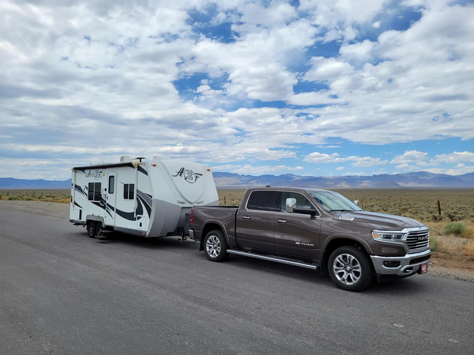

TBH I think it’s restricted airflow. The Ram with the same drivetrain is not having those issues.
Correct, I've driven my 2020 Ram EcoDiesel over dozens of mountain passes with no overheating issues. My travel trailer is 8'6" wide and about 7,000 lbs.

good catch, i didn't notice units on my display, will check again when driving, usually it runs around 88-90 which when convering from c to f would be 190-194 f, so the hottest i saw of 112 would convert to 233 f
i am in Canada and every other dang thing is labeled in metric etc.
also my a/c was running was well, it hasn't really turned off, bit of a heat wave, gonna edit original post as well with this response added
Nice Arctic Fox camper. We had a 22H and it was great!
