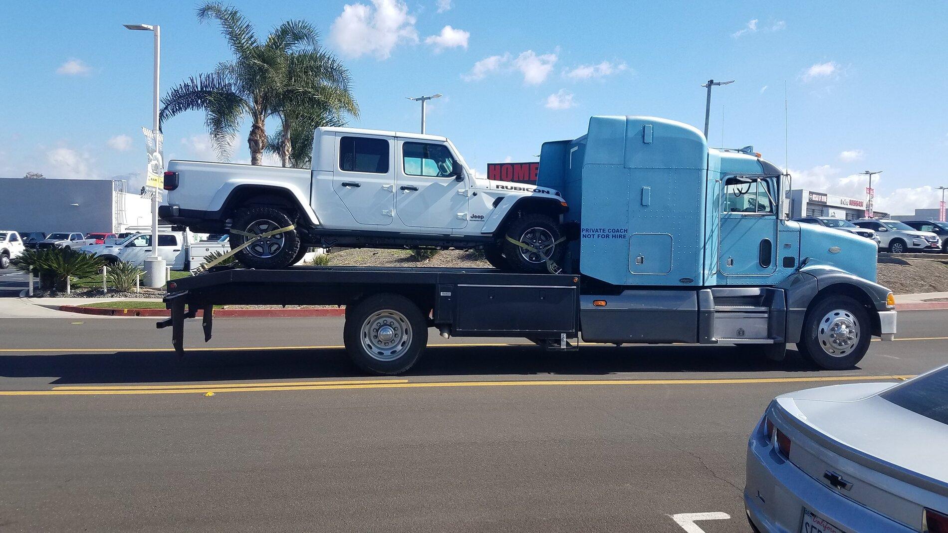

Jeep Gladiator So disappointed in this Diesel platform; wish there was a return policy. 20210212_114216
