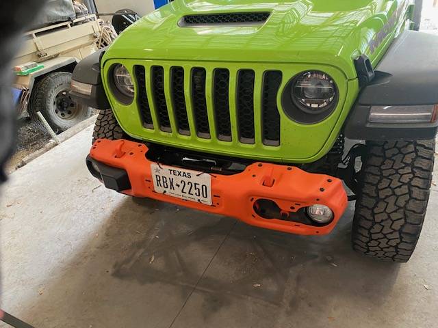

I have the MP Concepts aluminum bumper. Plastic bumper weighed 35 lbs coming off; MPc weighed about the same going on (39 lbs with winch fairlead and fog lights - around 37 lbs without the fairlead? 32 bare metal with no brackets or fog lights). The end caps definitely come off. Design is exactly the same as the Mopar steel and works the same.

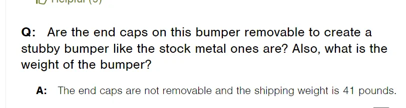

The O.E steel can be run as a stubby. There are cheaper versions available online for like $489.00 with a winch plate. The finish will not last so I would paint / bed line for longevity. This version is Aluminum which may be lighter? Never did find a weight for it when I was looking.
https://www.extremeterrain.com/mp-c...-forged-aluminum-front-bumper-j134510-jl.html
I have one of those bumpers. The one I got I ordered through eBay. It's been on the Jeep since October been through winter and so far no signs of rust anywhere. Luck of the draw I suppose. They are well built and beefy.
