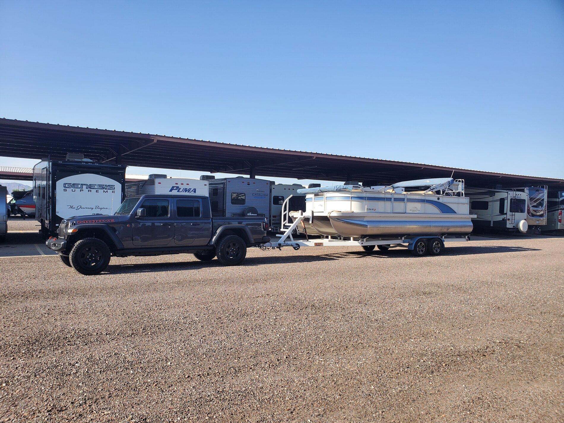

24 foot Bennington Tritoon. Definitely pushing the limits but I don't have to drive on any freeways. I have a WDH w/ sway control on order. Even in 115 degree heat going uphill the engine/tranny temps don't move much.
