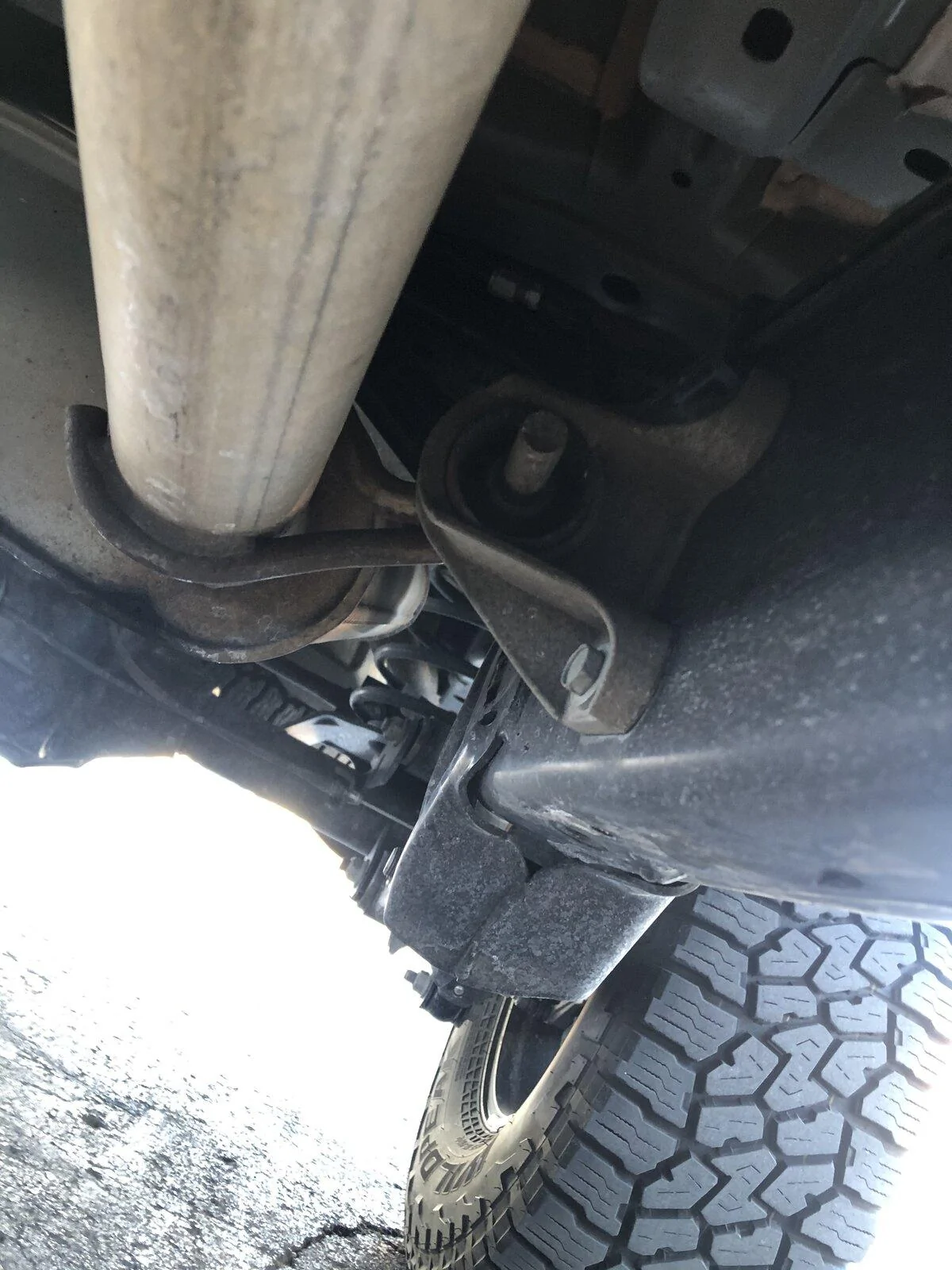

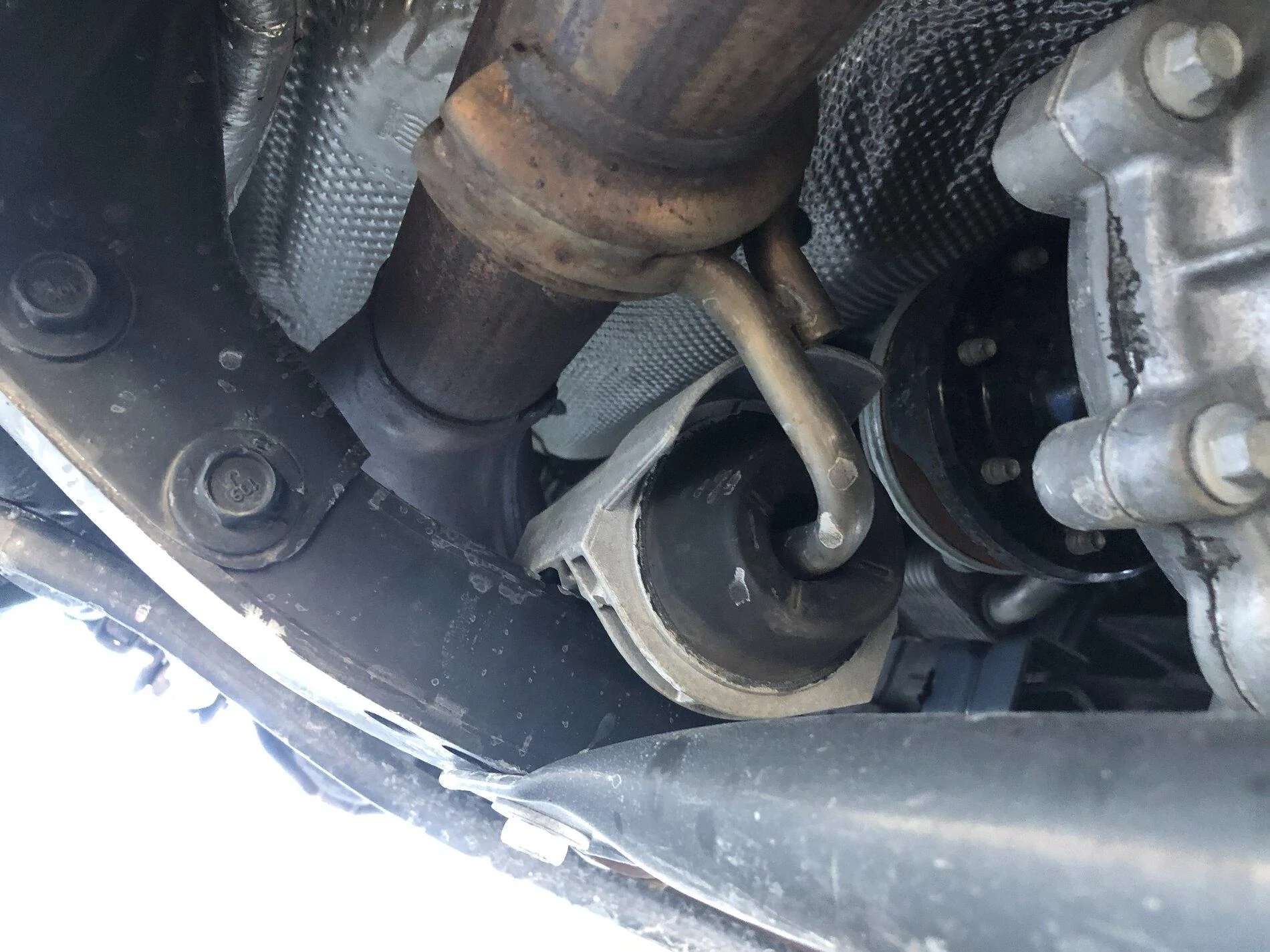

As far as the most recent noise (in the posted vid)...It most certainly was the grommets that hold the exhaust hangers...can’t believe It would make a noise like that (similar to a blown shock absorber going over bumps is what I heard)...but crawled under today, hosed down the front and back of the first two hangers with WD40( just temporary to prove it out, gonna put a good dressing of marine grade grease on em soon)sort of jossled the exhaust around to work It in....problem solved!!!! Noise gone! First pic is front grommet (looking toward front of truck), second is middle grommet (looking towards rear of truck). Theirs a grommet behind the second that I sprayed but didn’t take a pic as It wasn’t making any noise at all.
