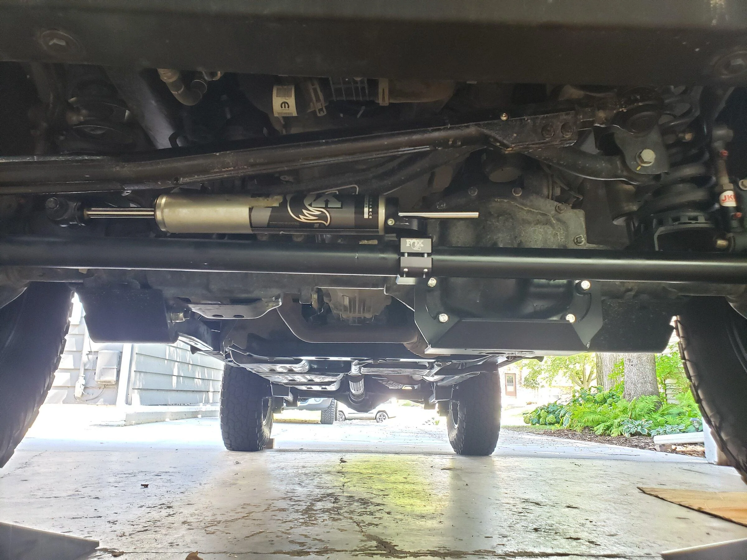

Stock LCAs like what came on my Sport S from the factory. The Mopar kit has extended arms which, in combination with the geo correction brackets, caused the high caster numbers.
The stabilizer is relocated above the drag link.
