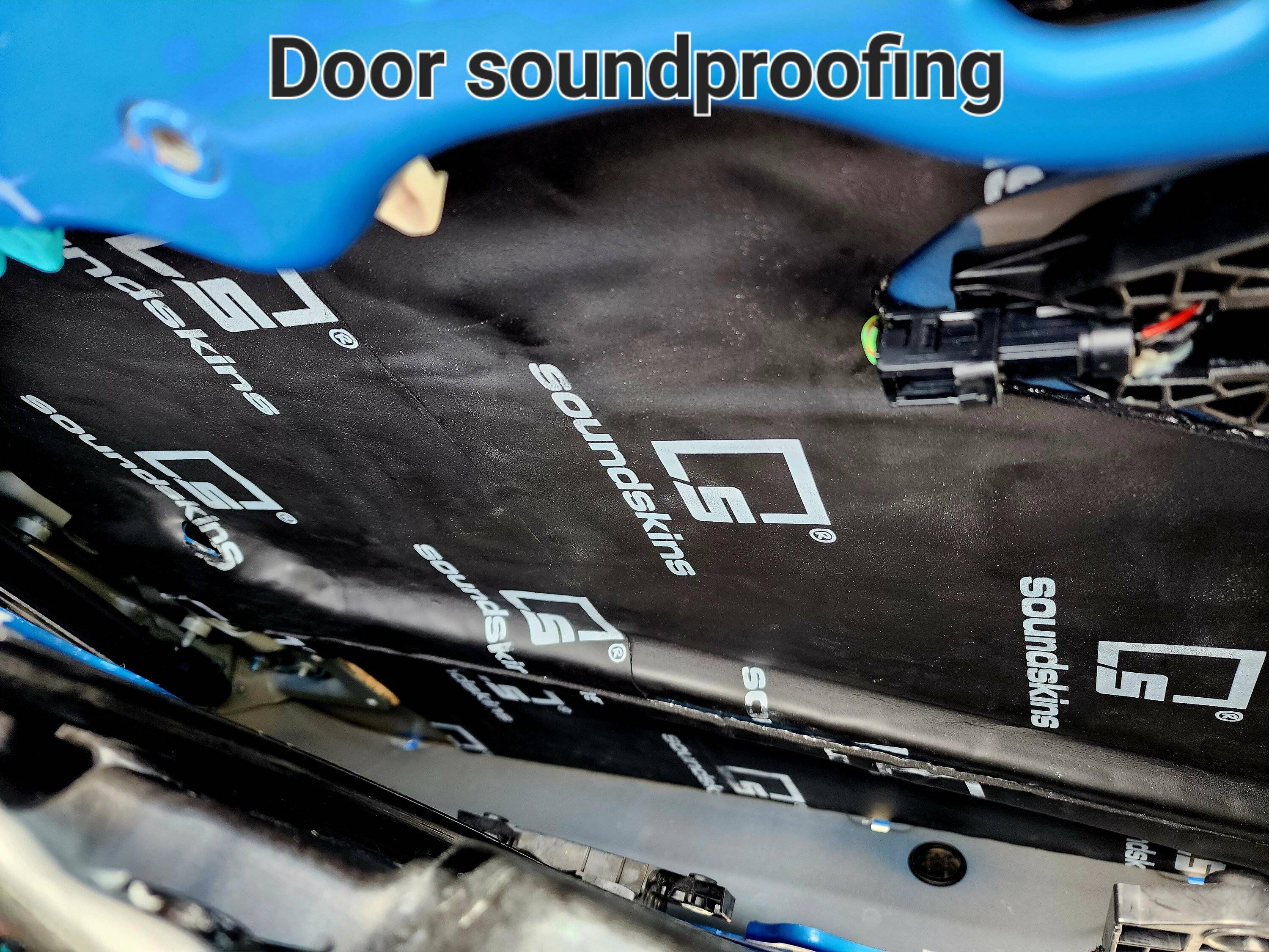

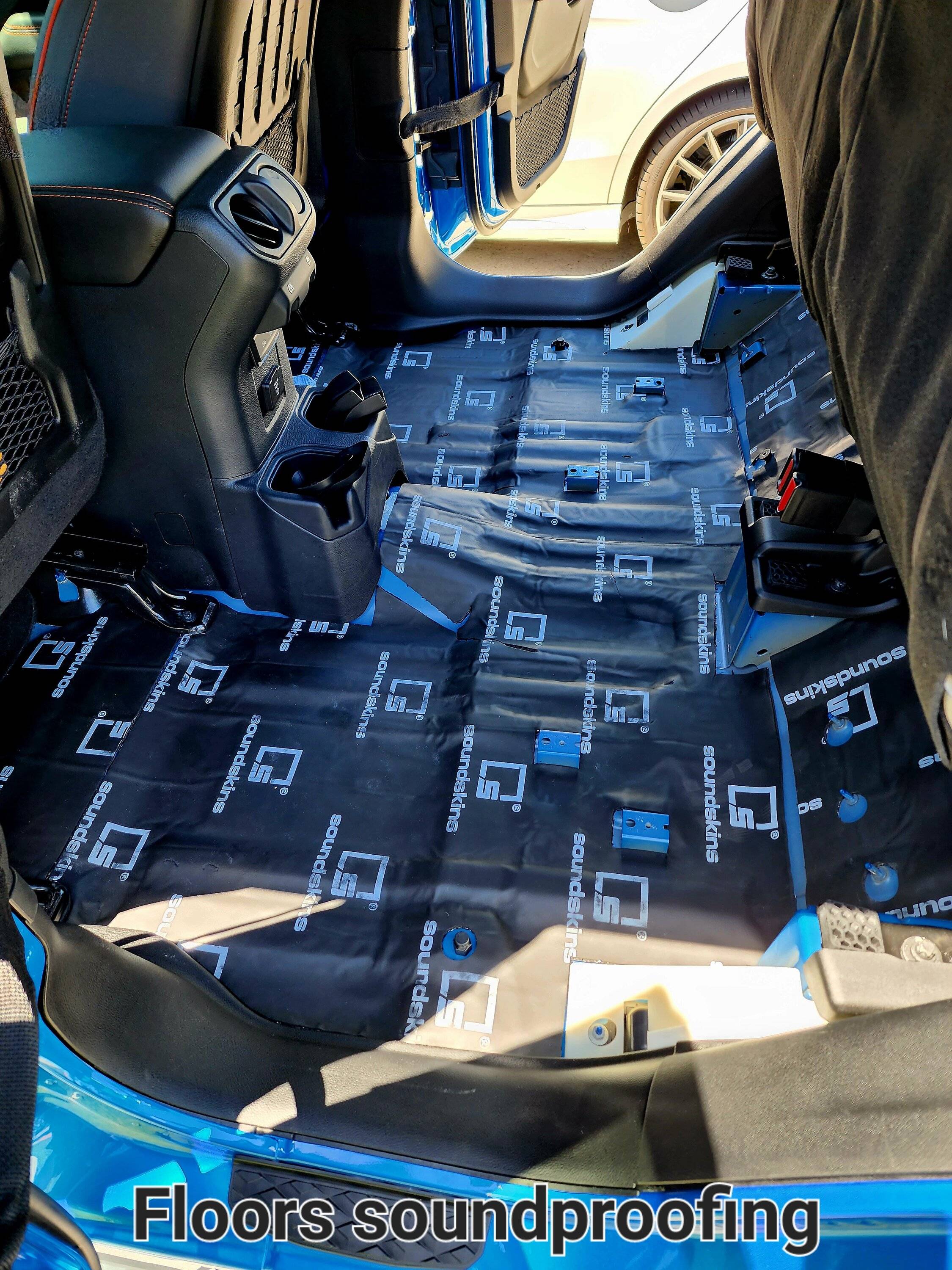

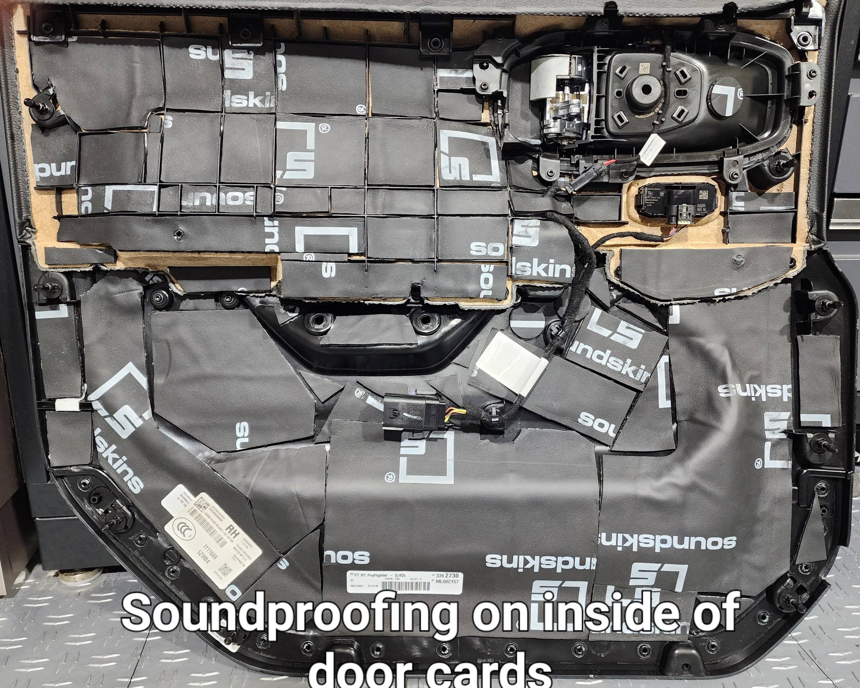

I got ceramic tints on the front windows to match the rear windows, clear ceramic tint on the windshield, HotHeads headliners with Sound Assasin strips, and Soundskins soundproofing on all the floors and doors.
Although I haven't measured the noise levels I can assure you that it's very noticeable. Even closing the doors sounds and feels so much more solid. The ride is so quiet that my wife compares it to her Porsche Cayenne. Even in the South Florida heat the AC cools quickly.
A couple of installation notes on the Soundskins; you don't need to take the seats out of the car to do the floors. Just take the front bolts out and loosen the rear ones and tilt the seats backwards to do the front, and vice versa for the rear floor pans. When doing the doors, it makes it much easier if you divide the precut pieces they send you into 2 or even 3, which makes placing them quite simple. Finally, save all the extra material around the precut pieces and use them to line the inside of the door cards as much as possible thereby giving you 2 layers of sound proofing on each door. This made a very noticeable difference and is well worth the effort.
I'll attach a couple of pics below.
