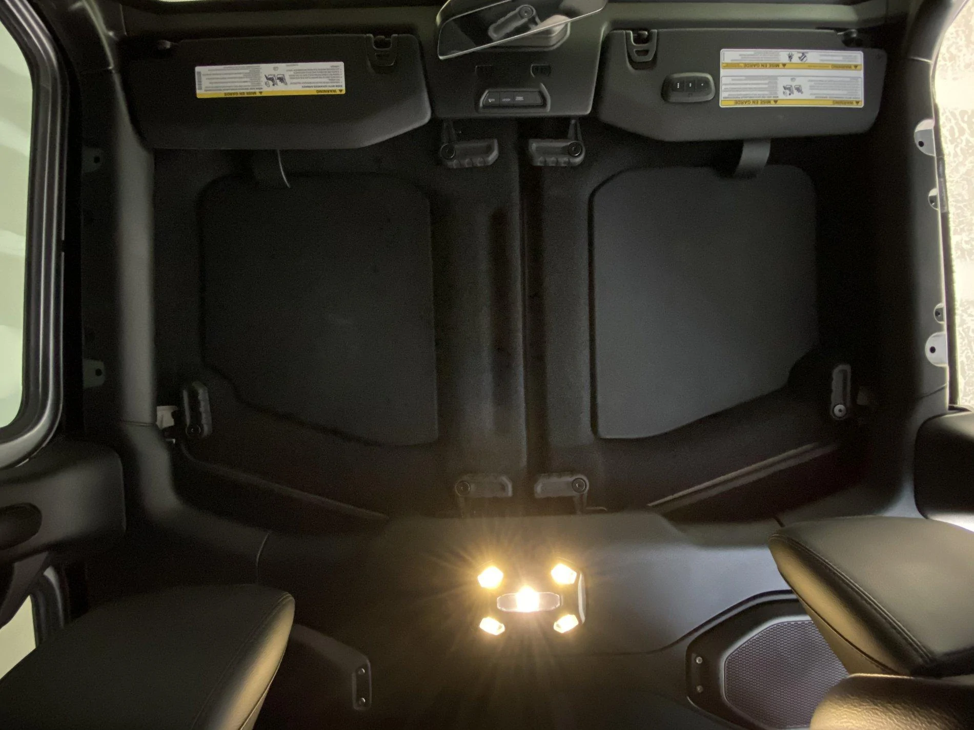

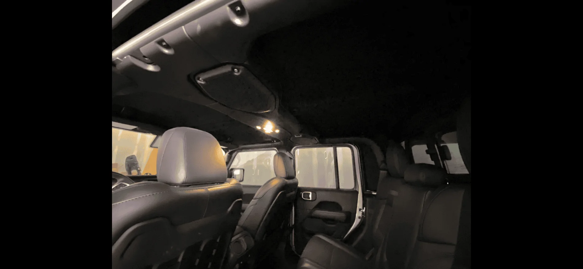

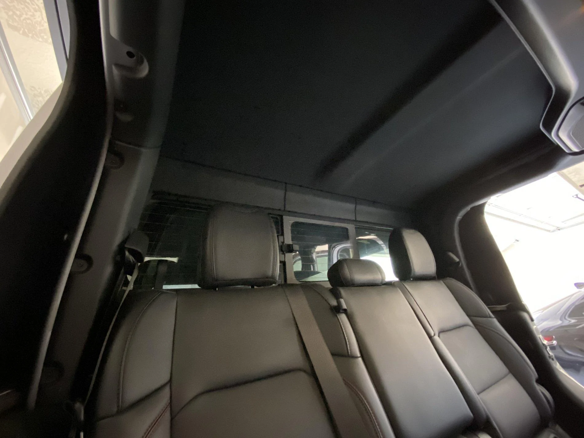

OK turns out I couldnt take the whole top off without taking my ARE bed cap off so I ended up getting a local custom shop to do the work for me.
I also tasked them with re-installing the factory headliner over top of it... because why waste it? The coverking one fits the contours of the top so well, maybe it could work?
So they removed the factory headliner/velcro/adhesive, installed the coverking headliner then took the 'hooks' part of the factory headliner velcro off the headliner pieces themselves and replaced it with the 'loops' that are normally stuck to the hardtop and it worked.
Double headlined and doesnt feel bulky. Sound is improved from the factory headliner only but really the temperature insulation is most impressive. Especially with the 5000ft high desert utah sun. Quality of carpet is OK- not super high end feel but what I would expect for the price point. I don't look up that often anyway so I haven't really thought about it living with it now for a month. The back is mostly covered by the factory headliner anyway which feels more 'finished.'
Overall I'd say it's worth the money. If you have the factory headliner- know that you can reuse it by reversing the velcro, so don't toss the 'loop' strips that are on the hard top
(sorry pics are a bit dark- hopefully you get the picture)

Thanks for posting that. Looks really good. I really like the idea of reusing the factory headliner on top of the coverking.

It looks like you can't see ANY of the white top once the liner is installed....or did you paint it first? Just wondering if I should paint around the edges before installing.
f2f46
f2f46
Nov 10, 2019
105
Utah
I did not paint. The carpet kit does a great job covering all the white parts that are exposed.

I just finished installing hotheads a couple hours ago and was thrilled with it until i saw this.
that looks factory and way better than the hotheads. Mixing this with the sound assassins (if they would fit) would be awesome. I Cant believe how clean that looks.
