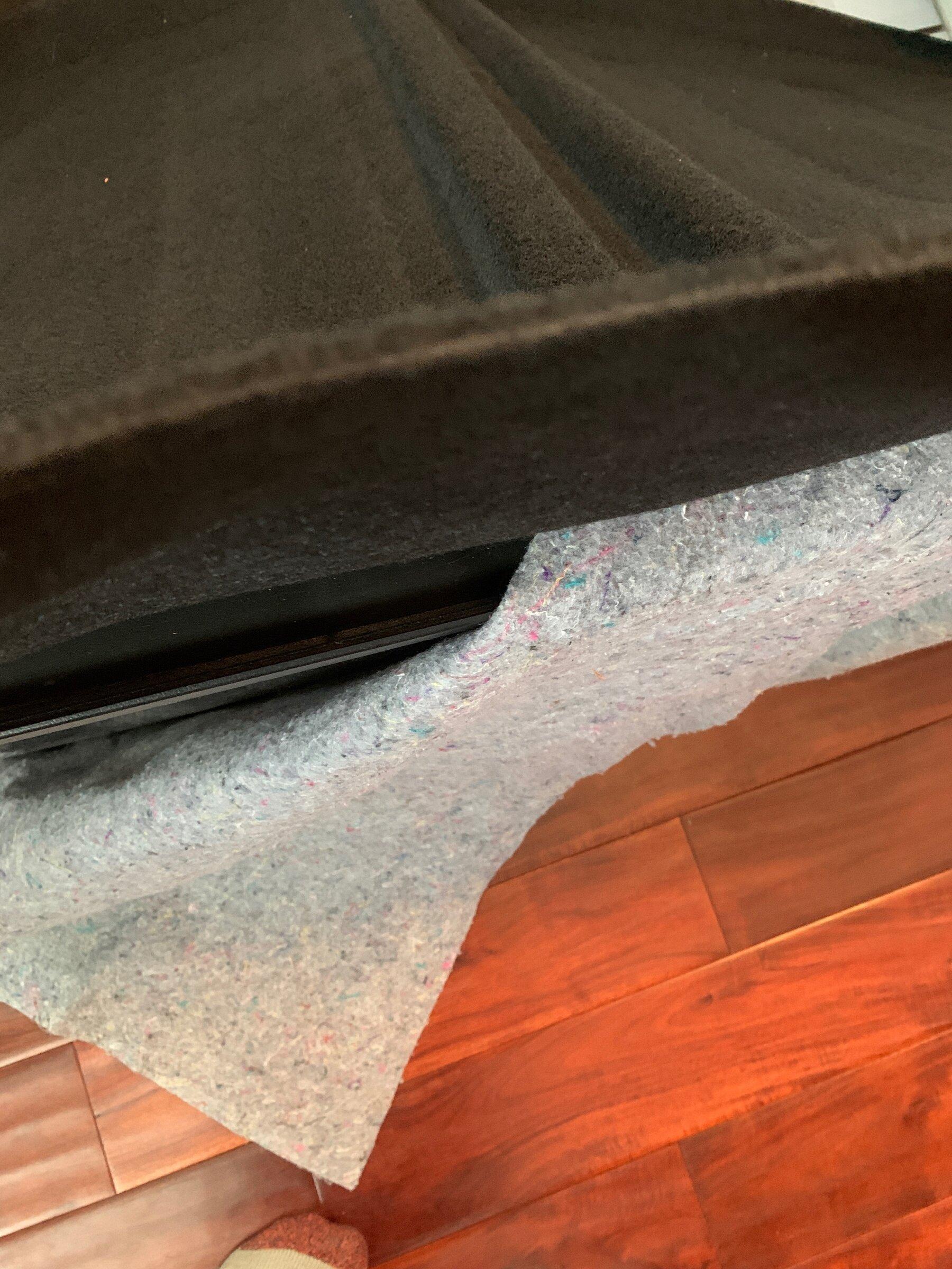

I just got my topliner in and was surprised at how plush and dense the material is. The odd thing is it looks thinner in some of the JL oriented videos from awhile back, I was expecting to nearly be able to see though it but no chance. I can barely see any light from my iPhones flashlight coming through pressed directly against it. Looking forward to the install over the next few days.
I'm going with thin 50 mil sound deadener on nearly all of it. I usually use 80 mil but I don't want to disrupt the molded liner from settling down nicely nor add too much weight. I picked up 2 rolls of .5" 3M 300LSE double sided tape to bolster the edge adhesion in areas where they aren't calling for it. With our full rack and RTT, wind noise is pretty significant. I'll post a thread covering the install for sure.
