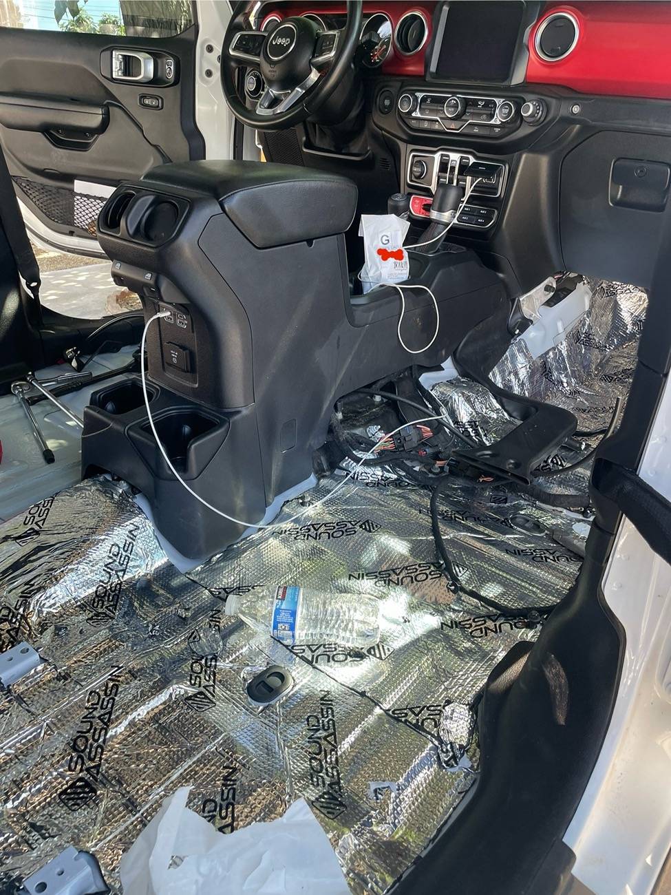

When I did my interior with the same product, I bought the kit for the JT and did the entire floor, removing front and rear seats. I had like 2-3 full sheets left iirc.
Edit - by same product I mean the hotheads kit. Not sure what the sq footage is.
