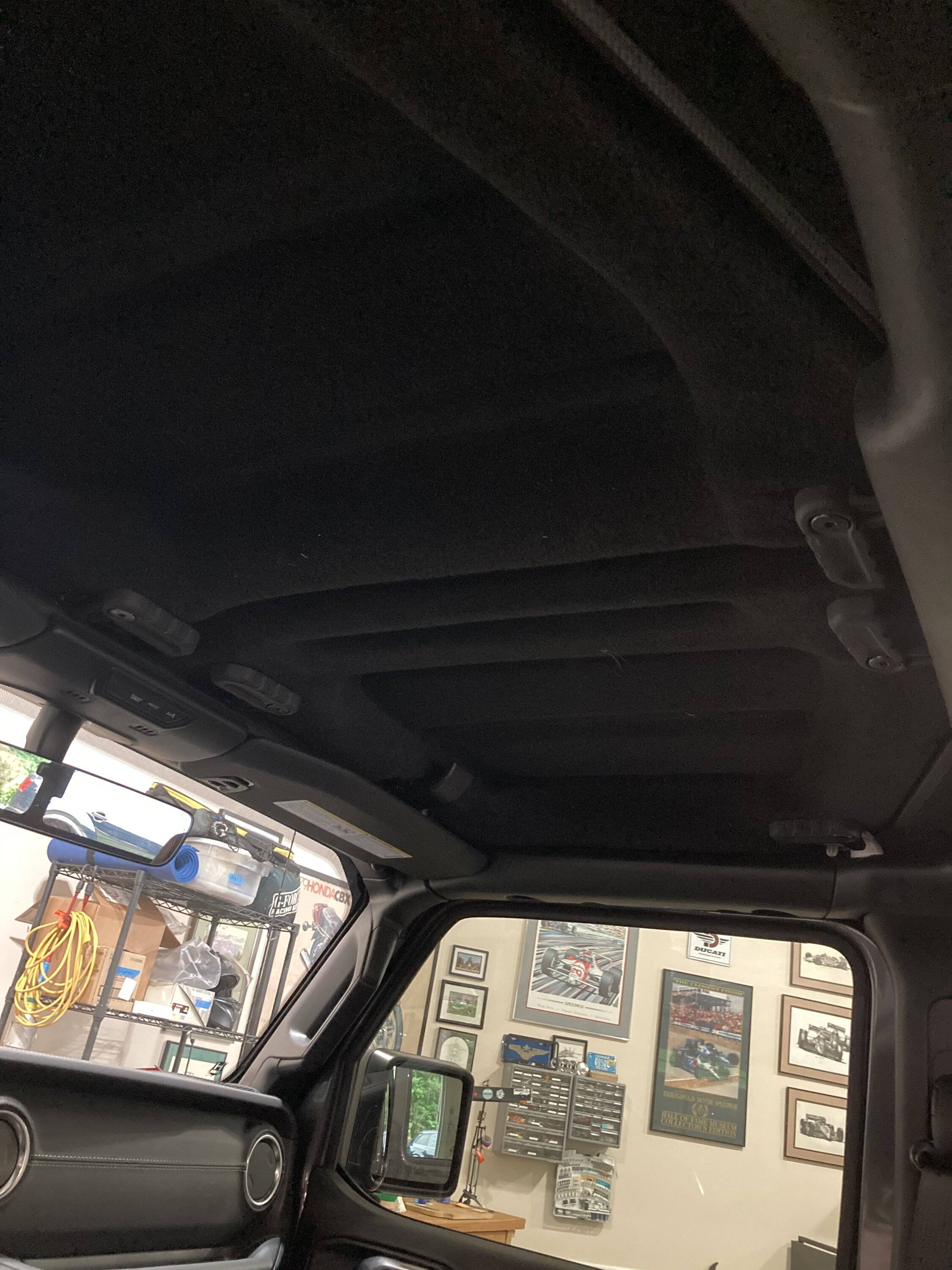

The Mopar unit is fine for what it is, and the fact it was included in my purchase. However, I would not pay what Jeep wants for it now that I’ve seen it and seen how it is constructed and installed. The coverage is nominal at best for the freedom panels. It is slightly better for the main portion of the top. However It has no sound deadening for the actual fiberglass. It is a thin cardboard-like panel that sits on the top of the fiberglass with Velcro fastening.

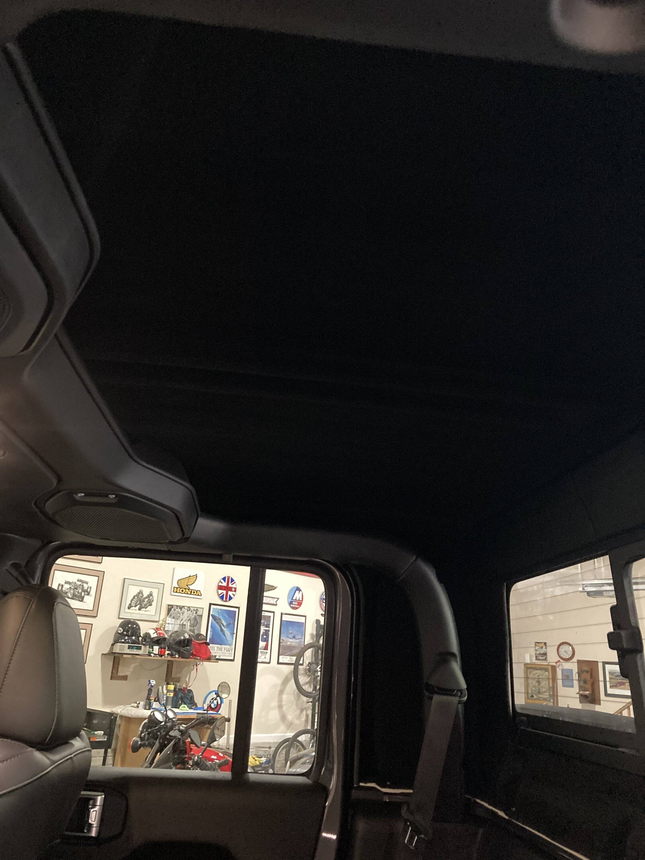

The Coverking on the other hand, when combined with a butyl rubber and aluminum foil mat, has much better sound deadening properties. On top of that it has better coverage of the white fiberglass as well. You can see how much more coverage there is in the pictures in my prior posts. It definitely gives a much more finished appearance than the Mopar panels. While it is true the majority of the increased sound benefits are very likely from the rubber and foil mat, the overall package is a winner.
I also like the price comparison since the Coverking is less expensive than the Mopar (esp. if you can find it on sale).
The PIA of the Coverking would be a) the wait for shipment and b) the install. I’m still waiting on a bit of good weather so I can pull the top without having to worry about needing to drive topless for a day. The warm weather should also help with adhesion.
One thing I have not dealt with is the issue of the tape strips. I decided to use spray adhesive to do the install. It worked very well. I understand from others that the tape strips may not be adequate for some installations.
The Coverking installation instructions, and that is a very generous term, leave a lot to be desired. The video they provide a link to is informative but not instructive. It also fails to adequately show which pieces of tape go where. Yes, technically there is a ā€˜diagram’ shown in the video very briefly but it is the type of information that a company marketing to self-installers should include in a printout. Another issue is the lack of labeling on the actual pieces of tape.
Did you notice any impact to your Sirius reception?
