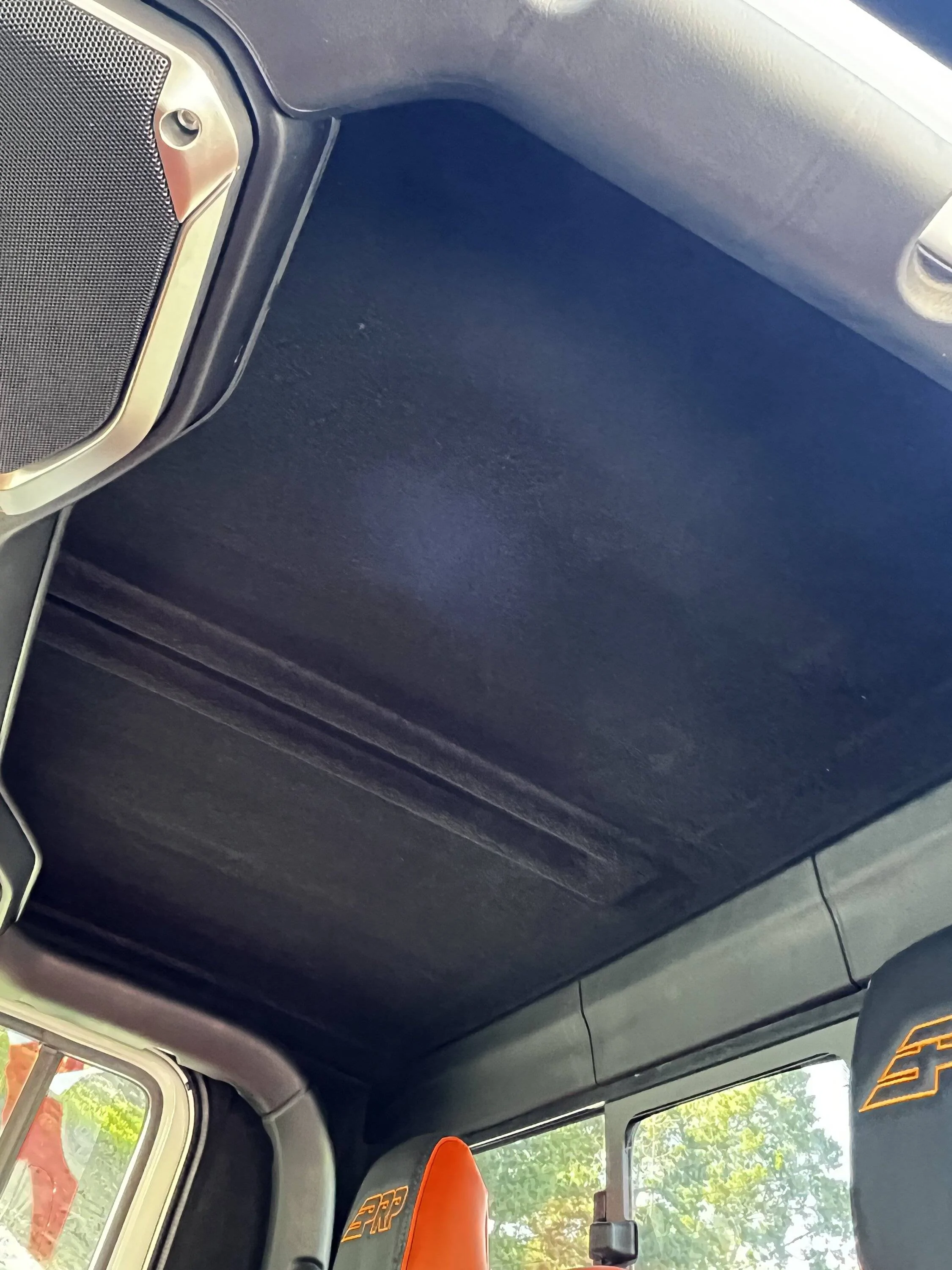

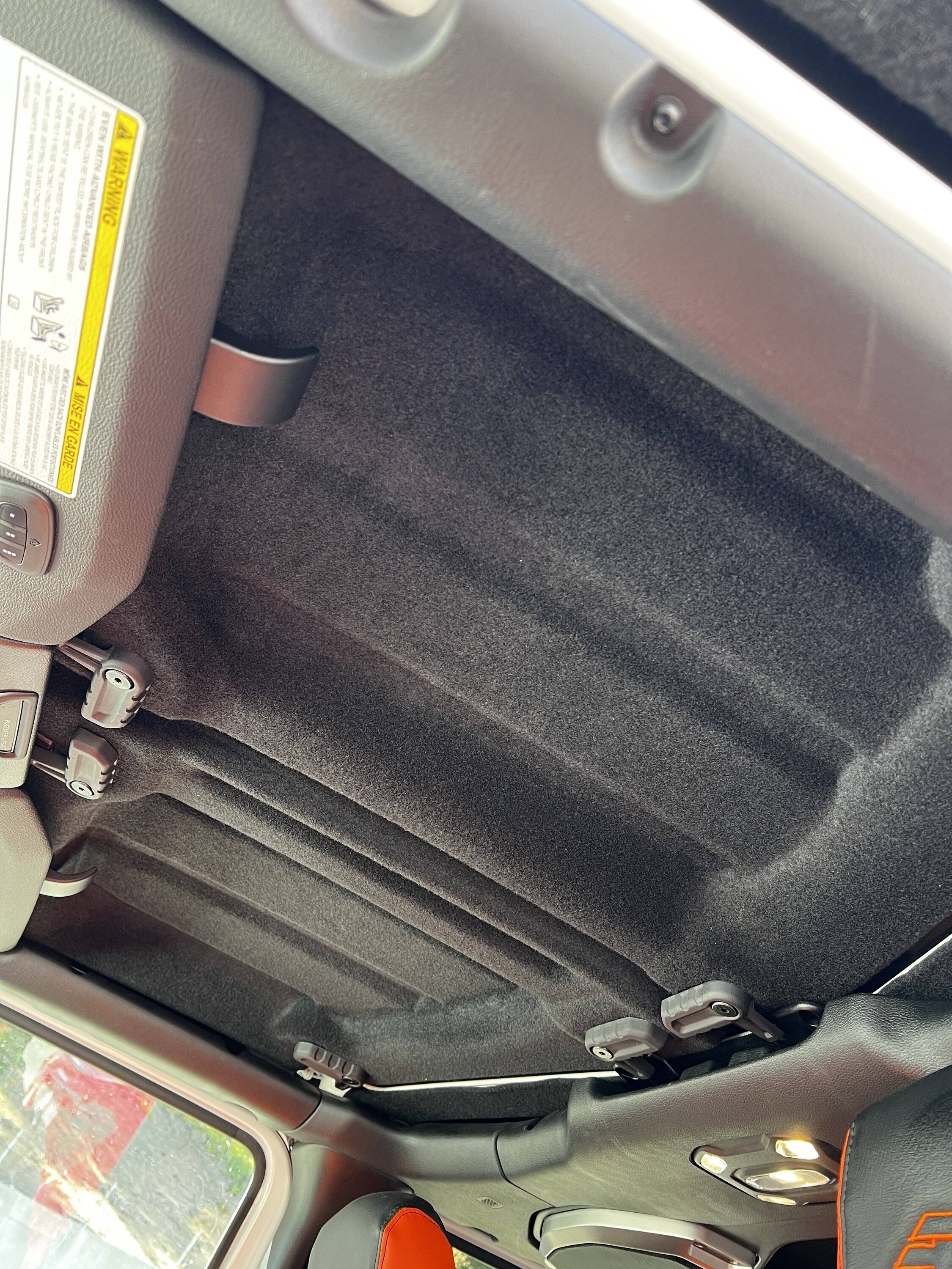

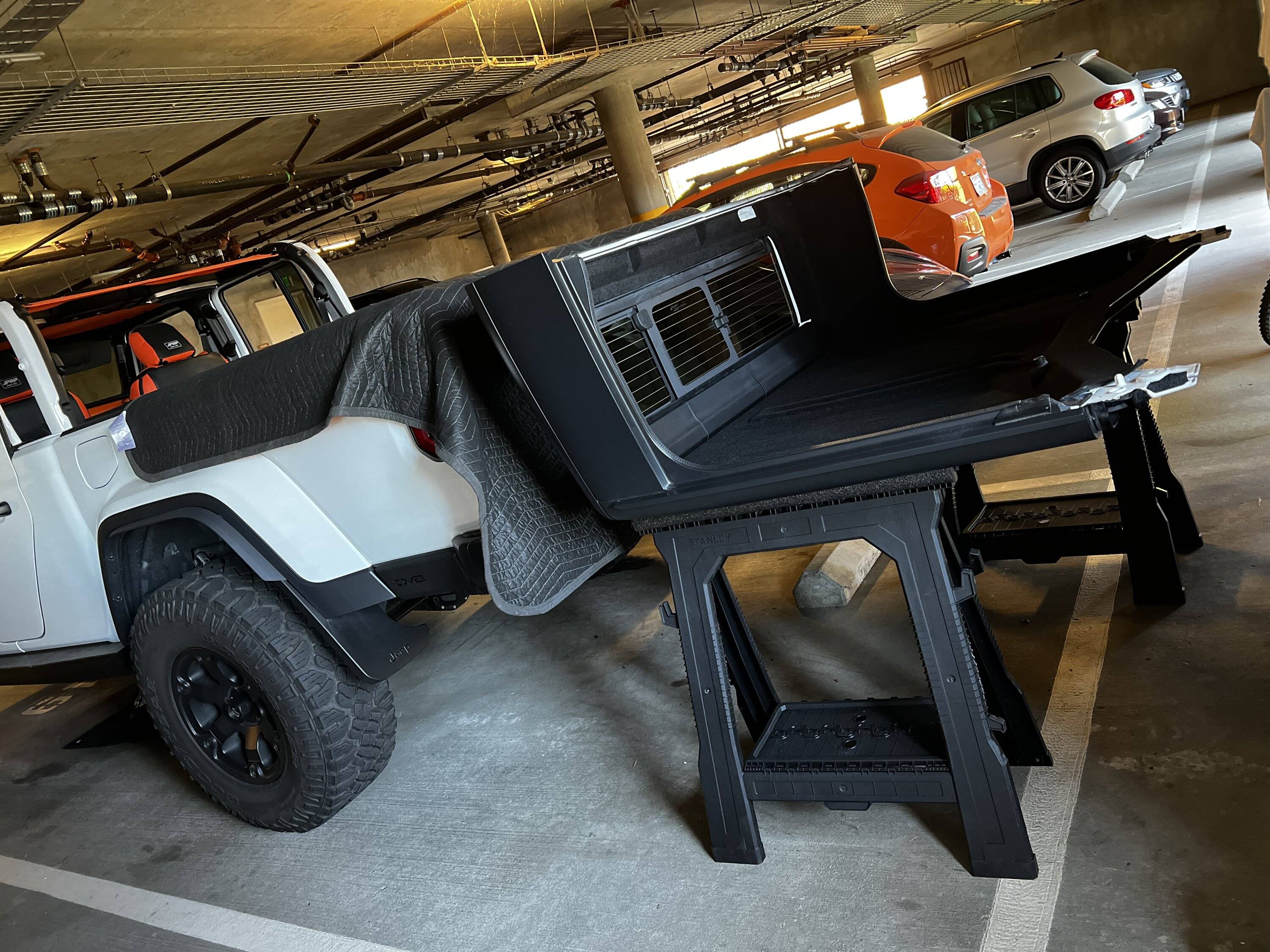

Another for CoverKing headliner plus one layer of 80mil KILMAT.
Is there a reason you didn't put the trim piece on the from edge of rear portion? With freedom panels off the wind may curl that front edge
When I finished the install, I thought they just gave you extra edge trim. Didn't realize the extra length was for that. I have since installed that edge trim.

How much of the Kilmat did you use?
I didn't go full coverage, about 95% is my guess. Just the large flat-ish surfaces. If one or two un cut sheets are enough to cover most of the surface, that's all I used. I also used the OEM MOPAR headliner as a template.
I went through a half box of these. More than enough if you want to go full coverage.
