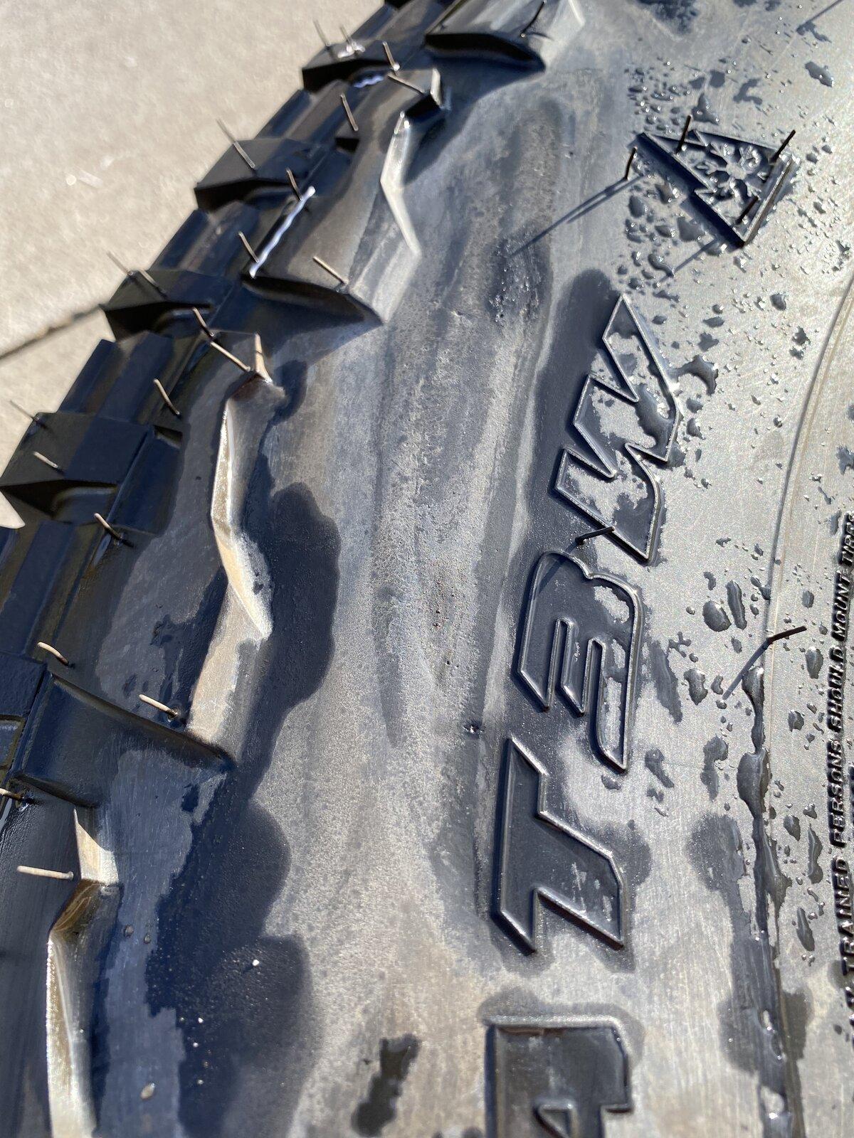

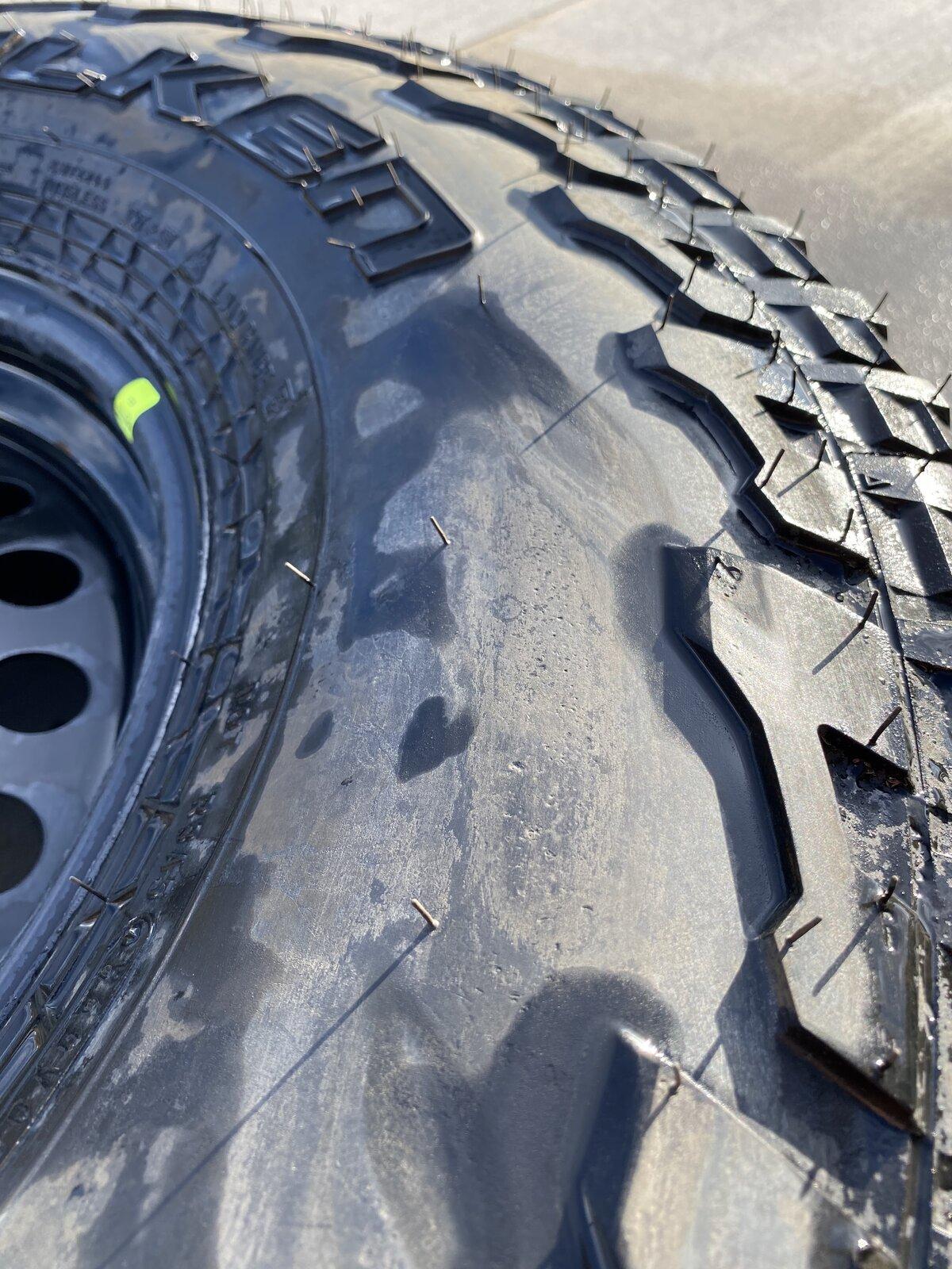

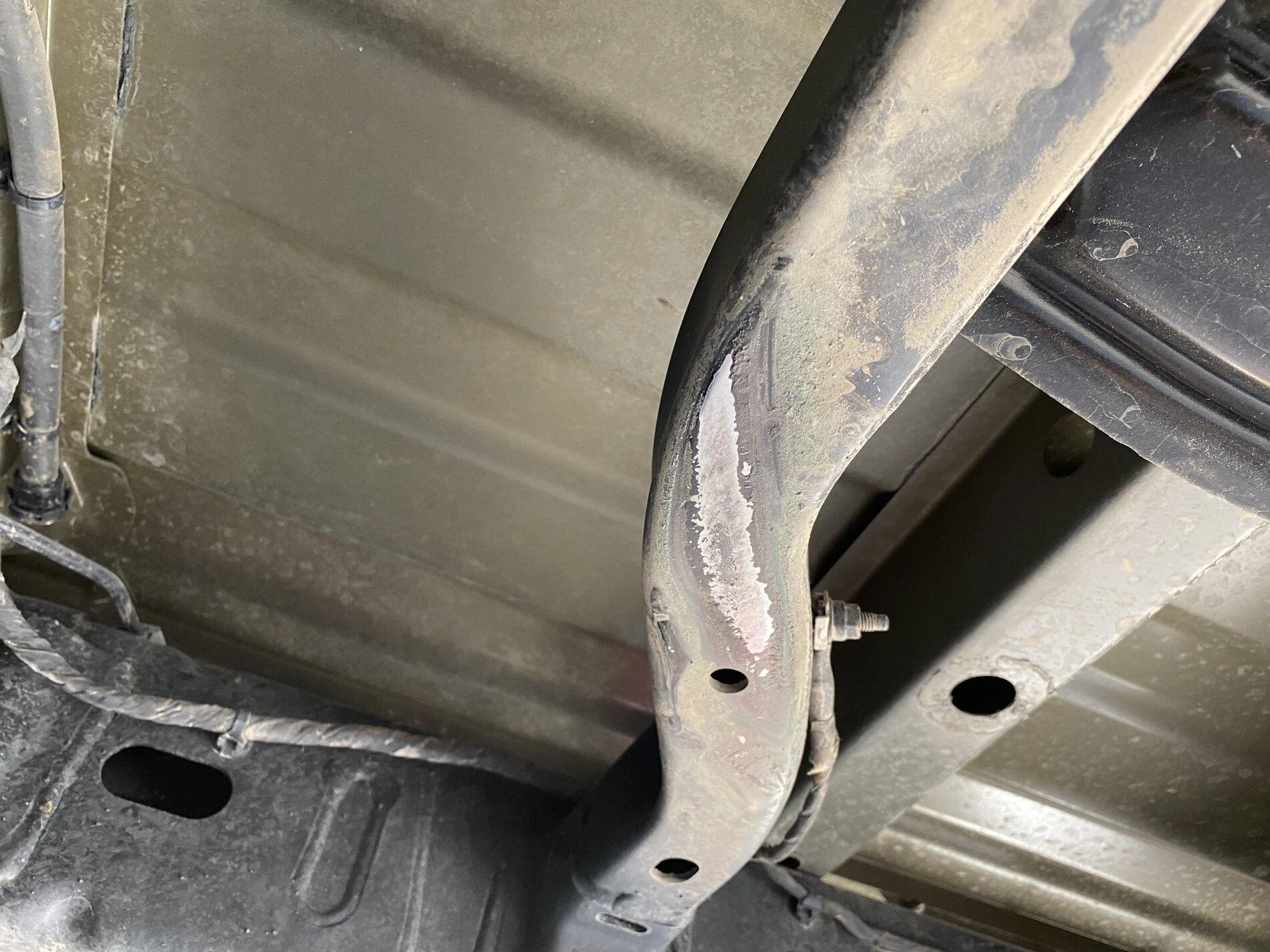

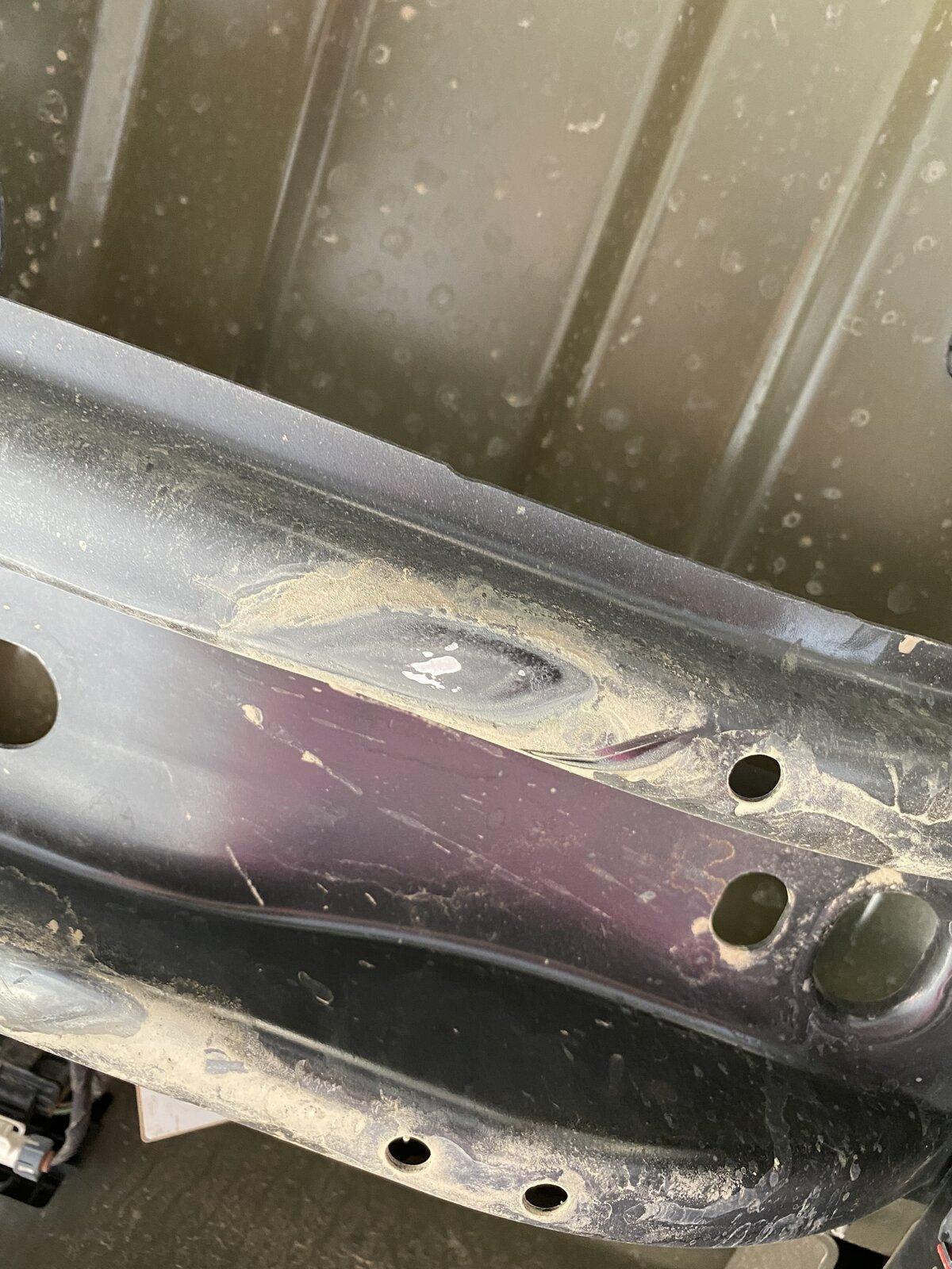

Shortly after picking up my JT (approx 500mi) I had the stock tires swapped out for 35x12.5r17 Falken Wildpeak AT3Ws. I had the spare tire swapped out as well, planning to purchase a matching 5th wheel when it came time to do the first rotation so I could do a 5 tire rotation.
I just pulled the spare down to take a look at it and found that it has abrasion marks from where it touches the frame. There are matching marks on the frame, with the paint being worn off completely in some spots.
I know the tire winch was as tight as it could be as it clicks when it’s tight enough, and I checked it after the tires were installed and several times since then, and it clicked almost as soon as I start turning.
Is the tension setting for the tire winch not high enough with the increased weight of a 35?
Has anyone else noticed a similar issue?
I’m not sure I want to rotate the other tires in if they’re all going to get damaged like this. I’m tempted to see if I can use my tire certificate from Discount to get it replaced.

By chance do you remember if the outside of the rim was facing up or down?
Outside up. It’s the stock steel spare wheel at the moment.
Edit: Also want to add that the wear on the tire is worse than it appears in the pictures. There’s a bit of an indent ion and it looks like small pieces of gravel may have gotten in there as there are some small divots.

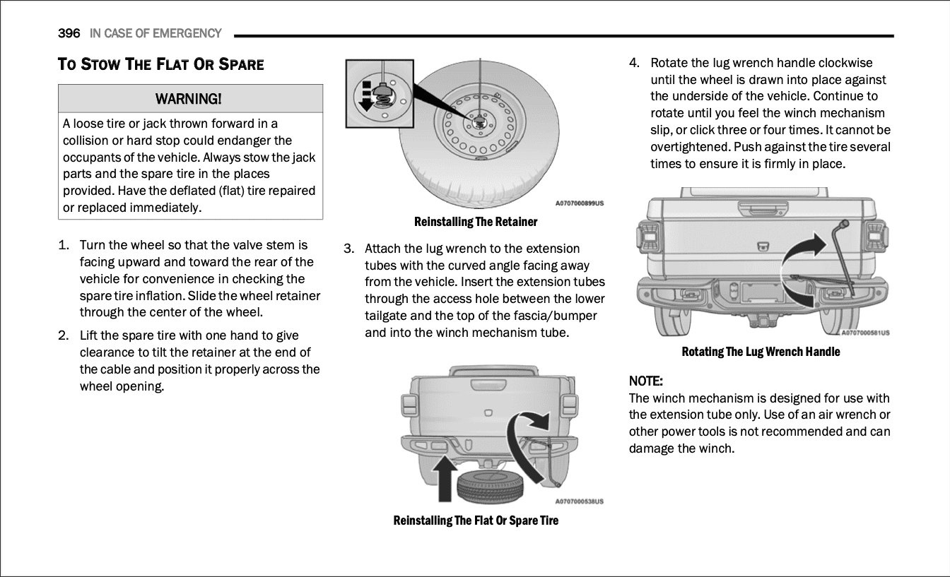

Also, I have never had it do any clicking like you mention.
If you keep tightening it once it stops the winch will click, kind of like the gas cap.
In the section on stowing the spare owners manual says “Continue to rotate until you feel the winch mechanism slip, or click three or four times.”

The spare winch is plenty strong. Sounds like it might not be positioned correctly underneath.
It does definitely feel tight. I can’t move it by hand, or even if I kick it, but I can’t figure out how else this kind of wear could be happening.

I've definitely not damaged the mechanism. See step 4 in this screenshot from the owners manual.
Jeep Gladiator Spare Tire Winch not strong enough? Screen Shot 2021-10-04 at 13.33.13
Unrelated note: I grabbed the latest version of the OM (v4) from the Jeep site for this screenshot. The version I already had downloaded was v1. The 4th edition is 32 pages longer than the 1st. I wonder what all changed.

Thanks, learned something new.
I would swear on mine, it just feels like something is going to snap (break) if I try to get it any tighter.
