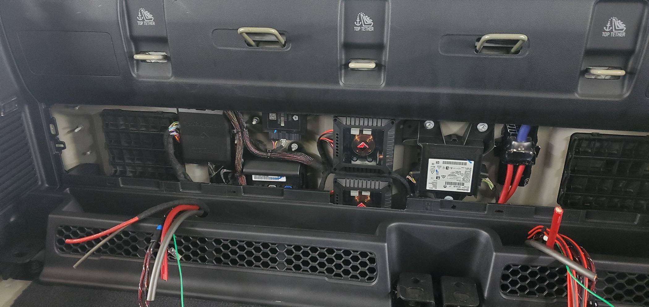

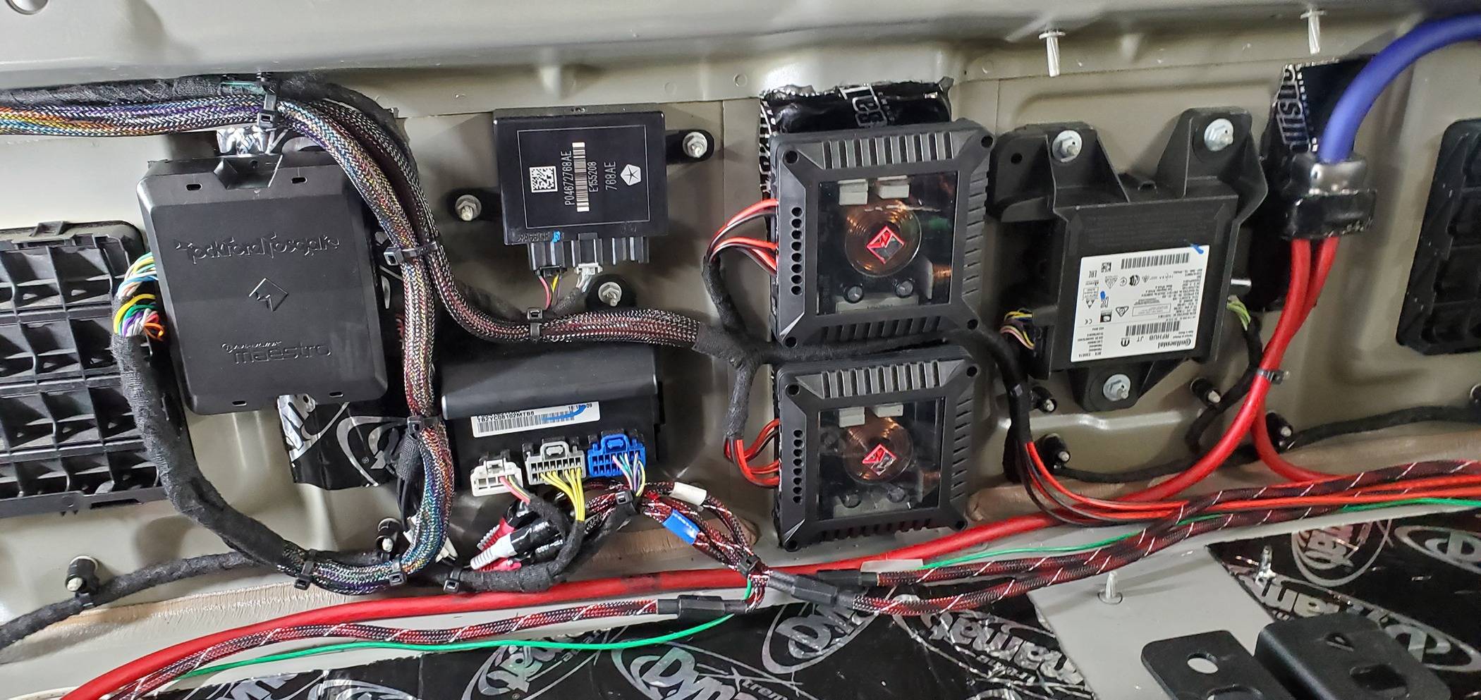

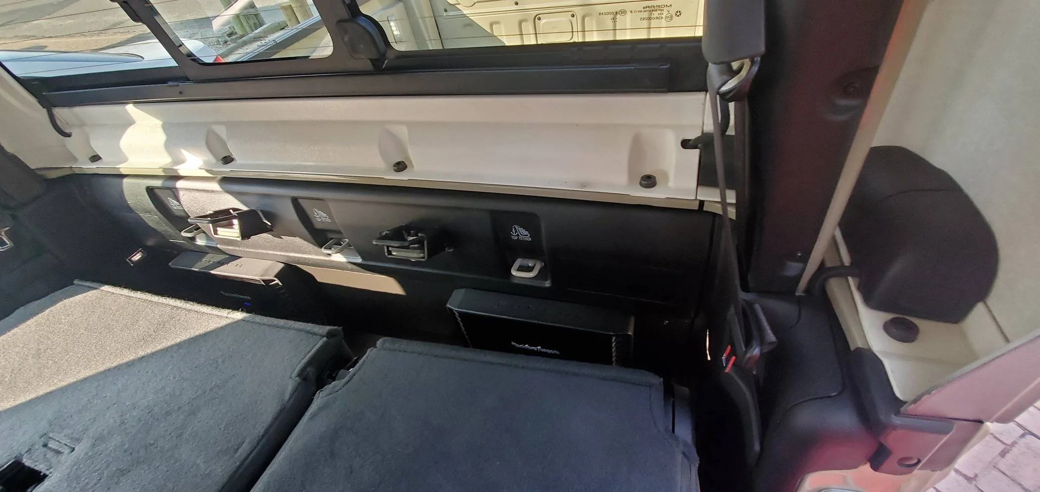

If you have the Appine system it is not that bad. All the speaker wires are at the amp in drivers knee panel. I did the DSR1 (I do NOT recommend it), the PAC unit and wiring harness are easy. It is just time consuming to di it right... Here are some pictures of my last system in my old Gladiator...
