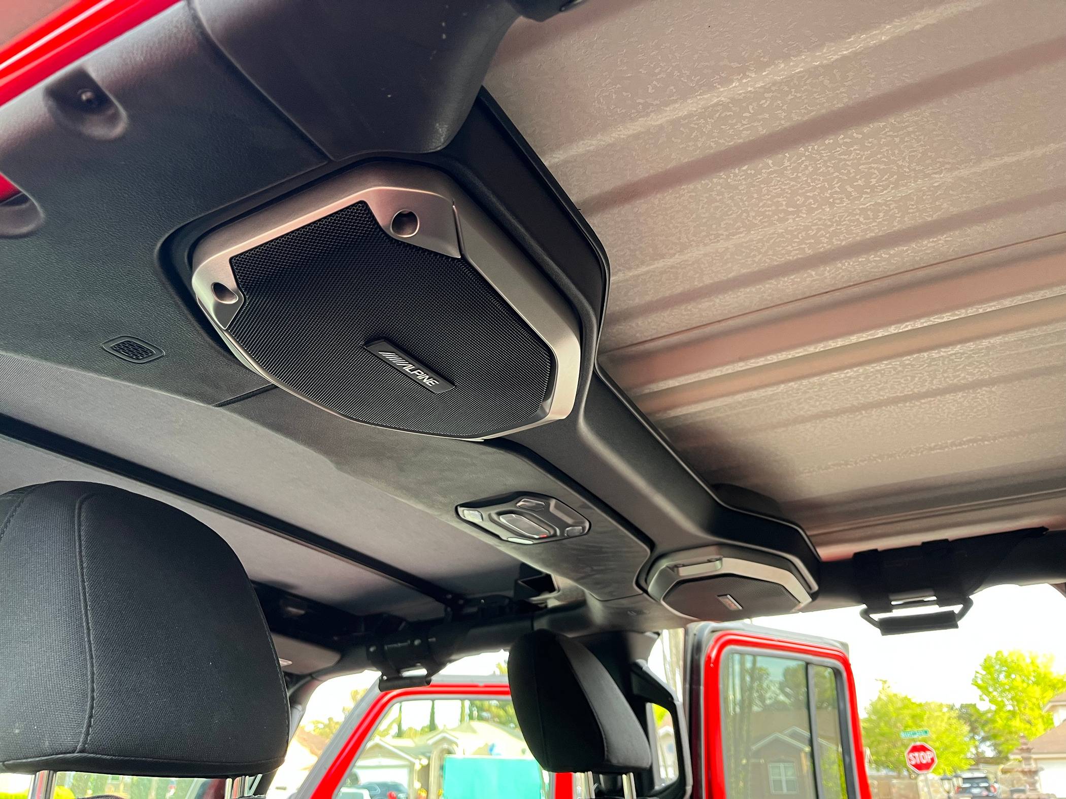

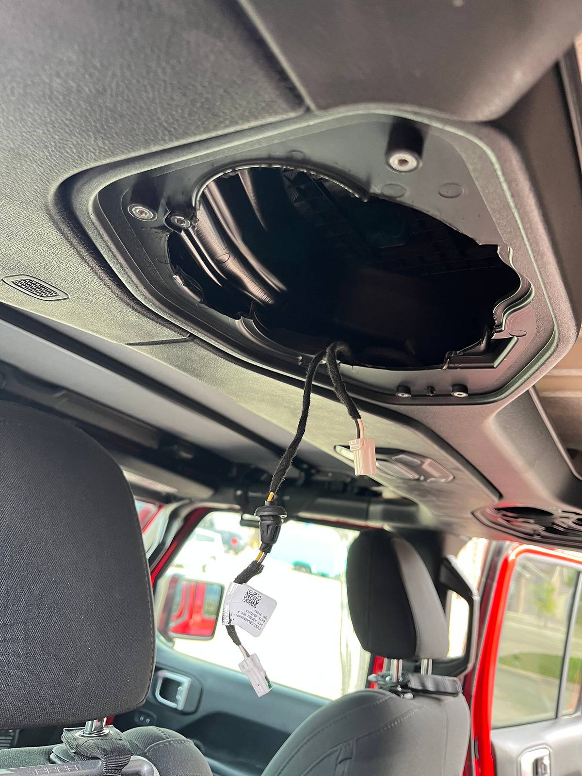

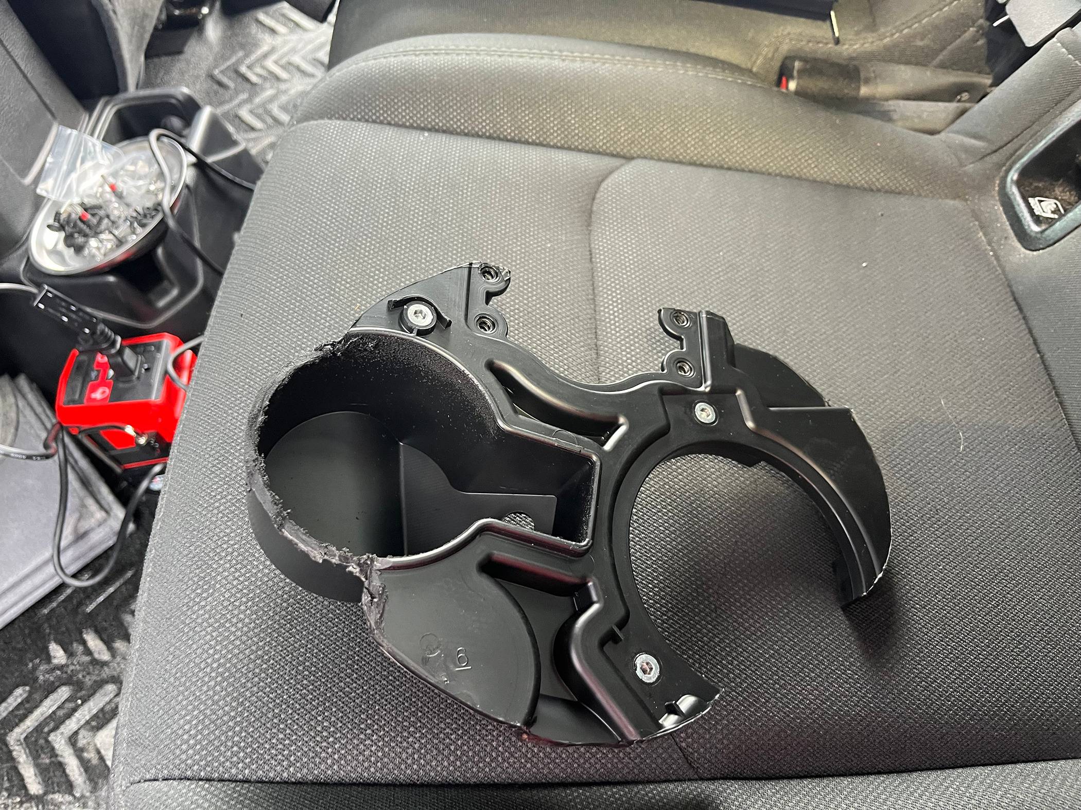

I also have the Alpine System. While I was okay with the stock sound, I found a good deal on an "OE Plus" upgrade so I jumped on it. I bought a set of Alpine SPV-65-JLT Sound bar speakers, (they're "used, open box" but they had all the packaging and were basically new!) and Dodge Dart Kicker drop in upper dash tweeters. Needed some Metra adapters to bypass the built in crossover on the larger speaker, but it was otherwise a straight forward install. Very happy with the result, a great upgrade for around $500.
While there are some "drop in" soundbar upgrades like the Kicker speakers, I liked the Alpine option because it looks factory. With a fresh utility knife and/or a Dremel if needed, it's a pretty straightforward job.
