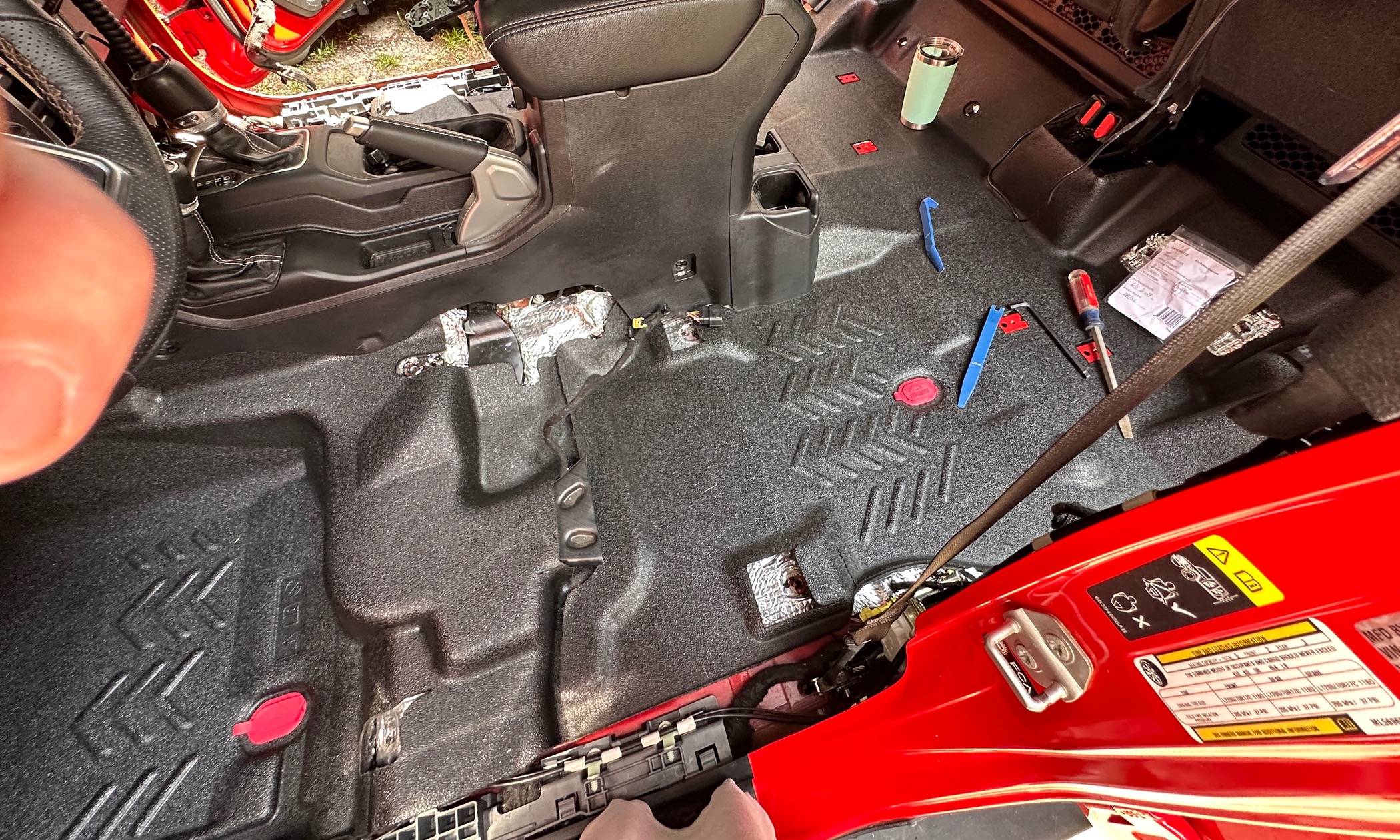

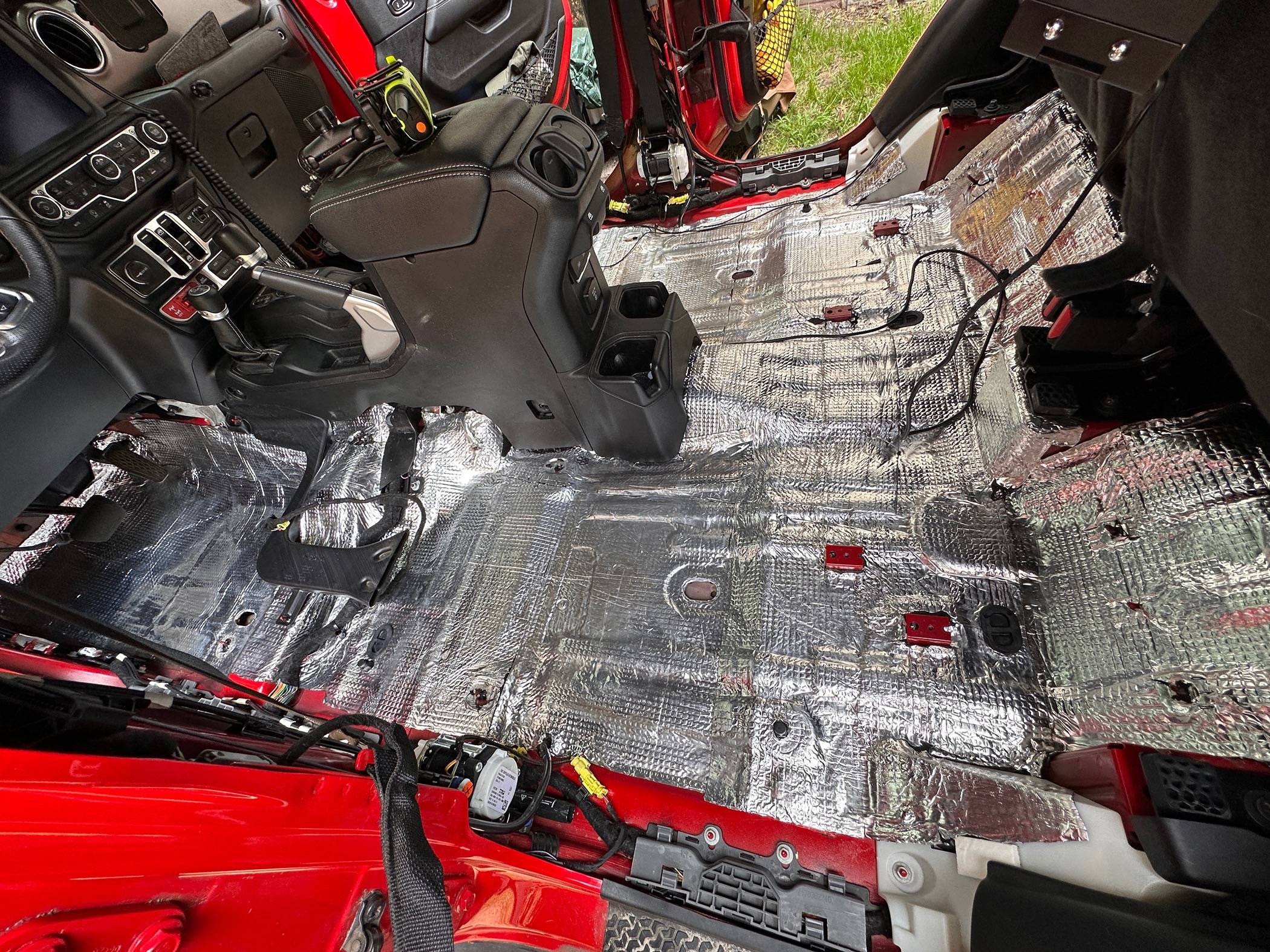

The Sound Assassins are like Dynamat but thinner. It’s a sticky rubber with a foil top. You pull all the seats and adhere this to the floor.
Jeep Gladiator Stereo upgrade IMG_1747
The Armorlite floor will fit over this, but it’s tricky. I made it work.
Jeep Gladiator Stereo upgrade IMG_1749
