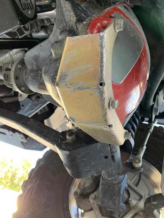

The metalcloak stuff has been bullet proof for me. Here is a pic of the front and back nodular iron diff covers and front and back skids.
Is it messed up that I get a feeling of joy seeing seeing parts all scraped up :CWL: I think I like the idea of that skid. Despite losing a bit of clearance. Trying to reason it out, it only loses in that one small area. Usually I don't want that area anywhere near dragging on stuff its a major miscalculation if it does.

I got mine mostly for insurance. Nothing should be hitting it, but wheeling all day over hundreds of rocks and you're bound to not see one, lol
The diffs are the lowest "important" thing on the jeep. Some form of protection there is a good idea in general

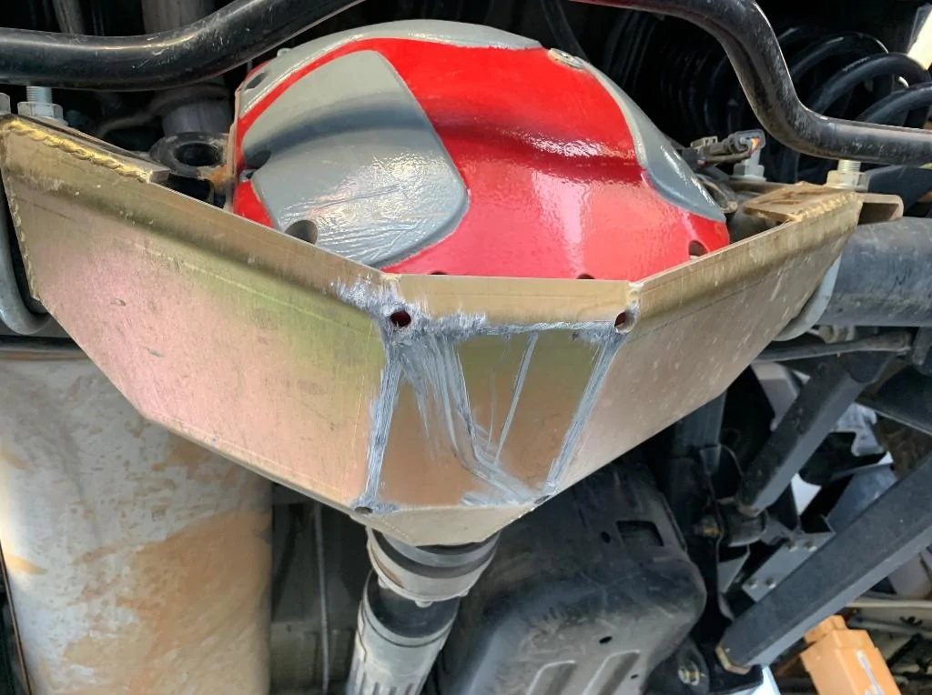

Is anyone making a rear diff skid that protects the input pinion? I have the AEV version on my JK, and you can see that it's doing its job, but I haven't seen anything similar for the Advantek D44.
