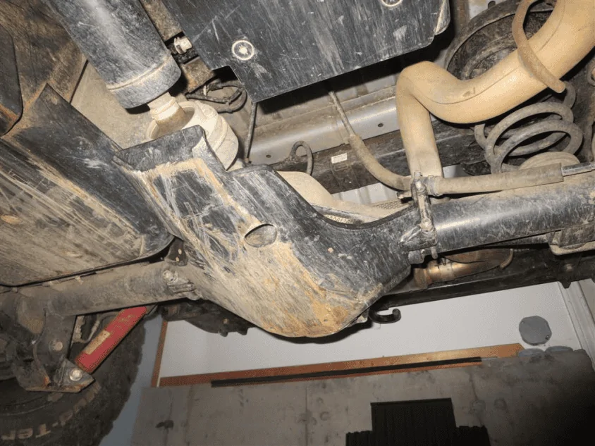

Is anyone making a rear diff skid that protects the input pinion? I have the AEV version on my JK, and you can see that it's doing its job, but I haven't seen anything similar for the Advantek D44.
https://nextventuremotorsports.com/collections/jeep-truck-gladiator-jt/products/jl-rds-m220
https://nextventuremotorsports.com/products/jl-front-diff-skid-fds
These are amazing. If you have stock covers, they have spacers to account for the thickness. They protect everything. Not just the bottom of the diff cover.
