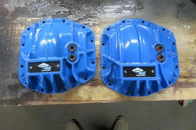

I bought the Dana Spicer nodular covers, mostly because of the blue paint option, but they held up insanely well at Death Valley (specifically Mengel Pass). The bottoms have plenty of scratches, but no major damage to be seen.

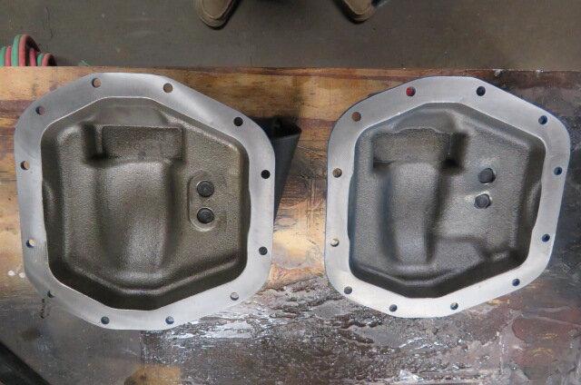

The G2 cover inside shape is wrong (IMO). I would only use a cover that mimics the interior shape of the original factory cover. Oil flow in the differential is critical to ensure proper pinion bearing lubrication. The ring gear picks up oil and 'flings' it towards the pinion bearing using the contour of the cover to direct the oil. Comparison, G2 on left, Dana on right:
Good call. Is that the OE Dana 44 Mopar cover, or upgraded Dana Spicer?

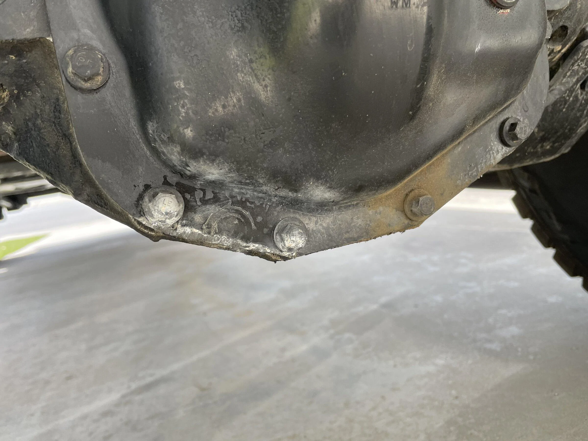

Long overdue here is a pic of the damage I described after kissing the concrete pyramid

I get your point, but I’m not worried about the very distributed load while sharing six bolts with the diff cover. That’s a pretty strong part already, as you can put a floor jack under it if necessary. And then there is still a huge bracket that goes over the body of the diff further forward. If it were one or two bolts only, I’d see the possibility of an issue, but not with six.

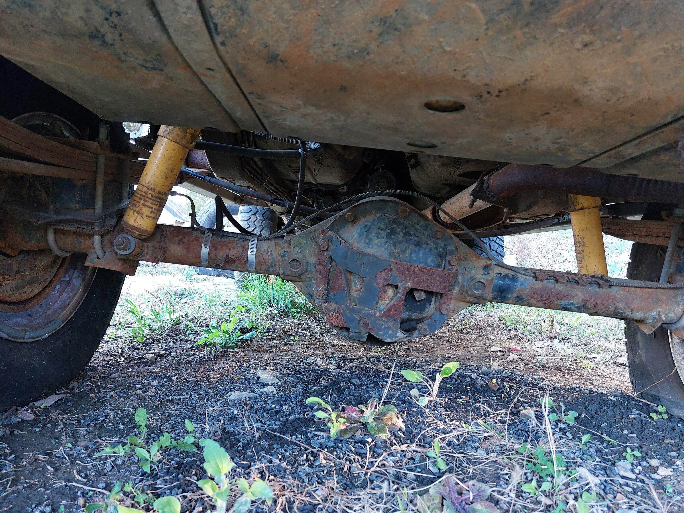

I'll second that on the load being spread over multiple bolts, I welded up a guard for the rear dif on my XJ decades ago it's been bashed on many rocks now repainted many times.
I bought the same ones. ?

Here's the Dana covers. They weight about 10 lbs each.
