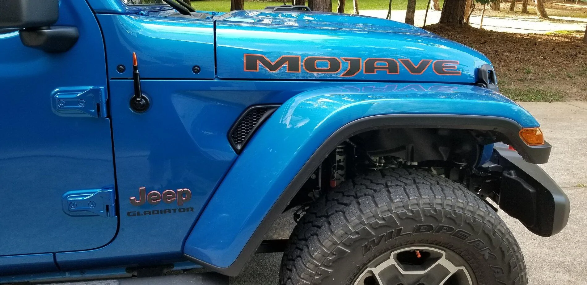

I put an VMS Racing orange tip bullet one on my Mojave for the orange accent. Not as good reception as Rydonair, but does the job. No AM stations, which I don't need.
Jeep Gladiator Stubby antenna recommendations 20210607_181204
