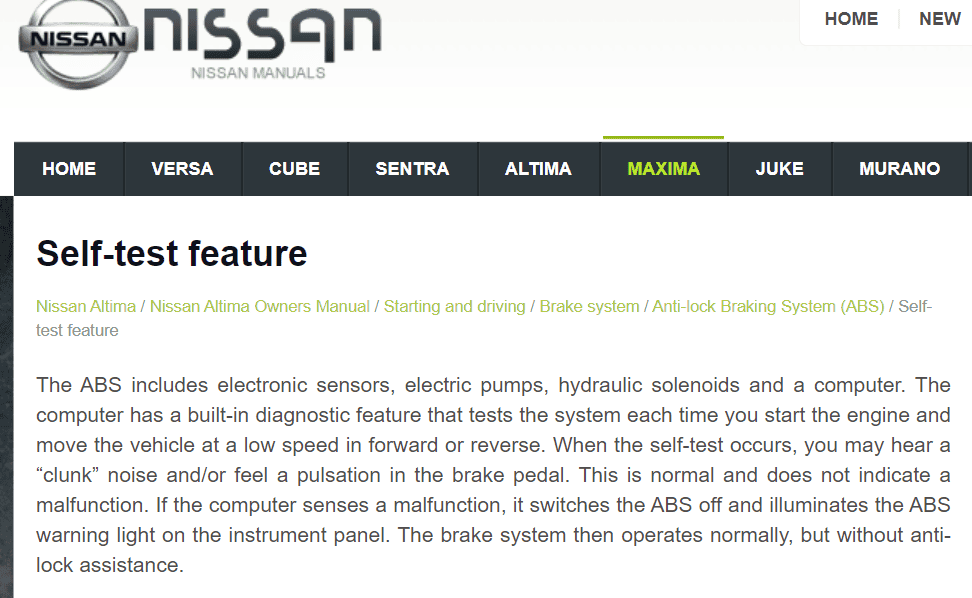

Chevy forums, and other car forums I can't even remember, all say the same thing. One indicated for their make and model (a foreign based vehicle) they said it was in the owner manual what the noise was. So I started digging through manuals - it seems 7mph is common, some go as high as about 12. Apparently the ABS only operates at speeds above about 6-12 depending on the model, etc. but 7 is a really common number and pretty easy to find the solution to all of this on Google.
I had about 8 different tabs open all talking about this - and all with the same exact answer (just that some had slightly different speeds and some never heard the sound at all) and I found this gem from Nissan..........
Bottom line - phone a friend, ask the audience, buy a vowel, no whammy, whatever - it's the ABS.
papa, crap like this is why I love you. (Platonically speaking) i would have NEVER evem thought about this as the cause.
I couldn't hear it on my truck and my wife has never mentioned it on her Jeeps or mine.
I knew it wasn't locks, and yet several people mention the sound - but no trace of a problem or abnormality. So I did some digging - and learned some other stuff about ABS and ESC at the same time LOL.
