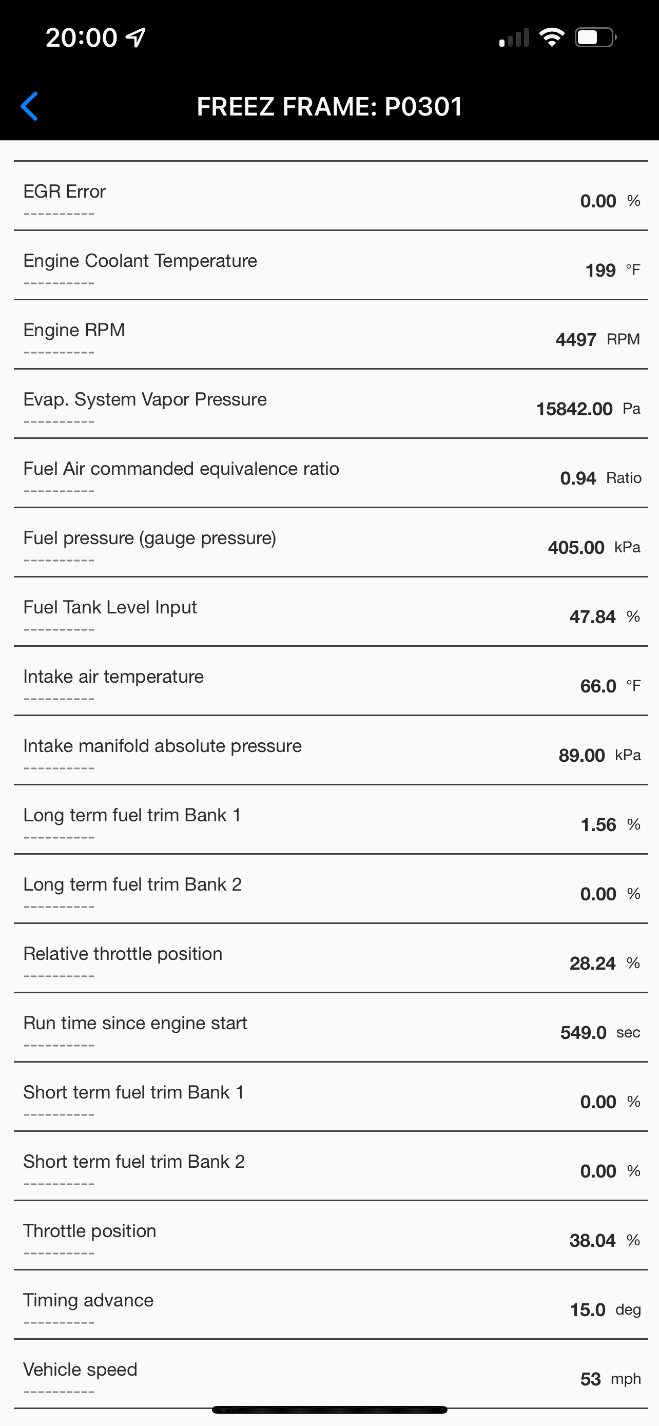

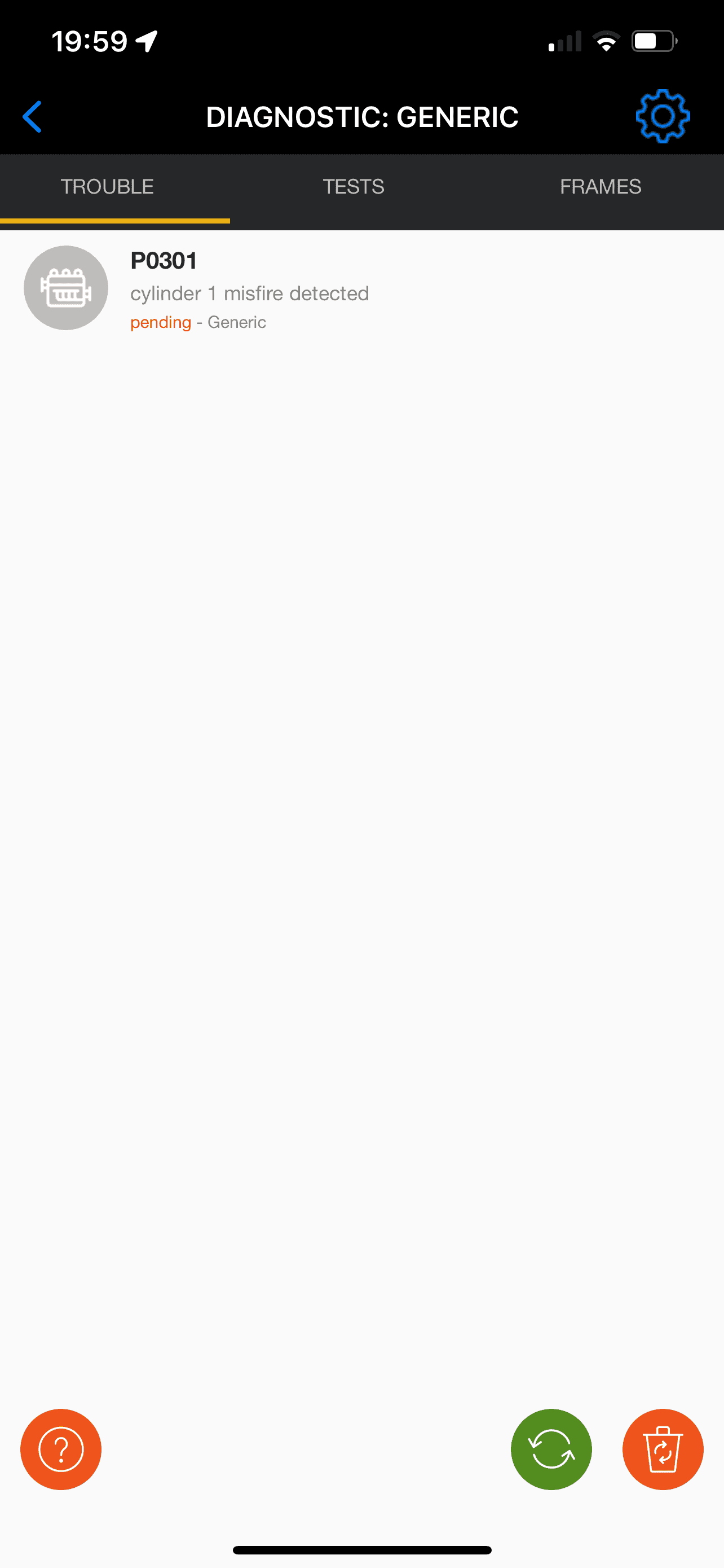

Update: got a code from the misfires this morning: P0301. Cylinder 1 misfire.
Catch it in the act if you can and do a freeze frame to capture the engine environment and perhaps nail down if it's ignition misfire or otherwise.

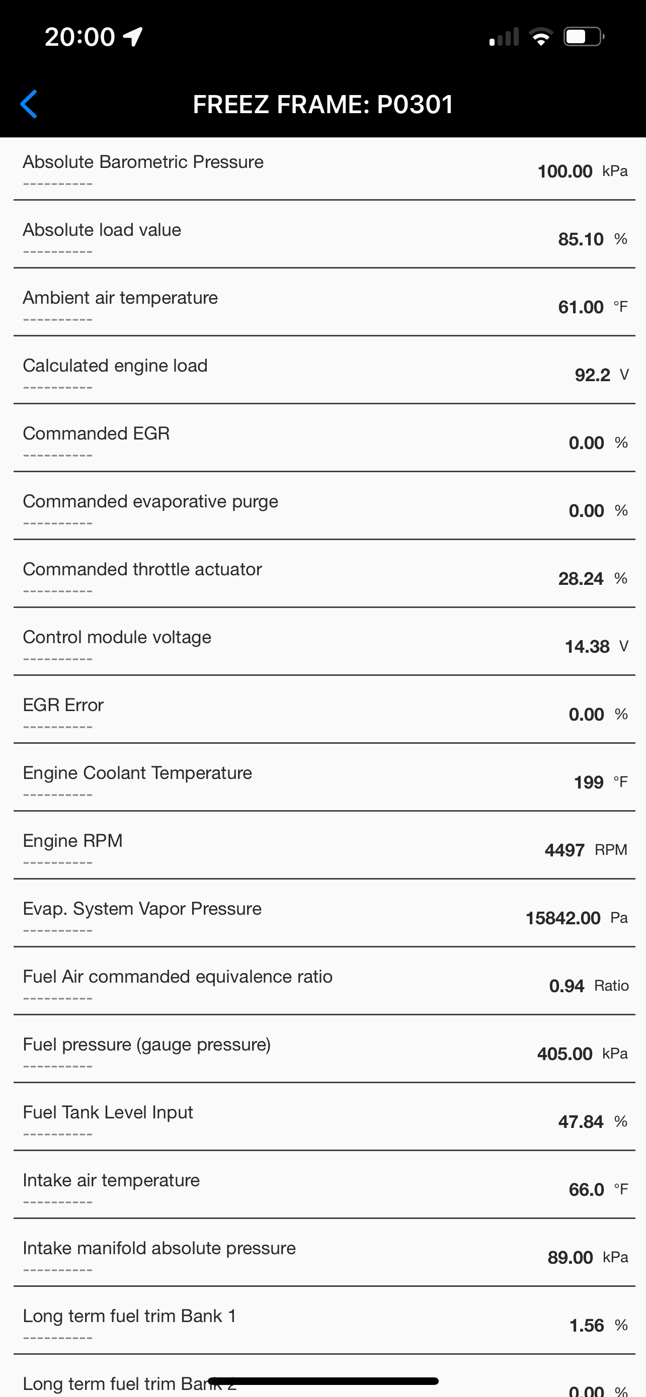

I did get a freeze frame. Not sure entirely how to interpret it. Definitely happened at high RPMs.
