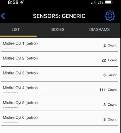

Do you live monitor the misfire counters in real time with Jscan at startup? Your situation is very similar to what I had with my 2020 Gladiator on cylinder #4. 90% of my #4 cylinder misfire counts were within the first 30 seconds after start and then level out with a few ticks on the count on my 30 mile commute.
I did spark plug replacement, coil position swap and even checked for coolant leakage into cylinder #4 with nothing detected and problem remained. I traded it off.
I would be interest if the dealership finds anything on yours. Before I traded, I briefly started a log when my ESS disable light would post and monitor the misfire count. I would get a pending P0300 code but it would never post.

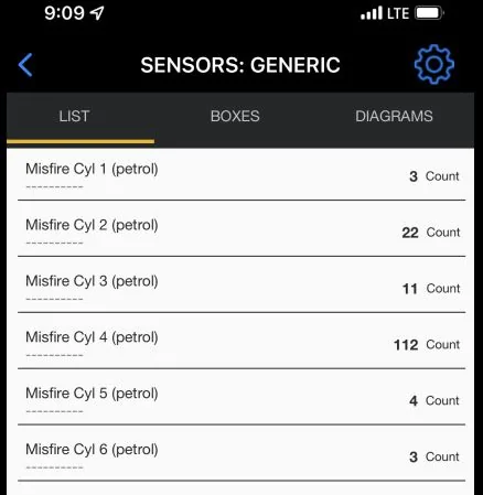

Thank you for bringing it up to change out the air filter. I thought about it last night but completely forgot to do it. The OEM filter is back in now.
Before changing the filter, I wanted to get a before and after scan. The truck had sat for about an hour and the first picture shows the 2 minute drive from the house to the paved road. This time it showed 12 on cylinder 2, 30 on cylinder 4, and 1 on each of the others. From there I came home and had 1 more on cylinder 3 but the others stayed the same as shown in pic 2. I am letting it sit now and will drive it again after it has rested for about an hour and will post those results.

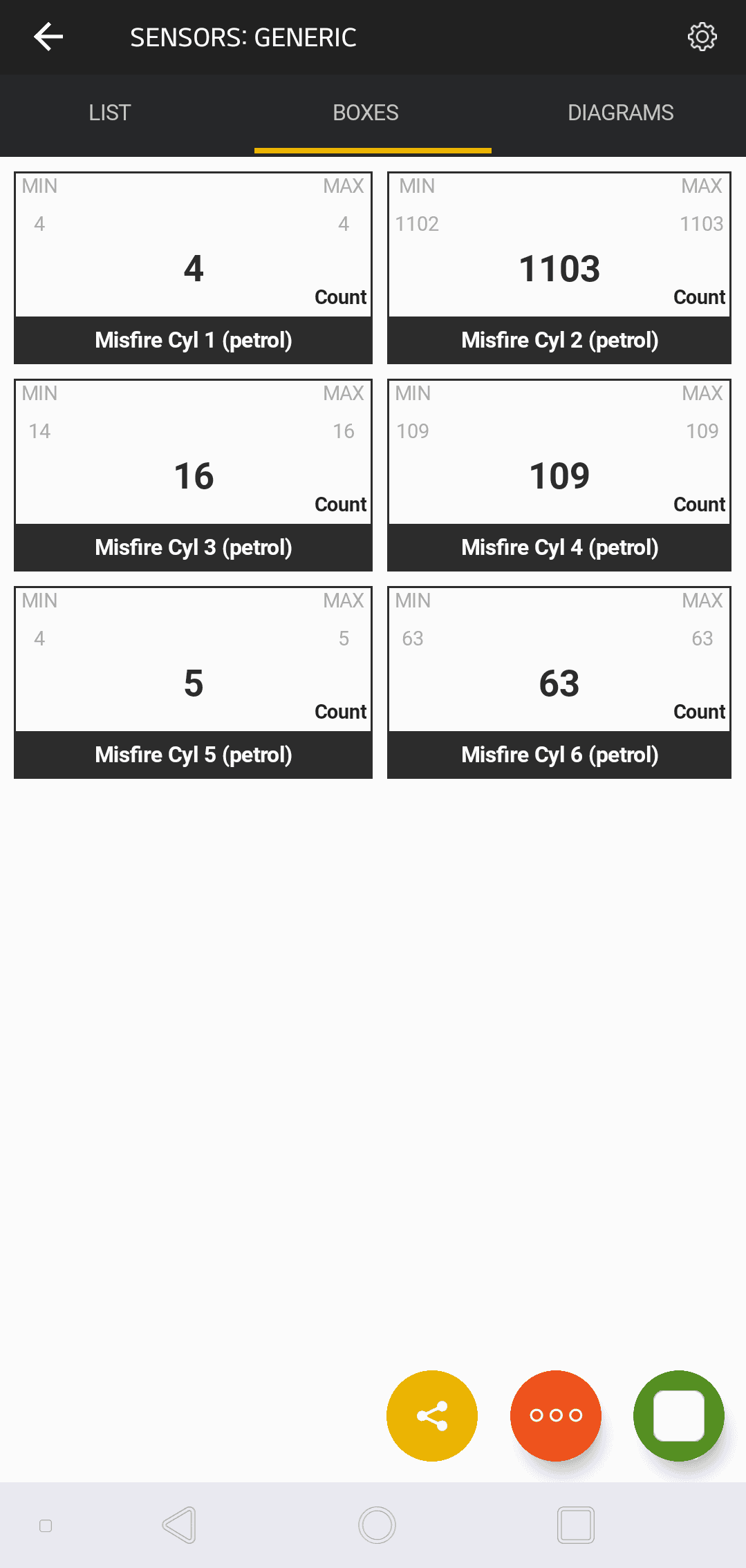

Yes, I have been using Jscan to live monitor the misfires. Today cylinder 2 has also been acting up but most of them are on # 4. Like you, it seems that most of mine happen less than a minute after startup. As suggested by ShadowsPapa, I went back to the OEM air filter and am going to test it again in a few minutes. I will also report what the dealer says when I let them look at it this Friday.

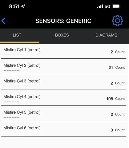

After not being started for approx an hour and 15 minutes, and with the oem air filter back in, the results did not change much. The misfires on cylinder 4 and 2 both went up a little during the first minute of driving after startup in pic 1. With aftermarket filter, cylinder 4 reported 30 misfires during first minute then no more. With oem 58 were reported during first minute then none for the next 4 of the short drive. After it has sat for about an hour, I am going to drive it again for 30 minutes or so and will report the Jscan results

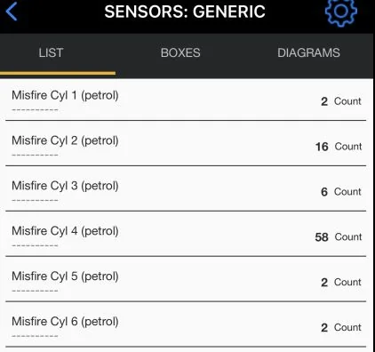

I went for an 18 mile round trip drive this evening to check the misfire count one last time and attached are the live Jscan readings. During the first ¾ mile, approx. 1 minute, Jscan showed 108 misfires on cylinder 4, 21 on 2, 3 on 6, and 2 on numbers 1, 2 and 5 for a total of 138. For the next 8 miles, those numbers went up 4 or less per cylinder, the total misfires after 9 miles was 147. At mile 9 I turned around and came home. During the 9 mile drive home, cylinder 3 showed 5 more but the others showed no more than 1 per cylinder and the overall total for the 18 miles trip was 155. At no point since I picked up the Jeep early this year has the engine sounded strange or lost power at all. Since the dealer cleared the code on Friday, the CEL has not come back on.
If anyone can help, I have a few questions.
If there were actually 138 total misfires in the first 60 seconds of driving, shouldn’t something have been noticeable?
How many misfires are looked at as normal?
Approx how many would it take to set off the CEL?

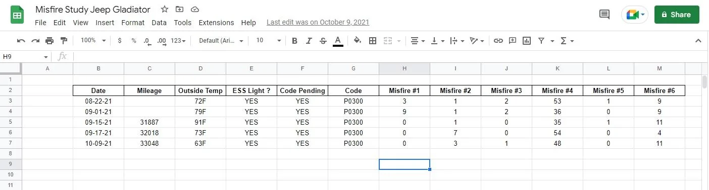

My truck has been throwing a P0300 every couple of weeks. It never runs rough and the light goes out after a few minutes.
I would like to log this using my Tazer Lite. I seem to remember that this can be done. Has anyone else done this?
As I'm typing this, I remember that it might require a laptop to remain plugged into the tazer and turned on. Is that right? If yes, that's not really workable.

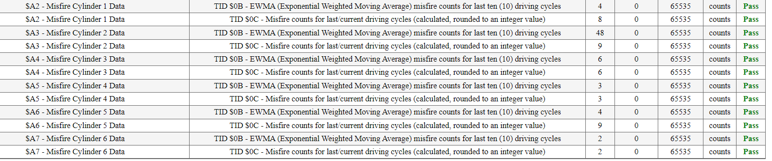

From my research in the past, it is not a defined actual number but based on a percentage of expected ignition events vs. RPM load.
It will vary by manufacturer but a rough 2% error loaded will set the pending code on the first ignition cycle and the CEL will set if it happens again on the 2nd ignition cycle. A 10%+ error loaded will set the flashing CEL.
Also, the error percentage it tracks is an average over time. If your misfires count is high, but your engine run time is long, it may not post any codes pending or permanent unless a high enough concentration of misfire events happen in a shorter time span.
It will vary my manufacture but a rough 2% error loaded will set the pending code on the first ignition cycle and the CEL will set if it happens again on the 2nd ignition cycle. A 10% error loaded will set the flashing CEL.

That's an EXCELLENT explanation.
My wife's WK2 was bucking like a mad mule but the light was not requested and no DTC set - and mine I could not feel a thing wrong - smooth and ran fine, but flashed the light and set a DTC.WEIRD
And the next time it was rougher than heck, my math said it never fired properly a singe time, it missed every singe cycle, over 1,100 misfires in a bit over 2 minutes at ide RPM - no light, no code.
So go figure - smooth as silk, light and code. Rough, jumping around, missed every cycle, no code, no light.
I guess if it's just sitting idling it doesn't give a rip, but going 20 out of a parking lot is critical so it pitches a fit.

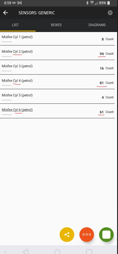

I got this report the first time - didn't know it was there until checking the files on my phone. I opened the OBDLink app for a minute to look at it, then closed it down and it had gathered this and more in that time -
Jeep Gladiator Survey- For those with misfire issues 1658756590433
And this one didn't ding, didn't request the light, and no codes anywhere - a span of about 2-3 minutes, likely closer to 2, at idle speed. Do the math - did it even fire once? It felt like I pulled a plug wire off my 4.0.
Actually, no, I could remove a plug wire on an older engine and it wouldn't buck as bad as my truck did while I recorded this. It wasn't just a "misfire" it was like for that one cylinder it was kicking back, not just simply "not firing and pulling it's load".
