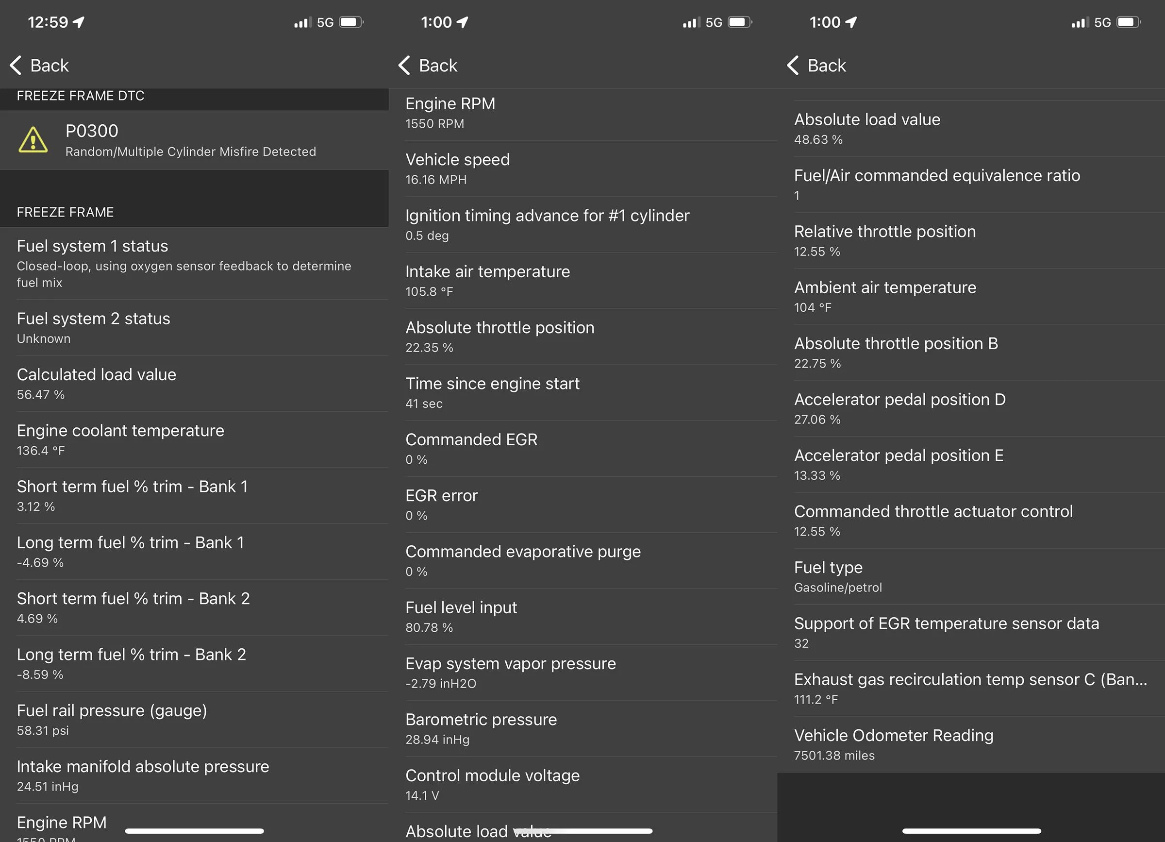

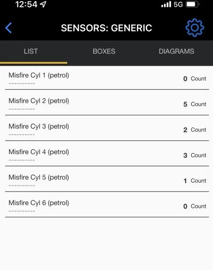

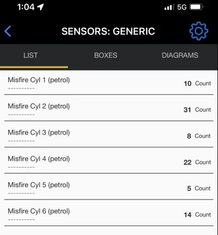

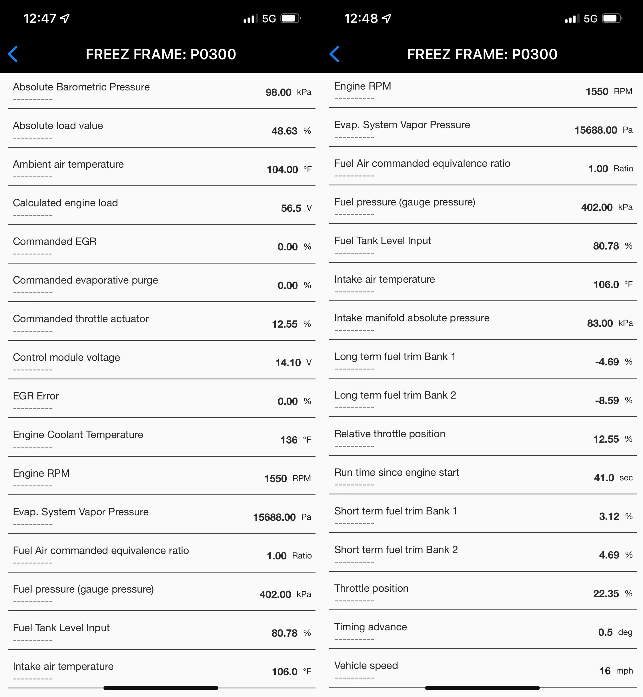

After having the cylinder 4 misfire code cleared and the PCM updated on my 2022 3.6 Rubicon over a month and 1,100 miles ago, the CEL came back on today. It shows code P0300 for random multiple cylinder misfires. I am taking it in next Wednesday to let the dealer see if they can find anything and hopefully come up with a solution. This happened during the 2 mile drive this afternoon between the house and office. CEL was flashing at first while driving around 10 mph but after about 30 seconds just stayed on. What seems strange to me is that when I pulled up to a stop sign the engine shut off like I’d hit the start button. After shifting to park and hitting the button it fired right back up with the CEL on but I had no trouble getting the last mile to work. At the time the light came on I was monitoring for misfires with Jscan but it had only shown 11 total across 4 cylinders which is unusual because there are usually at least 30 during the first few minutes of driving. Attached is a screenshot of the misfires and freeze frames from both Jscan and OBDlink. I did not ever feel or hear anything at all unusual from the engine. Had the light not come on or the engine shut off at the stop sign, I would not have noticed anything unusual.
Wasn't even close to warmed up - basically still a cold engine.
Interesting to note that your higher misfires (although low) are the same cylinders mine were - 2, then 4 and 6 had a few more than the odd numbered cylinders. But 2 was always the most, followed by 4.
When the light came on after lunch, it had sat in the driveway for almost half an hour after driving 2 miles home from work. Before that it had been parked at the office for around 4 hours. I have noticed considerably fewer to 0 misfires when I can let the engine warm up for several minutes before driving. The vast majority happen within the first couple of minutes after it is put into drive if it hasn’t idled very long. Problem is that I have half an hour for lunch and if I'm busy I don't always let it warm up long enough. After the service department looks it over next week, I will do my best to let it run longer before driving.
When I first started monitoring misfires in July, it was always cylinder 4 with the higher count followed by 2 then 6. The past couple of weeks though it has been a tossup each time I drive if 2 or 4 will have the most with cylinder 2 having slightly more overall. Attached is the screenshot of the 2 mile drive home after work. Before I left, I let it warm up for 5 minutes before pulling out the gate. All but 3 of these misfires happened within the first 30 seconds after putting it in gear.

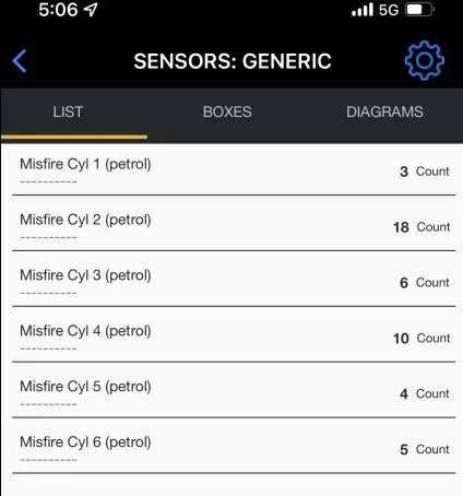

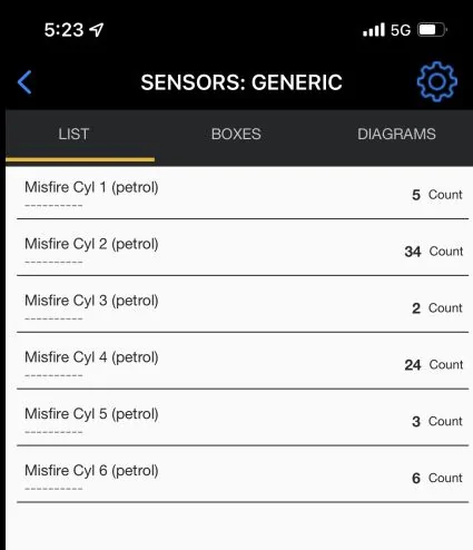

Jeep Gladiator Survey- For those with misfire issues 8-31-22-jpg
That shot looks like mine did a month or so ago. #2 followed by #4 and 6 trailing behind but still more than 1, 3 or 5 which had 0 most of the time.
With the short drives - the batteries will never be fully charged. Unless you take it on some long long drives, you're going to need to put a battery tender on it. 2 miles is extremely hard on vehicles and won't keep batteries up. In fact, even just 10-15 minute drives is very hard on them and won't keep batteries up - even back in the 70s it was never enough to keep batteries up or let engines warm up.
The engine needs to reach operating temperature and then be driven for another 20 minutes to properly purge out moisture and acids. It often takes 8 - 10 miles for mine to get all things to operating temperature.
My driving distance may very well be part of the problem. I am averaging about 1000 miles a month but most of my daily driving is 5 miles or less at a time. Four to six times each week I go to town and depending on what I do those drives are 35 to 45 miles round trip. Every time I’ve monitored the drive home, there are 0 or very, very few misfires. Once it gets up to temperature it is fine but there are always several after a cold start. Would using an engine block heater help?
