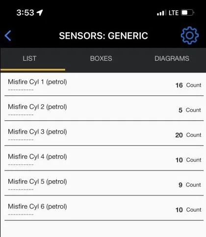

The 22 overland I’m working on is identical. Happened once and. While shut down when it did. Misfired like crazy when monitored on start up but not physically noticeable. I decided to make a Star case because it seemed dumb to hand over a vehicle that literally shit off and say “wait for engineering to figure it out”. They had as take 2 flight recordings with LOADS of data compared to a normal flight recording of me acclerating form 0-35 for 60 seconds. Seems like they have an isolated idea but no repair. This one’s missing on all 6 cylinders so the normal single cam and O2 sensors issues aren’t the culprit here. Customer and dealer both liked my idea of having me drive it for a couple days, truck has been perfect for 3 days now, so they are going to take it back while we wait for a reply from engineering and hope it at least sticks to no issues or only a light in a the mean time
Below is a screenshot of monitoring I did yesterday with Jscan. This is from a 20 minute, 10 mile drive. All but 5 of the misfires happened within the first two minutes after putting it in gear. The Jeep had not been started for at least two hours and I let it idle for 45 seconds or so before putting it in gear.
When this started two months ago, the engine sounded fine while idling but for the last month there is a slight engine tick that I could hear when standing beside the Jeep while it is idling. The ticking is not loud enough that I could hear it while driving with the doors and top on. Before I went anywhere yesterday, I took the doors and top off to see if I could hear it and I can hear while driving. I am not a mechanic and the best way I can describe it is that it sounds to me like a Monte Carlo I had back in the 80s with a 305. I had to add a little oil every few fill ups and this sounds a lot like that did when it started getting low on oil. While the Jeep was in the shop last week I had them do the second oil change at 7,700 miles. I checked it yesterday and the oil was right where it should be on the dipstick and looks good. After the ticking started last month, I had Blackstone do an oil analysis. I will try to attach it to this post along with the screen grab of misfires but going by the report everything looks good to me.

P
