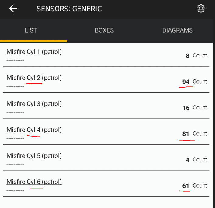

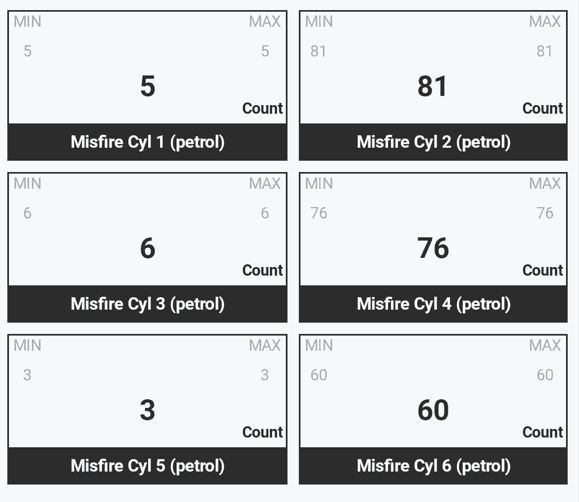

Mine developed a pattern - and that's what you want to look for cold or hot or warm.
Patterns - I guess that's where the psychiatrist says I excel - pattern recognition and puzzle solving. It's helped me in life - but just can't be explained or learned.
Anyway, mine did the very few on the odd side - the passenger/right side, but there was a definite pattern. It was the left side every time, and it only happened after it was thoroughly warmed up and stopped for 20-30-45 minutes (20 was the shortest, 45 was the longest), then restarted again.
This is one reason I like the "boxes" on jscan - if you choose certain things in the right order, the pattern is very obvious.
2, 4, 6 - driver side cylinders.

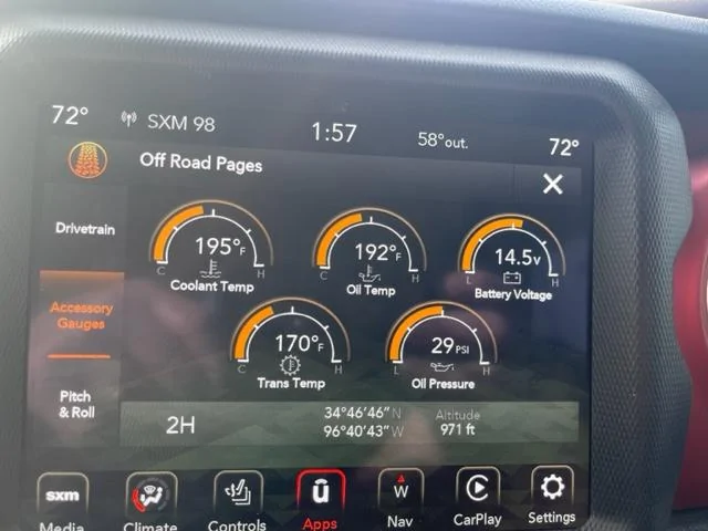

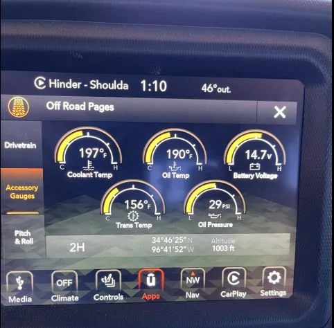

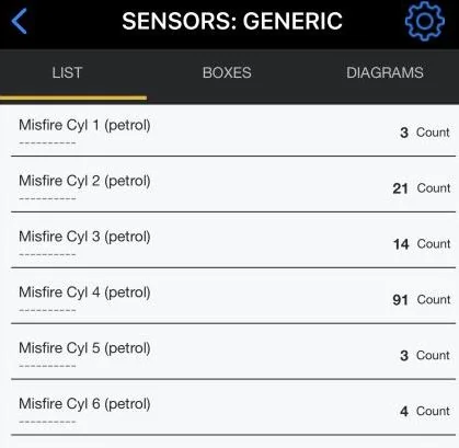

Not having much to do at home today I put around 100 highway miles on the Gladiator. After starting it for the first time I pulled out of the driveway and had the misfires shown in the first screenshot within the first two miles. After that none of the numbers went up more than a couple per cylinder. About 30 minutes later I pulled into a car wash and spent about 20 minutes cleaning out the jeep. When I reconnected Jscan and pulled back out on the road it showed 0 misfires for the entire trip home. I sat here and watched a 30 minute show tv and left again getting the second screenshot within the first 5 miles then only a couple more after that for the next 20 minutes. I spent about 30 minutes in a restaurant then got 0 again on the drive home. No sign of the misfires I got a couple days ago after driving 30 miles then sitting for about half an hour.
From what I read in the posts about yours, it sounds like they were very random. Tomorrow morning I’ll call my service department and ask about forcing the cam/crank difference relearn and see what they can find. Other than that, my plan is to keep monitoring and see if they happen after it sits for a while again.
Yes.
Very.
It happened at 56 miles, then it didn't happen again for a couple of weeks or so. That was in July.
Then it was perfect until mid-September and it happened twice in 2 days - then not again.
So there were many drives between - many weeks between, heck, even over a month in between incidents. I kept my bluetooth adapter connected and my phone set up almost every drive trying to catch it in the act. About the time I gave up and put things away - it happened again.
Smooth as silk most of the time - 99% of the time, really. And two times it wasn't even rough feeling - it set the CEL and jscan showed misfires but I didn't feel them. One time the engine shook hard! I mean it was like running a 4 on 3 cylinders it was shaking badly. At that time my math figured that for the time it was doing that, based on the number of misfires, the RPM and the length of time - #2 didn't fire at all for all that time - at or close to 100% misfires.

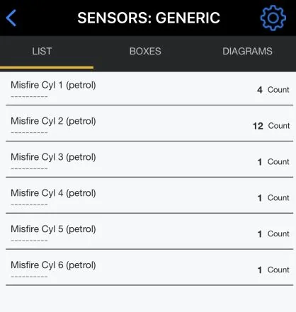

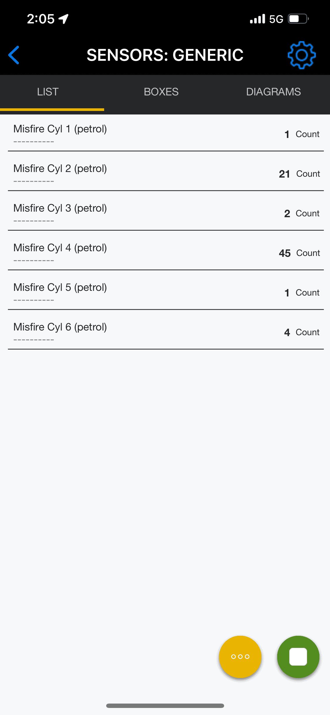

Since putting 100 very aggressive highway miles on it last Sunday and using Jscan to do a cam/crank relearn Monday evening, the misfires from a cold start have improved to the point of being almost nonexistent. I am getting between 0 to 20 across all cylinders now after it has been sitting for an hour or more. That’s good, I can live with that. The problem now is that it acts almost exactly like yours was. Three times this week I’ve used it to run errands for work and each time have driven approx. 50 miles. All three times it has had between 200 and 250 misfires after the initial 25 mile drive and having been shut off for 15 to 20 minutes while I was in a store. The attachments show the count and the temps from yesterday. Yesterday was the first time I’ve felt them and it happened within the first couple of minutes after pulling out of the parking lot. It shuddered for maybe 15 seconds and the MIL came on and flashed a few times then went off and it ran smoothly for the rest of the drive. Before shutting it off, Jscan indicated the P0300 code but once it was turned and sat for a couple of hours, the code no longer shows up.
I am waiting for a callback from my service department with the hope of getting it in between Christmas and the New Year but I am definitely to the point of letting them keep it for a few days to try to sort out. When I used Jscan to do the cam crank relearn, it was immediate and the engine RPMs did not change. From what I have read, when it is done by a dealership, it takes a couple of minutes, and the RPMs will increase during the reset. When they did your relearn, were you able to watch it being done?
No, they told me about it later when I asked how they got it resolved so quickly (I expect them to have it until the next day)
